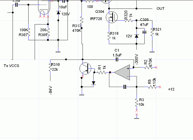

While soldering changed schematics significantly.
Now pentodes are loaded on CCSs with servos, G2 voltage for them taken from 150V gas discharge lamp through a source follower (one more gas discharge lamp in series gives 105 more, so plate voltage for preamps and drivers is +250V now -- more than enough).
