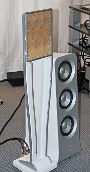

Flexurally (more or less) rigid flat panels
TERRA-SP3000 of Teragaki-Labo?????????????????TERRA???????????
Welcome to GÖBEL - Revolutionary Bending Wave Technology
NXT Sound - Home
http://futuremusic.com/blog/2007/12...ases-podium-1-flat-panel-audiophile-speakers/

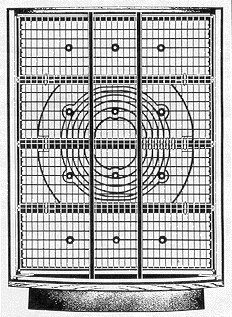

- 1924 (about) "Ibach Tonspiegel", "Sound Mirror" named Transducer from the german piano manufacturer Ibach.
This device also has been patented.
Tonspiegel Radio Ibach, Berlin W
Not to mention the traditional knowledge of instrument makers,
which can at least partially be applied to bending wave
lousdpeakers. The "Tonspiegel" is an early example for that
kind of knowledge transfer.

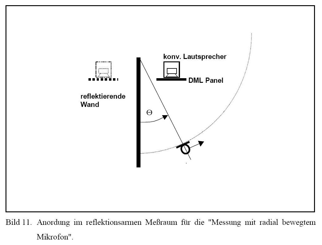

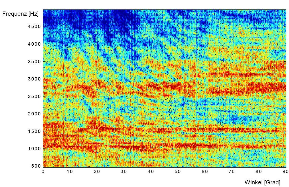

The pictures show a comparison in interaction
of direct and reflected sound between a panel type
bending wave loudspeaker and a conventional 2-way loudspeaker.
Both speakers were positioned about 50cm from a wall.
A moving microphone like shown in figure 11 was used
for measurement of sound pressure as a function of angle.
2-way loudspeaker: 10cm cone bass-midrange unit and 19mm dome tweeter
Panel loudspeaker: 58cm x 66cm, carbon cover on aluminium honeycomb core
The main radiation axis of both speakers was parallel to the wall.
Signal used was white noise.
x-axis shows angle between microphone and the wall
y-axis shows frequency
color shows sound pressure level
The strong interference of direct and reflected sound field caused by the
conventional speaker is visible in figure 12 by angle dependent dark cues
in the sonagram.
The panel type bending wave loudspeaker in figure 13 shows less comb filtering,
which is due to far lower correlation between direct and reflected sound.

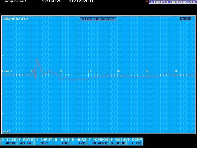

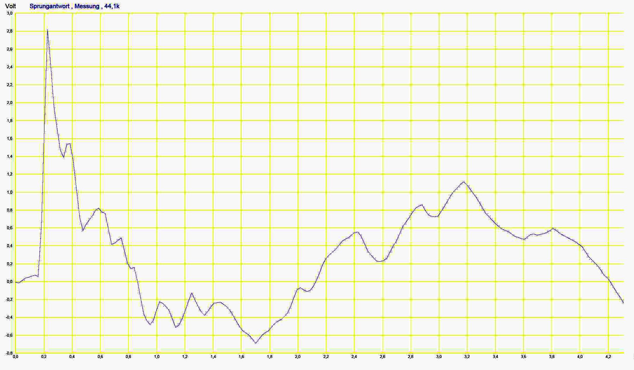

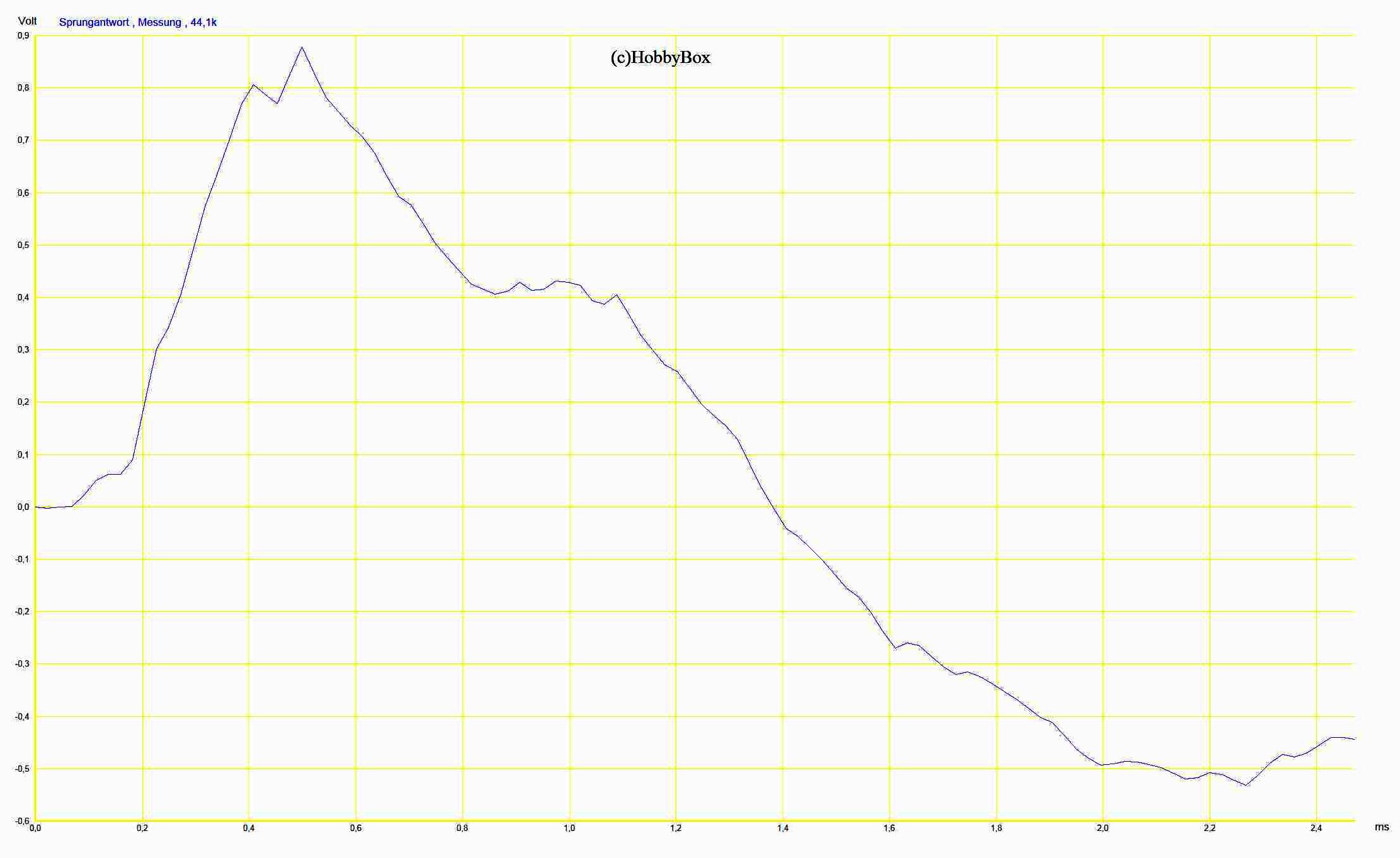

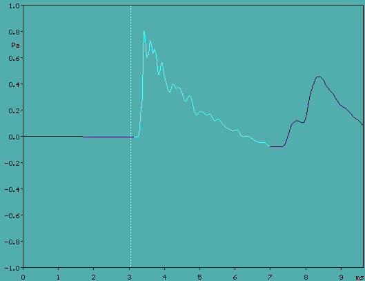

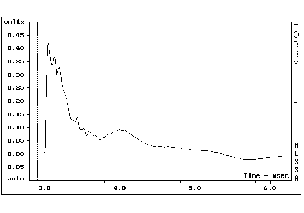

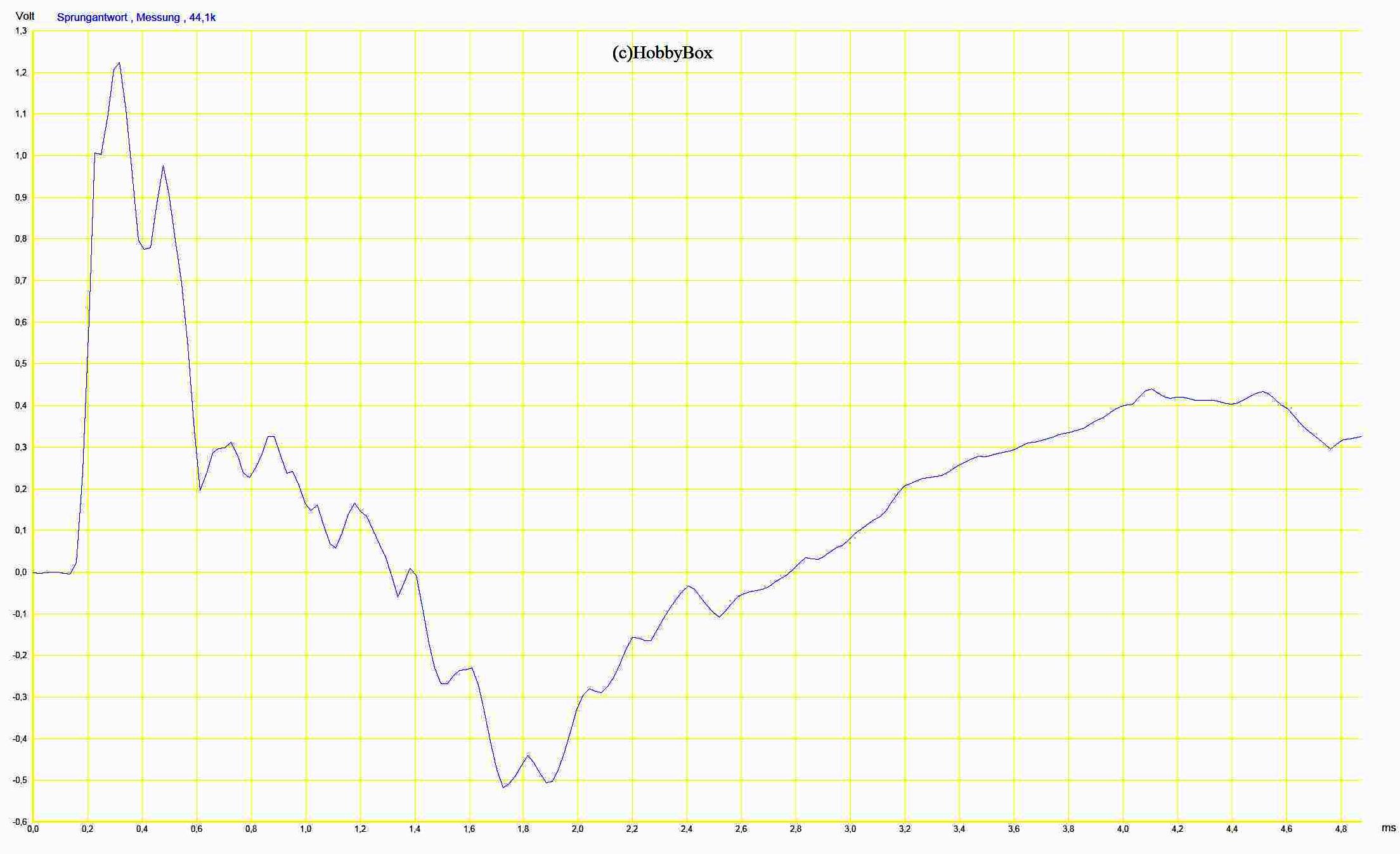

Example step responses from own earlier prototypes.
Not directly comparable to each other due to varying conditions.
Interview with Paul Paddock, developer of the "Airfoil"
loudspeaker ...
Stereophile: Impact Airfoil 5.2 loudspeaker system
loudspeaker ...

This following speaker company is interesting, but they are very short on illustrating the actual audio transducer, so I guess it's just Voodoo and Magic at work.
Video: Göbel bending wave loudspeakers
YouTube - Göbel bending wave loudspeakers
Homepage:
Göbel Audio mit Detaille Biegewellen-Lautsprecher | HiFi Heimkino News
http://www.moxtone.com/2010 High End Show Munich.htm
