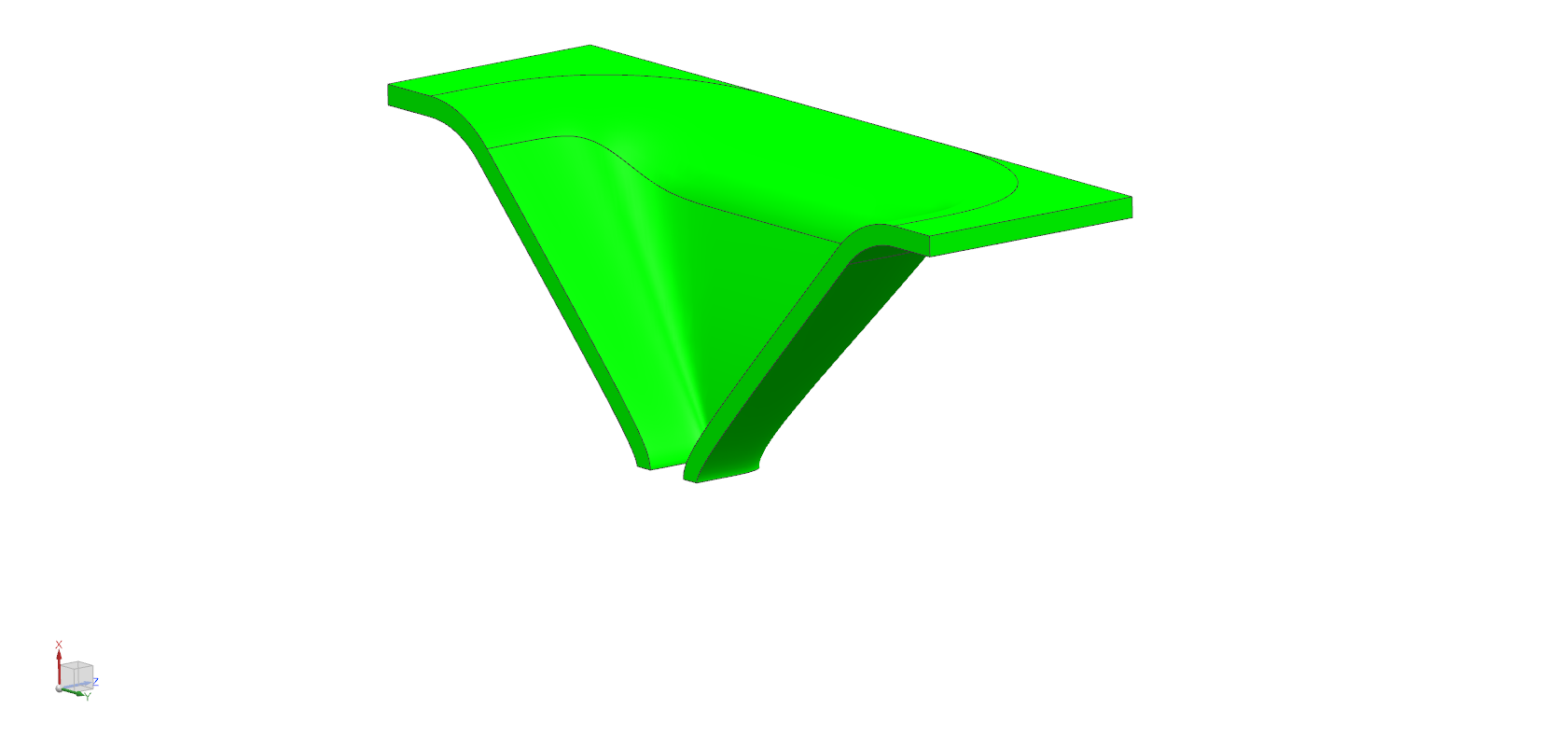

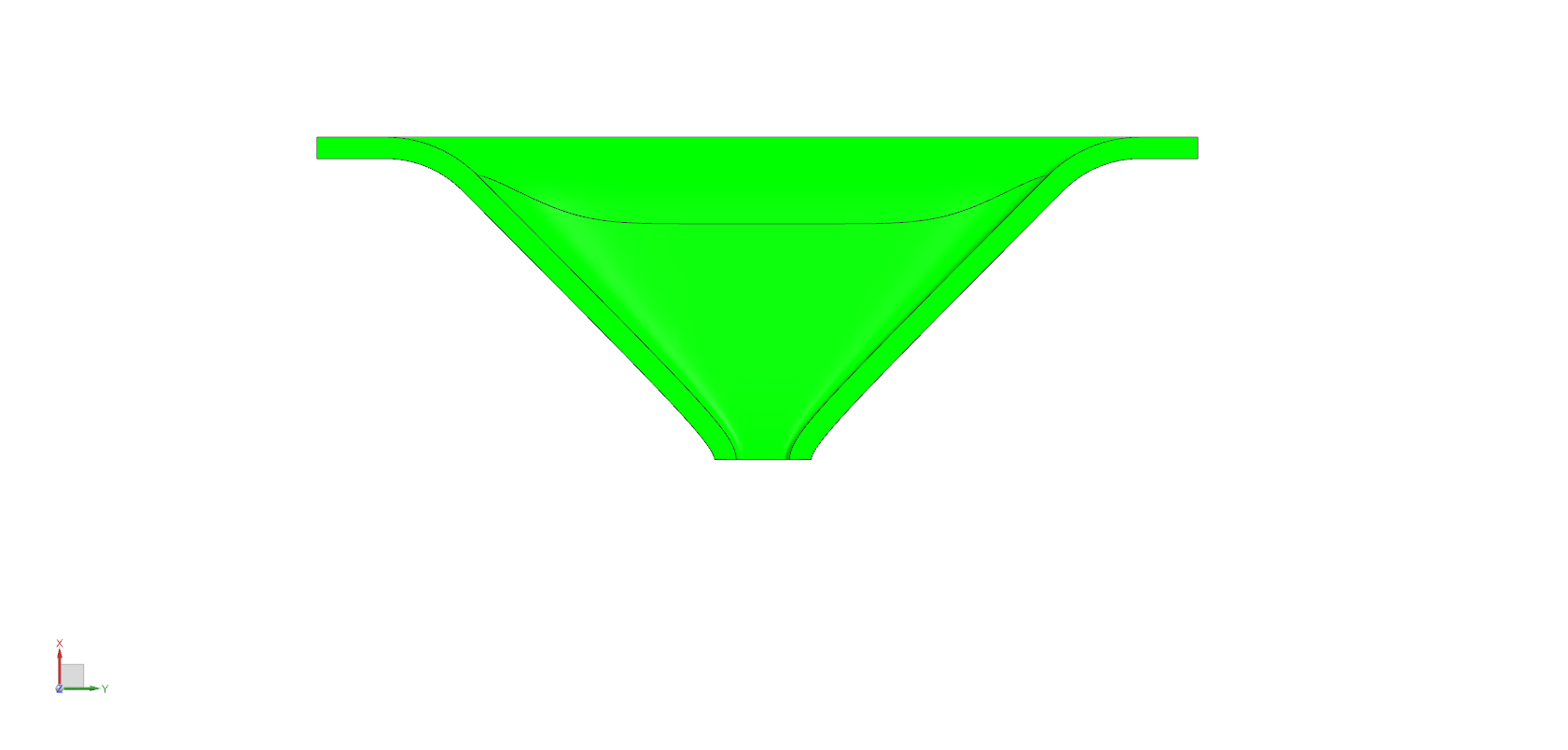

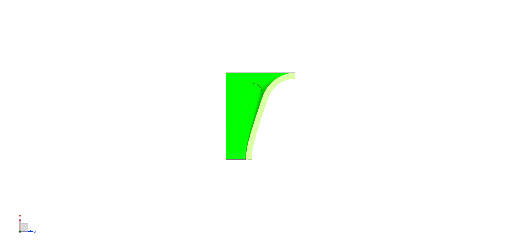

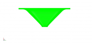

I took some inspiration from “mabat” notes for Ath4 on the use of superellipses. You can make a rectangular profile with an ellipse so I thought I would just transition from an N=10 to an N=5 superellipse between the throat and mouth. So here is my first attempt, for a 90 deg horizontal 40 deg vertical wave guide using Geddes OS profile. It’s 600mm wide. As I don’t have the mathematical skill to put the radius on the profile, I have done it in CAD with a 100mm radius.

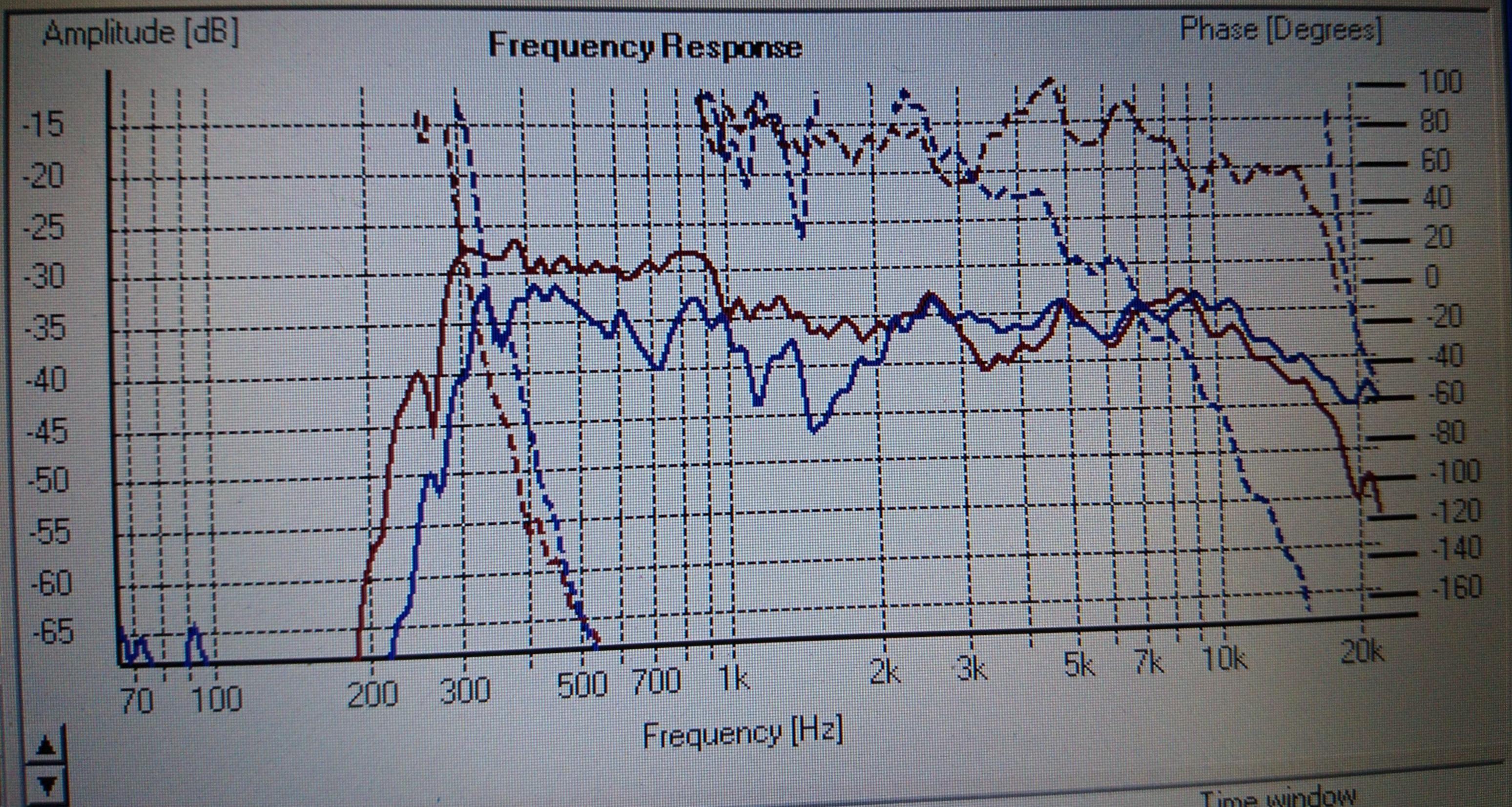

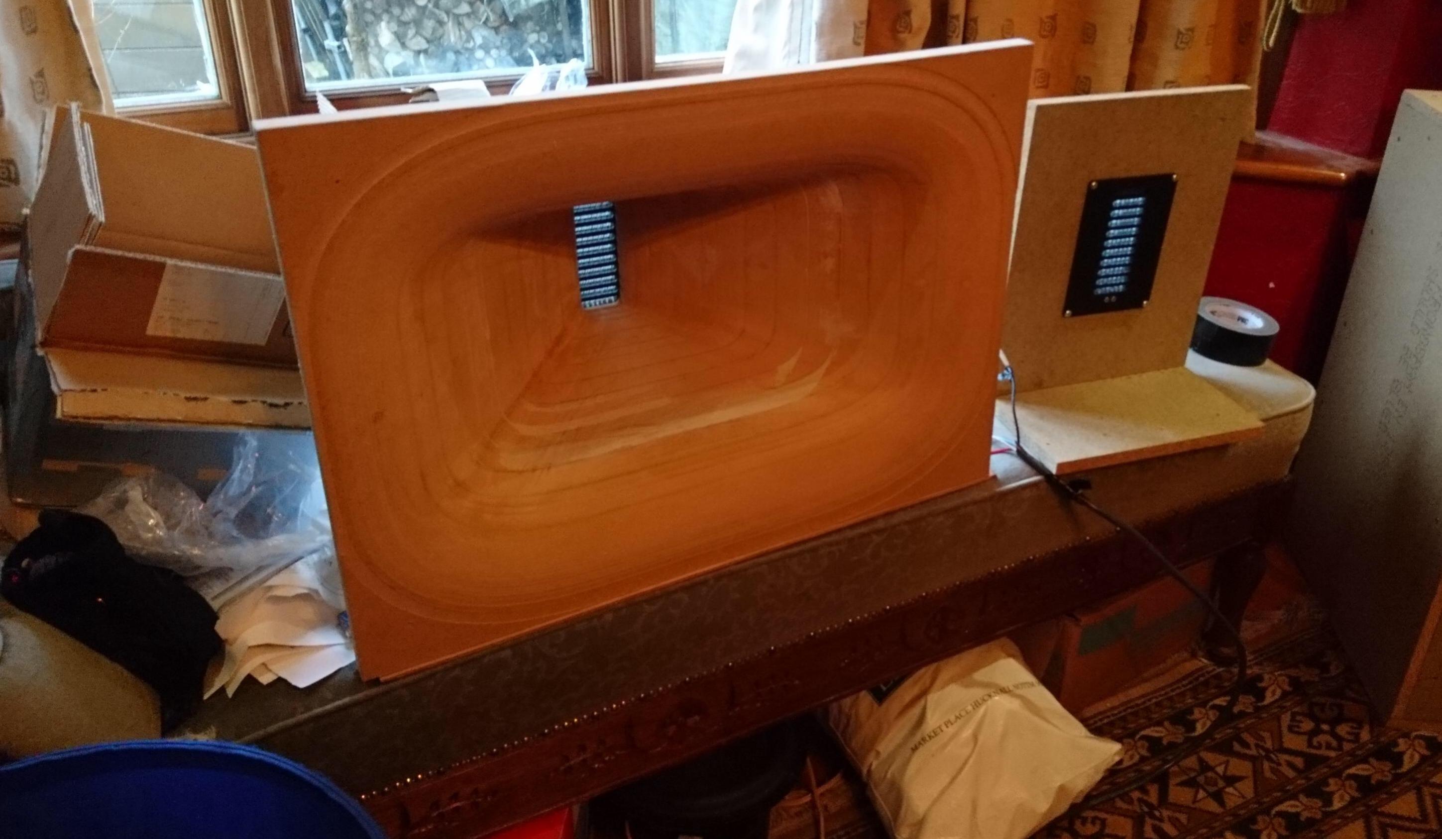

Finally finished making a “ test” horn. Carried out some measurements today too. Not a lot of horn loading, but wasn’t expecting this as the driver is an open back. The major difference is the off axis response where the response is almost the same upto 8k for 0 deg 30 deg s and 45 deg s. Needs some equalisation in the DSP, to level off the response. Positive outcome, need to integrate the driver into my set up to understand if this could replace the jbl2482’s for midrange duties.
