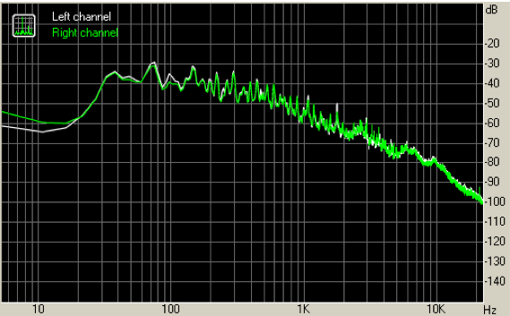

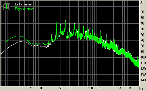

Hip-Hop is pretty bass heavy. Not like dubstep, tho.
Compare below the track "The Wall" (left) with "Kill You" by Eminem (right)
This gives you a good idea of the tonal balance. Floyd goes lower, but is not as pumped up in the bass.
My greatest appologies, for some reason I was thinking about Dark side of the Moon when I said the wall. In any event, I agree with what you're saying. I'd be interested to see...or even participate in what it takes to gather this information.

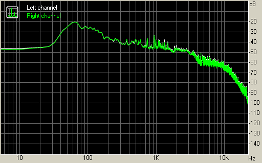

I've got about 70,000 tracks in my music collection. For reference, the track I was thinking of in my original comment was "Speak to Me" from Pink Floyd's Dark side of the Moon, which has a pretty viceral heartbeat sound..which I find very, very fun to play extremely loud.

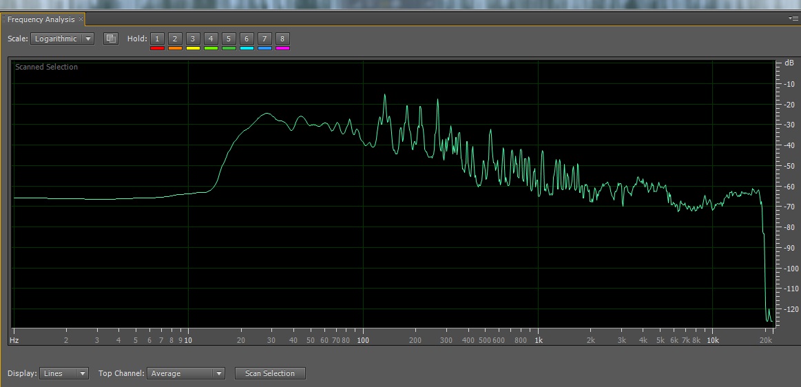

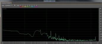

Cool, thanks. FWIW, the equal energy point of "Brick in the Wall" is about 300 Hz and the rap track maybe 280 Hz. An octave or more below that of pink noise. Unless I measured wrong.

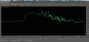

Right. Equal energy aside though, we should be wary of tracks that seem benign, but at some point become absolutely brutal.
Case in point, BT's Go(d)t. It's a 10 minute track, but if you look at the last few minutes of it, he changes the bass drum thump so that it's absolutely outrageous.
If you were to look at the track in "average" format it would look like a fairly standard EDM track, however the latter half of it will pop woofers out of their coil gaps if not handled with care.
