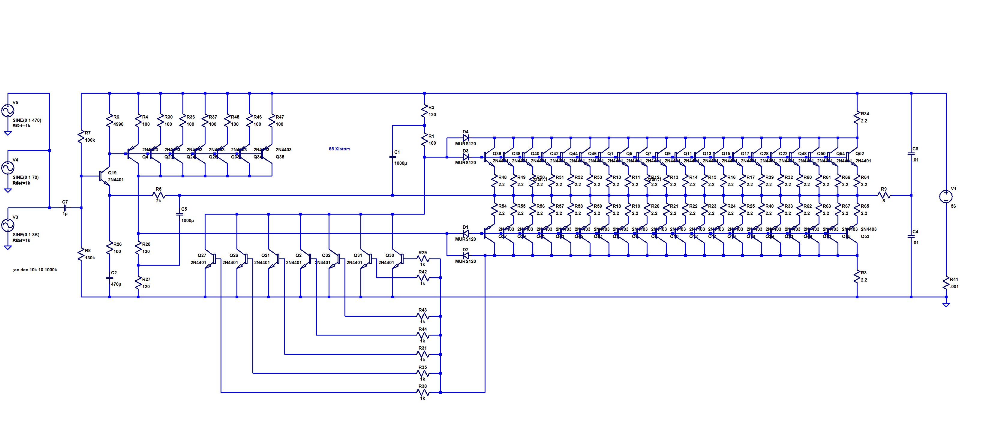

Having a penchant for evolving tube circuits into silicon emulations of the same tends to make the signal path all majority carrier type devices,(N). So just to show that there is no prejudice here against minority carrier devices, (P), here is another watt sucking fireball amp made of 5 cent transistors and capable of >30watts. There is also the need to heatsink the face of every TO-92 to an aluminum plate which makes the mechanical layout interesting at best. The circuit is a self biased transistor array follower, modified to include gain by ratioing some negative feedback. Pretty clean and definitely cheap to build. The .01 caps are .01F or 10,000uF 35V each.

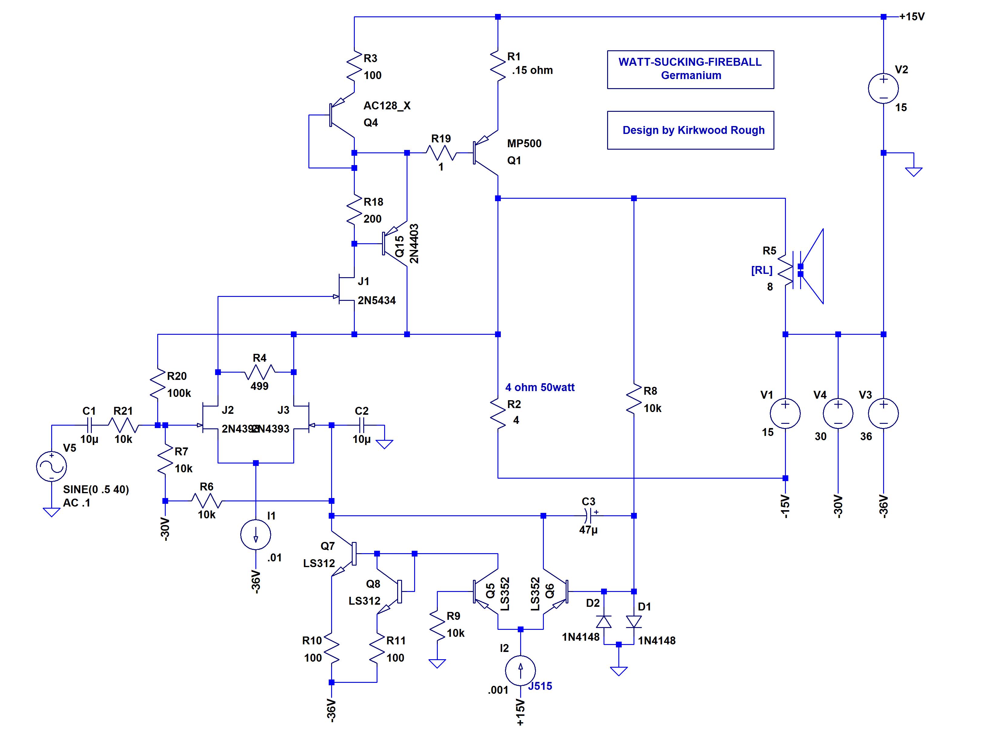

Yet another WSF or the Fun of it
This version of the WSF is the modern variation of the original design done 40 years ago in my parent's basement where a great deal of lernin' happened. This amp uses a MP5100 50 amp germanium transistor in series with a 4 ohm resistor as the collector load. 3.75 amps is the quiescent current for this output stage. The original had a finessed centering bias and a 5000uF coupling cap to the speaker, but still with the same results. I added the DC servo stuff on the later version because the feet just wont stay still. Though not terribly efficient, it has a remarkably clear response through the full spectrum. The drive is curiously booted to the output for bandwidth.
K-wood
Semantics?
Majority and minority carriers can be either N or P. JFET's are always majority carrier devices be they N or P channel.
Not to be pedantic about it, that was a slight of hand comment for color but even the device designers will often call out in term, this: "A device in which the current is conducted by the charges dominant in the lattice is called a majority carrier device (e.g., electrons in n-type material, or holes in p-type material if the current is conducted by charges not dominant in the lattice, the resulting device is called a minority carrier device " (IRC) Though this is most often used in the description of channel devices like FET's, where current flow is conducted through a single type of semiconducting material and not passing through any junctions, the slight of hand was extending this to include "bipolar" junction devices for polarity sake. In the case of initial implied reference to WSF No.4, the entire signal path is N-channel devices and might be said, tongue in cheek, to be a majority carrier amplifier. Die sizes for "complimentary" devices are a good illustration of the difference. The P channel die compliment to it's N equivalent will be three times as large for the same doping regime to have "complimentary" characteristics. There will always be finessed parameters involving doping concentration and area to make the conductivity, capacitance and depletion efficiency match up, so areas can vary from 1.5 to 3 times in ratio when trade-offs are managed. Always will be the argument that there is no such thing as a truly complimentary device structure, and it's a good argument to engage when a Speyside single malt scotch is employed to refine the details therein, but a forum on this subject would turn into a full time job, and I have one of those. So thank you for the correction, I'll try to restrain my loose cannon for a more outrageous subject later.

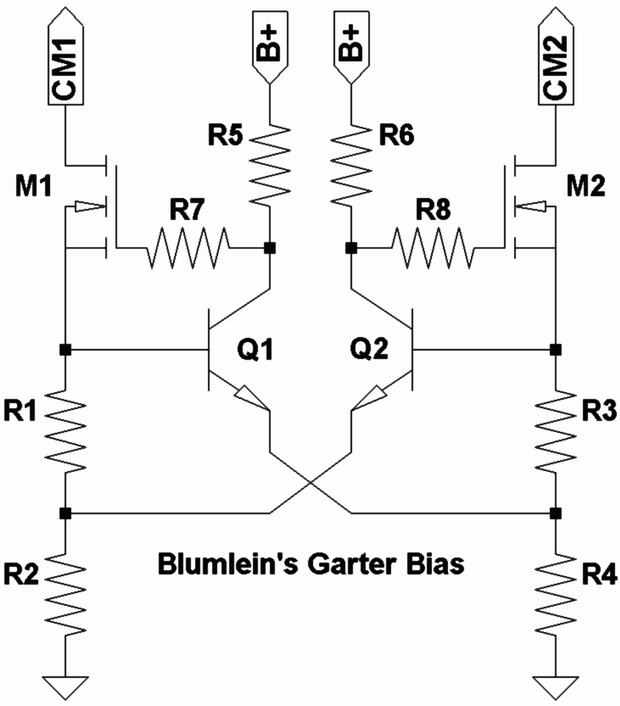

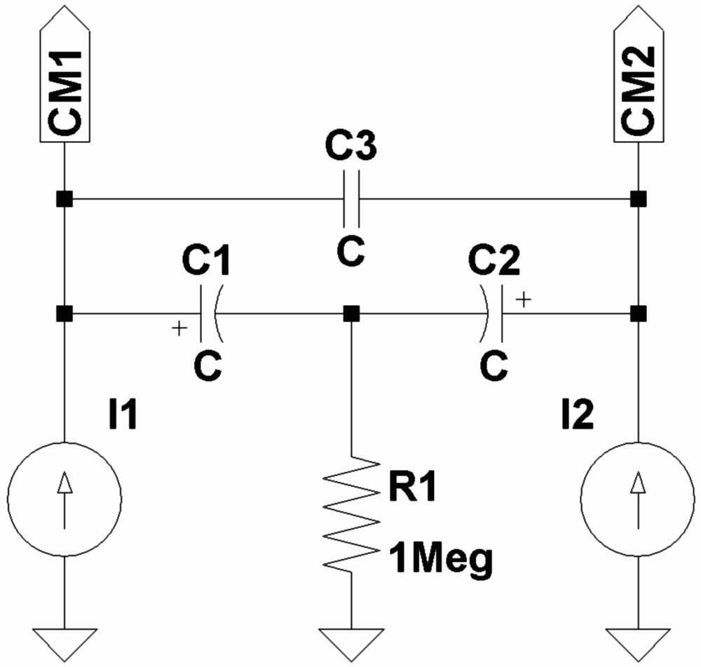

Not sure the purpose of your resistors in series with the
caps that bridge your split tail pairs in the 1st schematic?
I assume the intent was folding a cascode both ways to
make a theoretically perfect differential?
See you like the Wilson Mirror! Ever tried Blumlein's Garter
in that application? This was kinda my thought process how
to autobias a pair of tubes accurately enough for a toroid
OPT... I don't know how well it'd work under a JFET input
circuit like yours.
Drawing #1 is the pair of CCS shown in Drawing #2.

Thoughts on differentials
The story behind this design was pure inspired motivation. When someone suggested in late Sept. that I should look at this thing called a Burning Amp Festival, I decided to suggest building an amp, using all Linear Systems parts to demonstrate how good they sound in the linear gain chain of an ultra linear amp, to Paul Norton at Linear. So this amp became a reality from a clean piece of paper and a promise, to demo in 3 1/2 weeks. It started working at a demo level at 6AM of the show day. There were a number of choices that had to be made with no turning back because there was no time to make a change if something went wrong with some new idea. This design used a number of tried and true concepts from past designs, though never tried together. the input differential needed to have the lowest noise pair of current sources musterable. Matching of the LIS dual bipolars allows me to make the Wilson based dual source with fractional percent accuracy without thinking and with only 2 parts aside from the low noise current feeder made from a selected LSK170. Early in this series I said I didn't include any cross coupled anything like a Barrie Gilbert type preamp, (another long discussion) Because I wanted to keep the illustration of circuit concepts as simple as possible. The split resistor on the driver stage eliminates a resistive load imbalance that would come from the resistor biasing the source coupling caps. The 150 ohm total is there to be the degeneration/linearization of that stage, as all stages are controlled gain linear stages. The object in this design is to have the amp as linear as possible without feedback so the small amount of feedback employed will straighten but not interfere with transient IM performance. So, yes, theoretically perfect differential, but with the ability to independently steer the output bias condition without messing with the AC differential gain.

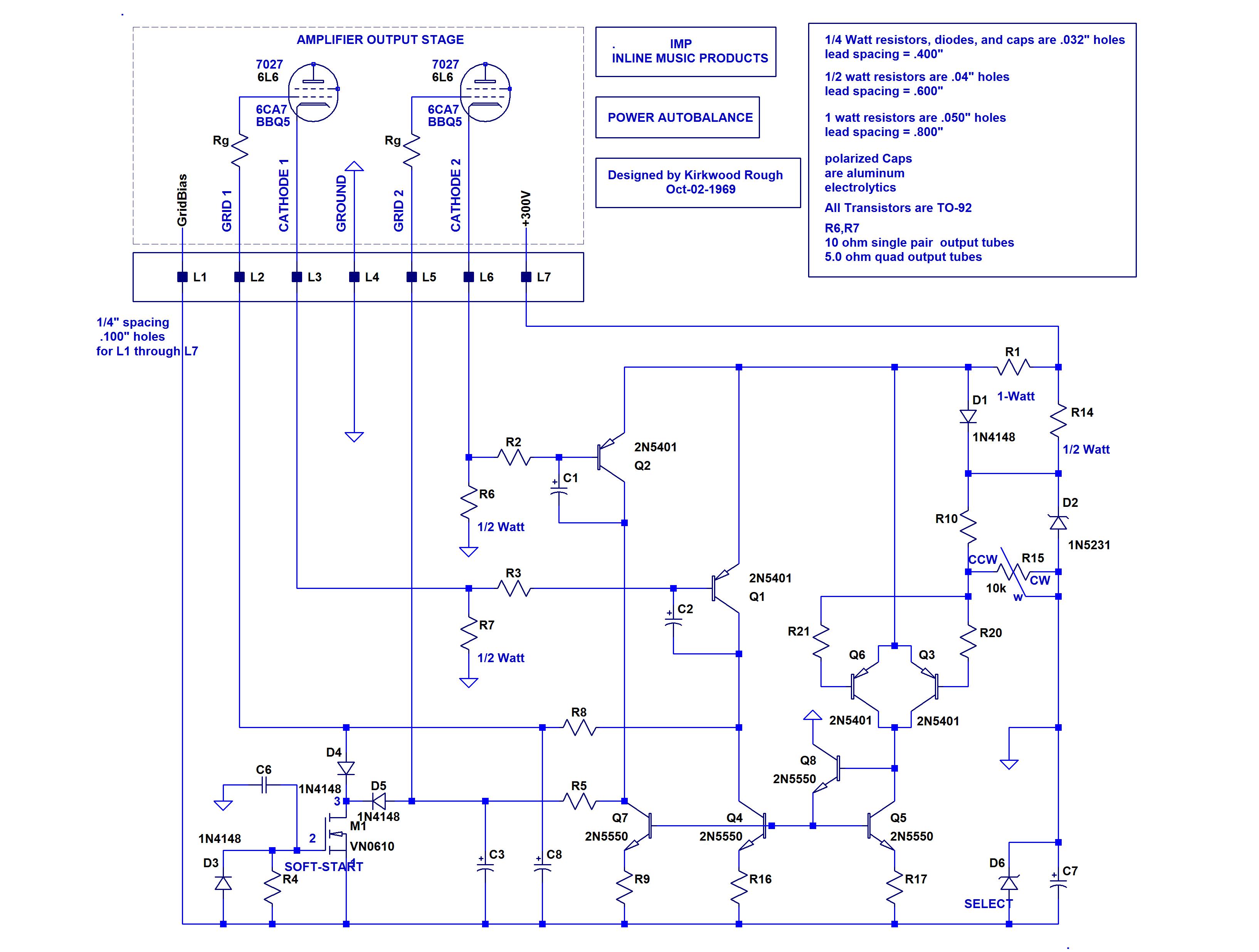

"See you like the Wilson Mirror! Ever tried Blumlein's Garter
circuit like yours."
Auto-biasing is an art that I developed in high school for putting Marshall Amp heads in line using a couple transistors in a differential balancing integrator for the grids. That way I could regulate the quiescent and use a mismatched Tungsol and a Sylvania, or whatever, without an imbalance in magnetizing current. That was how I financed an equipped basement amp shop in HS. I would do the same thing for a toroid output application, that is, to sense the cathode currents with as small a resistor pair as possible and use a differential integrator driving a pair of current sources to steer the grid bias into compliance. Most musicians in High School were as poor as church mice and getting matched tubes to achieve full output power from a Plexi-head was out of the question. Someday someone will find one of those old heads and wonder about that "hack" under the chassis. I have a PCB kit that I made for Guitar amp balancing that I used to sell. No more complicated than the one from 1969 but better.

Another thought
OPT.....
Transformer outputs are a wail of tradeoffs. If you want a Single ended drive the leakage reactance will be high so as to accommodate DC bias plus the differential swing about that point. In the P-P amp leakage reactance is managed depending on how much the tube quiescent current can be tolerated. Sloppier builds with more open window area in the core means the sloppier the tube balance can be. But little can be done with toroids accept balance, balance, balance. Low leakage, good coupling and high permeability tend to saturate toroid cores with little imbalance. It's a tight path to acoustic coupling efficiency as long as DC balances are corralled. There is a toroid tape winding technique available from Stangennes Industries in Palo Alto that spaces the permeable steel a bit with a dielectric coating. This provides some leakage in the core and makes a more forgiving toroid transformer. General Radio built a number of toroid transformers for audio, the 942-A comes to mind. it was used in the Gotham recording amplifiers some time back and driven with 811's I think. They used a winding technique called astatic winding which tended to reduce the imbalance issue by increasing some of the leakage and reducing distributed capacitance by this winding and isolated primaries. The isolated primaries were useful, allowing them to operate in parallel in a totem pole output stage developed by Donald Sinclair in 1952. This lowered the input impedance by 4 and effective distributed capacitance consequently upping the frequency range and uniformity of coupling coefficient to the speaker. The Sinclair P-P output stage is what I use almost exclusively in all the amps I do weather they are OTL or not. But then balance is always a good thing to do any way for other subtle influences in symmetry.

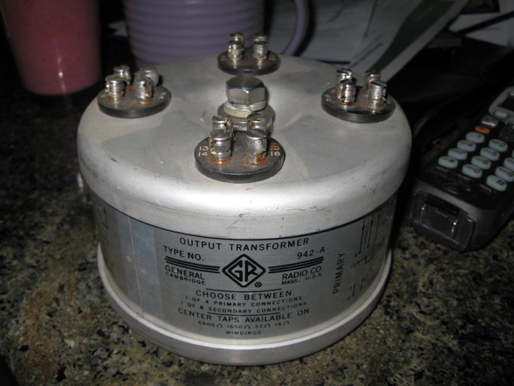

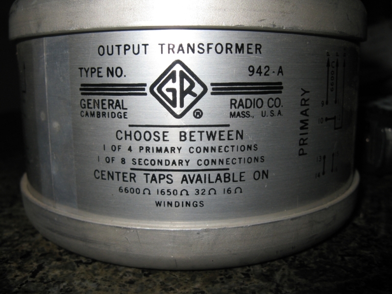

Just a bit more

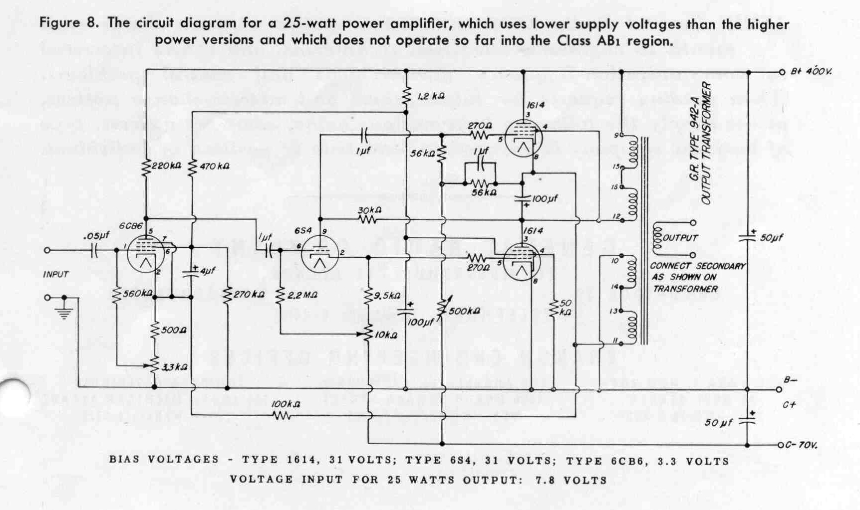

This is an example of a Sinclair-Peterson type push pull totem pole amplifier from the Oct. 1951 GR Experimenter publication. It puts both output tubes across the voltage rail to ground, cancels the magnetizing current as in a normal push pull and couples both primaries in parallel capacitively so the sending impedance is 1650 ohms instead of the usual 6600 ohm P-P. Of note is the fact that both output tubes are driven grid to cathode and the gain transfer function of both are identical as in the normal P-P configuration. Some stacked tube amps are driven so as to have the lower tube with transfer gain and the upper tube used as a unity gain follower with upper-lower drive correction through feedback. The Sinclair-Peterson architecture is a symetric drive impedance particularly when using triodes and requires little feedback.
