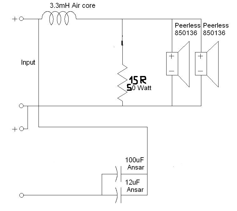

About the x-over you wrote:
"The Lowpass feeding the Woofers uses an Impedance Compensation. If the Dynaudio 21W-54 Woofers are employed, this Compensation is un-neccesary and should be omitted. It might be desirable to connect a high power resistor of 15 Ohm Value (> 50W) across the Woofers to slightly attenuate the woofers as well as reducing the Impedance swing at low frequencies"
X-over schematic will be as the pic?

I wrote that over a decade ago, so I guess it must be right if I wrote it... 😉
I guess so...

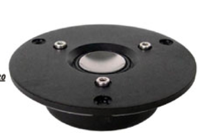

Look a like tangband inversedome titaniumtweeter.
http://www.tb-speaker.com/detail/1208_03/25-1372sc.htm
The focal one's
http://www.rumoh.nl/nl/313-focal
The focal one's
The focal one's
Focal - RumoH - Caps, coils and speakers
Wilson Audio uses the Focal TC120 TD5 not the Focal TC90 TD5B
Focal TC120 TD5 - RumoH - Caps, coils and speakers

I do not follow your schematic. There are two positive connection points, while one goes directly to negative point? The (large) capacitors are in parallel but before the crossover.About the x-over you wrote:
Anyone care to explain?
The Watt is a 2-Way speaker with a 6.5" Woofer and Focal Tweeter. It has it's own crossover.
What was shown is the crossover for the "Puppy" Woofer unit. This contains a high pass for the "Watt" and a lowpass for the Puppy's dual 8" Woofers. The feed for the "Watt" is inverted, otherwise there would be a major suck-out in the bass. It may be clearer if you read the original notes I published ages ago (and which still knock around the internet)...
Ciao T

I see...the 112 uF at the bottom is the positive output to the Watt.Hi,
Ciao T
The negative output, as the speaker is inverted...
Ciao T
