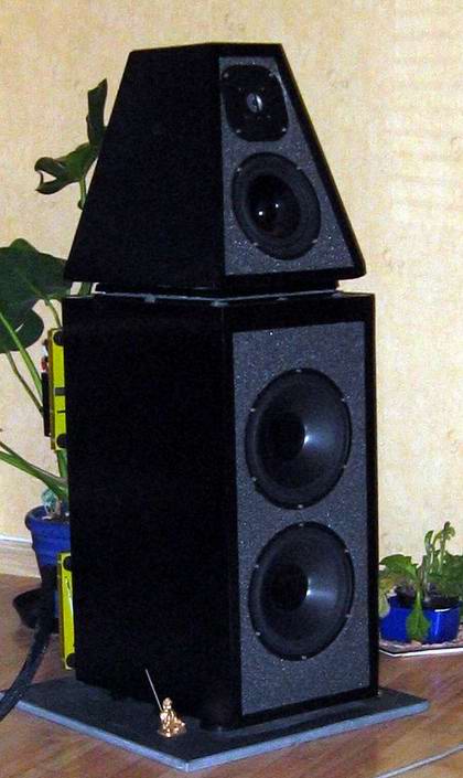

Cobra2 you have a different midrange compared to playazinc's scan-speak carbon 7". What midrange do you use Cobra2? Maybe this is why the Female jazz singers lose the magic, and it's not caused by the focal tweeter...

The Focals: TC 120 tdx2
Midrange: Seas h404
Bass: Peerless 850136
Arne K

need help...!
Since my "clones" are gathering dust, it would have been nice to modify them into something usefull...
As they now are with above mentioned drivers, and filter is a copy of this:
http://www.users.nac.net/markowitzgd/david/wap-x-o.gif and this:
http://www.users.nac.net/markowitzgd/david/watt-x-o.gif
-I have been told that the 0,33mH is too small in this setup.
OK, easily changed. But still don't like the midrange. So I need a totally different driver...but what is usable here?
And then, what mods should I do to the filter?
Or should I change the whole speaker into something similar to the "Poly Natalia" ? http://www.blackdahlia.com/polyarti.htm
Suggestions are most welcome...

Re: need help...!
don't understand 0.33mH is too small see :
http://www.users.nac.net/markowitzgd/david/wattcrossover.htm
A totally different driver is not really on.
Or the Poly Natalia - you can't get the drivers.
Best re-use would probably be as follows :
Rebuild the head unit with a 6.5"/1" design of your choice.
Bi-amplify with active bass/mid slopes to the bass unit.
Probably best to use active baffle step compensation for the
mid/treble head to increase headroom, but more complicated.
🙂 /sreten.
