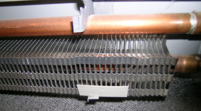

Hi Edwin-
I am actualy using baseboard pipe, which is 3/4" copper pipe with aluminum fins spaced about every 5mm (see pic). These are used for room heat, and are designed for convection. If you look at the pic, you will see that the sides of the fins are bent into one another, forming a chimney between each fin. They are about 5-6cm square. I plan on buying a 6' piece (or so) of this and cutting up to form a radiator about 18cm (3 rows) x 12cm (2 rows) x 30cm (about 1 ft).
BTW: In the pic, ignore the top pipe: it is a return pipe. I am refering to just the bottom pipe with the fins.

Clearly the baseboard pipe is best found scavanged at a reclycling store or fronm an old building- Maybe one could call a heating contractor. Leaving it in the housing might actually be attractive enough to have in your room e- possibly mounted as a baseboard.....IMHO the fun of this approach is scavanging stuff, but hightech is 😎 too
The baseboard pipe is effective in dissipating heat indeed, but i have to advise against your idea of stacking them on top of eachother.
Three rows next to eachother is a good idea, but dont put another three rows on top of that.
If you do so the efficiency of the total radiator will drop aproximately 30% due to the resistance between the fins.
It is better to make the radiator longer 18cm (3 rows) 1 row high and 60cm long.
This way you can get the maximum capacity out of the baseboard.
Another way of increasing efficiency is to build a case around the baseboard.
Normally the case around these baseboards are aproximately 20cm high.
If you make the height of the case 100cm or more you create a chimney which increases the capacity of the baseboard by two or more.
It is all about creating a weight difference between the cold and warm air just like natural circulation with watersystems.
The higher the chimney the higher the airflow.
Naturally things will ballance out once reached a certain point.
Maybe you can do without fans.
These systems will always work, no things to fail.
Give it a try with an eye on the thermometer.
If it doesnt work well enough you can install fans anyway.
Remember it takes a little water to cool 600Watt but it takes a lot of air to cool the same amount of heat.
End of story is the chimney must be big, but hey were talking about class A here.
Edwin.
Dont be put off by my post.
It is difficult to estimate the capacity of your radiator.
It it possible it will work verry well with a chimney of 20cm heigh.
It is even possible it will work as you first mentioned by mounting them on top of eachother, but you lose 30% this way.
If the dimentions of the case are a problem you could make a 20cm heigh case of cheap materials just for testing.
If the capacity isn't high enough you can make the case higher, or install fans (noise).
Maybe you can place the radiator in another room.

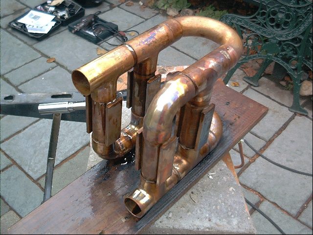

Hi all,
After the faillure of making a heatsink out of sheets and bars of copper i did make the change to watercooling.
This idea was born after a lot of reading on this forum especially the post from Grey who did this before.
I did make the heatsink from copper tubings with copper bars solderd on them just like Grey did.
The tubes are connected with copper fittings.
The heatsink is big becouse it is designed for natural circulation but i think i will be forced do ditch this idea (not enough space to house the tubes), and go for a pump driven system.

I mounted my copper bars edge-on to facilitate mounting the devices, but if you can tap those for the proper thread without puncturing the tubing you'll have better heat transfer due to more contact area.
Okay, you've got heat staining. Here's what I did: First, go to the hardware store and buy muriatic acid (aka dilute hydrochloric acid). Tell them you want the stuff they use to clean mortar off of bricks. That will take off the oxide and the red/blue stains. The downside is that it leaves the copper dull. The next step is to use 0000 steel wool to burnish the copper back to brightness. Depending on what sort of chemical copper cleaners you have access to, you might try them in place of either or both of these steps. Finally, when you get a nice, shiny glow on your copper, shoot it with a clear finish to keep it clean and untarnished. I used masking tape to keep the mounting surface from getting lacquer on it; I chose to accept a little dulling with age in that one area in order to increase heat transfer, although the thing is so effective I could probably have coated that surface as well.
I took a small, fine file and removed excess solder from the joints so that all you see is copper with a thin ring of silver where the solder is. It's purely cosmetic and labor intensive. You may not want to go to such lengths.
Keep an eye on the relative temperature of your four sets of devices. You've chosen a different layout than I did and you may find that you don't get equal water flow through each leg of the heat exchanger.
A word to the wise. I put my system together with clamps. It works, but it is a pain to disassemble and reassemble. The next time I break the system down, I'll probably install some sort of quick disconnect in order to make things easier. Something like car folks use to do their pressure lines--not garden hose, which will inevitably leak. If you do it now while your system is apart, you'll thank yourself later.
That said, it looks cool.
Grey

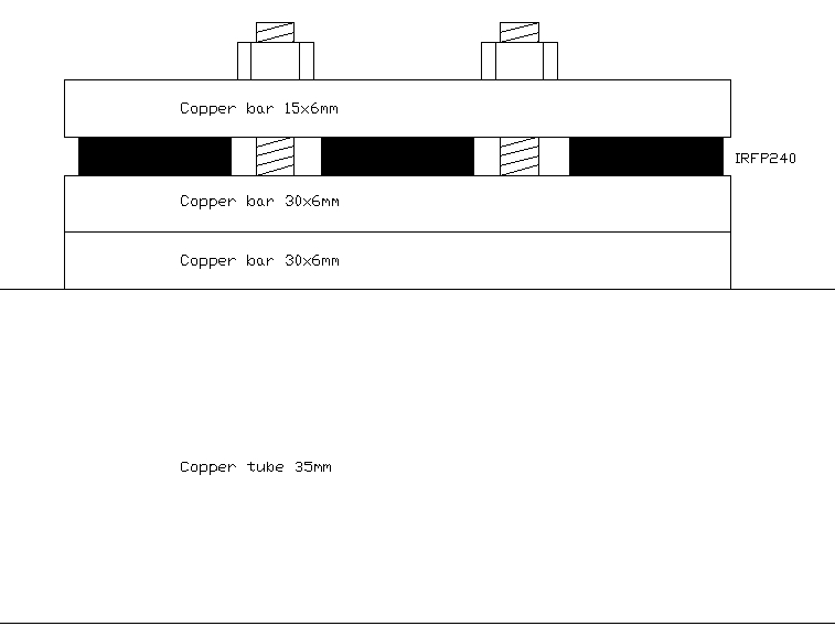

In order to mount the Fets, i will solder an copper bar on the already mounted bar.
This copper bar will have two thread rods on it so i can clamp the fets (see picture).
Furthermore the heatsink will be provided with a mountingplace for a thermal switch for overtemperature protection in case the natural circulation doesnt start or the pump fails.

About the equal water flow you could be right but ill have to try it in practice to see if it's a problem.
Edwin
