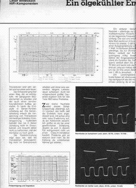

Hi Eva,
1980 one of my friends put this 80kg monster for "testing" to the german hifi-magazine HiFi-Exklusiv, they done some measurings, the thd was not so famous : At this time a had no meter😕
Btw, I think this was the last time for technical tests....other mags started only with hearing-"tests"
The article is german written, it is scanned, but for details the pics are too big to put it here.
