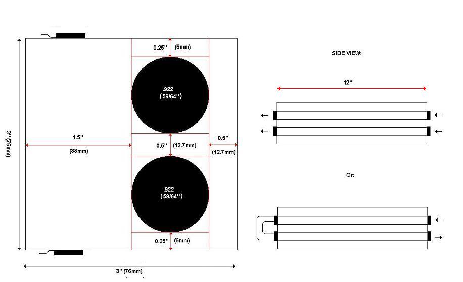

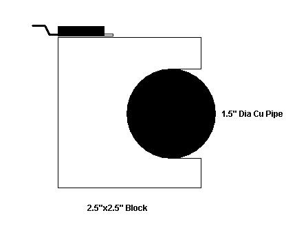

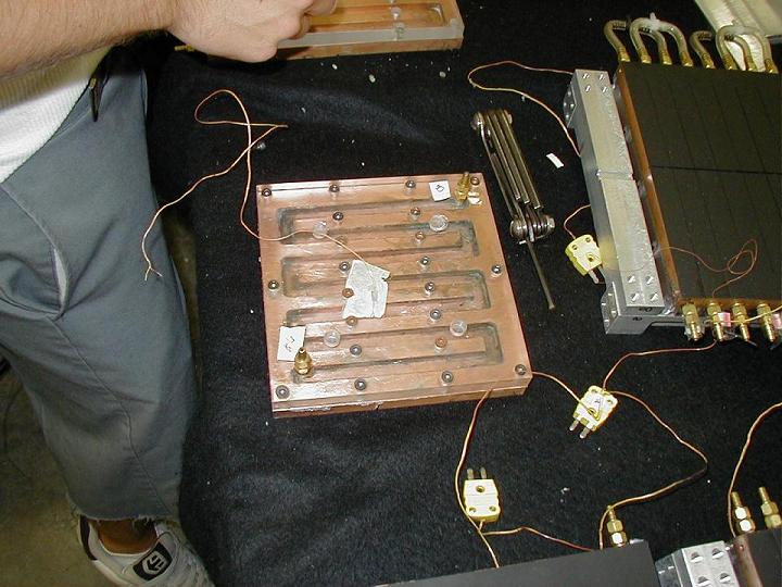

Haven't posted in a while, so I figured I'll post my progress on the water cooling block idea. I've attached two peltier devices, and they work remarkably well; haven't tested them with a load yet. The problem with these devices is even with one running at 5VDC it draws 6A, and at 10VDC about 11A, add the amp its cooling and now we're tripping breakers. I'll have to bring this contraption in the basement, wire the trafos up for 240VAC and let it rip. 8 degrees F at 5V, -5 degrees F at 10VDC.
I'm thinking a 5A Mini-Aleph @ 22V or possibly a very heavily biased F5.
These peltiers have a 545W rating, operate from 0-16 volts DC and 0-32 amps. The question I have, if anyone is familiar with these devices.....does the 545W rating mean that the device can handle 545W or does it mean that just by powering up the devices to full power, they consume 545W?
