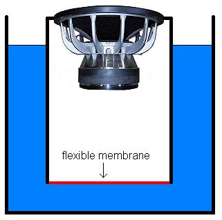

Here's the design I was thinking of last night with the flexible membrane at the bottom. For pure damping, just replace the flexible bottom for a solid piece. Either design should be easy enough to throw together in a coupe hours, using heavy gage trash bags or something for the membrane. Ok, now I'm gonna try to attach the pic...
Re: water damping
Yeah water wont amplify anything even if it pass well the lows...I like this dampening concept as water does block most of mechanical vibrations.
It is sure that if we keep this thread alive we could end up with funky stuff like water bandpass but there would be so much mesurement to do just to achieve a proper modeling process...even although we'd get the mesurment right, we would face compliance problems due to the fact that water is not compressible enough as someone said earlier. And where to find waterproof drivers...
If you chose to do some test with water, you'll see how it behaves under low fq...The spikes really seems to danse forming a sexy configuration over the surface and, if excited enough, it'll flikflak all over the place. It does not reinforce the bass at all and it worsen the mids... Funny isn't it
TDruan said:(at least by a significant/perceivable amount), but it would help in the dampenig of the enclosure vibrations, and that would be cool. Anyway, I've managed to inundate (ooh, a pun?) my brain with this water stuff, none of which I have any firm grasp on, and I'm gonna go to bed before I blow a gasket.
