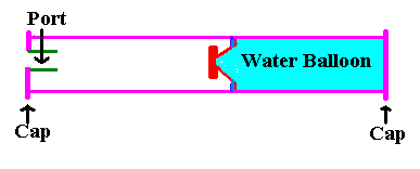

Third suggestion.
Buy a tube the speaker just fits in. If unavailable, buy a slighly gigger tube and cut a circle from wood that creates a tight seal. then cut an opeining in the cicle and mount your speaker to that.
Fill a balloon with water and make sure it is tightly sealed. Baloons are made from lates, I believe, and many glues stick to latex if you want to glue the balloon shut.
Then put that wooden piece on which you have mounted your speaker, stick it in the pipe until it makes full contact with the baloon, put the cap on the pipe which contains a hole with a tuned port, and there you go.

the problem with last pic is that water is too dense for it, we can get a standing wave in there but we neeed a tweeter...
Water is simply not compressible enough to build a sub like that !
A water-filled balloon that is only taking up a part of the space would have some effect thogh, depending upon placement. If it fits tightly into the tube's diameter and placed closely to the driver, it will increase the driver's moving mass. I do not see the advantage over attaching a solid weight to the driver however.
Because the balloon also represents a compliance it will show a resonant behaviour with a very low resonant frequency.
Maybe that would be usable trick: A passive radiator constructed as some water filled bubble !?
