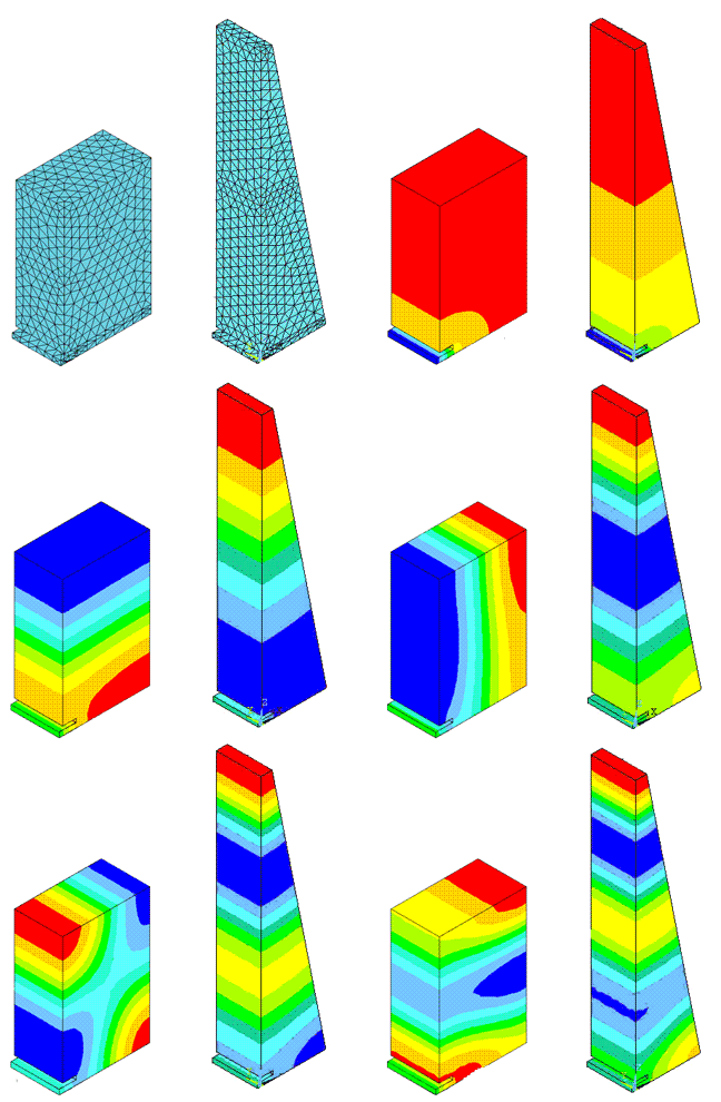

Martin King clearly showed that the behaviour of the air mass inside the box change from a BR behaviour when the box is close to cubic, and transitions into a 1/4 wave resonantor as one dimension increases wrt the other 2.
An ML-TL or an ML-V may look like a BR but is not one.

Indeed! When I transitioned to tower/column designs I noticed that for the same net volume [Vb], tuning [Fb], they were tuned lower, so where a sim/build needs a shorter vent than BR is the minimum aspect ratio point.
Unfortunately I never figured out a simple, accurate enough ROT at where this point is, though so far the ~38" o.d. seated ear height [~36.5" i.d.] most times allows at least a minimal amount of 1/4 WL vent loading with tunings in the low 40s and provides significant damping with vintage spec [high Vas] drivers; like in some cases it shortens the vent so much I have to increase the vent area to a simple baffle thickness reflex vent, which can sometimes push the vent area beyond the pioneer's driver effective piston area limit [Sd] = [Av]. To date though, AFAIK it's posed no problems in the field, with owner's really pleased with the high output, [mid] bass quality.

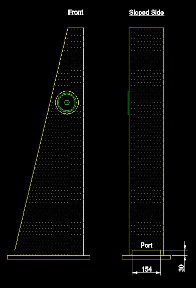

Morning Dave. I have decided to build your EL70 ML-V design, as it is stunning. But it looks like the angled baffle exceeds the 2.44m x 1.22m ply sheet I wish to use on the project? If I make it fit so to speak will it impede the performance?
Addendum: Can I also place the ML port on the bottom? Or even omit the port and use height adjustment to load? Thanks
The design is Scott’s. You can probably shorten the line a bit with little impact. Mass Loading needs to be in the same place, but could be placed on any side, and i suspecy fired out the bottom (with appropriate space) toward sthe floor.

The design is Scott’s. You can probably shorten the line a bit with little impact. Mass Loading needs to be in the same place, but could be placed on any side, and i suspect fired out the bottom (with appropriate space) toward the floor.
dave
After I posted I scrutinised the drawing for a solution, and discovered that if I placed the port on the sloped side it brought it within a millimeter of the 1220 dimension. Got lucky. I will post some photos up once finished. Thanks so much for all the help Dave & GM 😀
