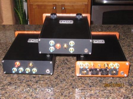

I received my kit last week and have been busy looking for the perfect enclosure.

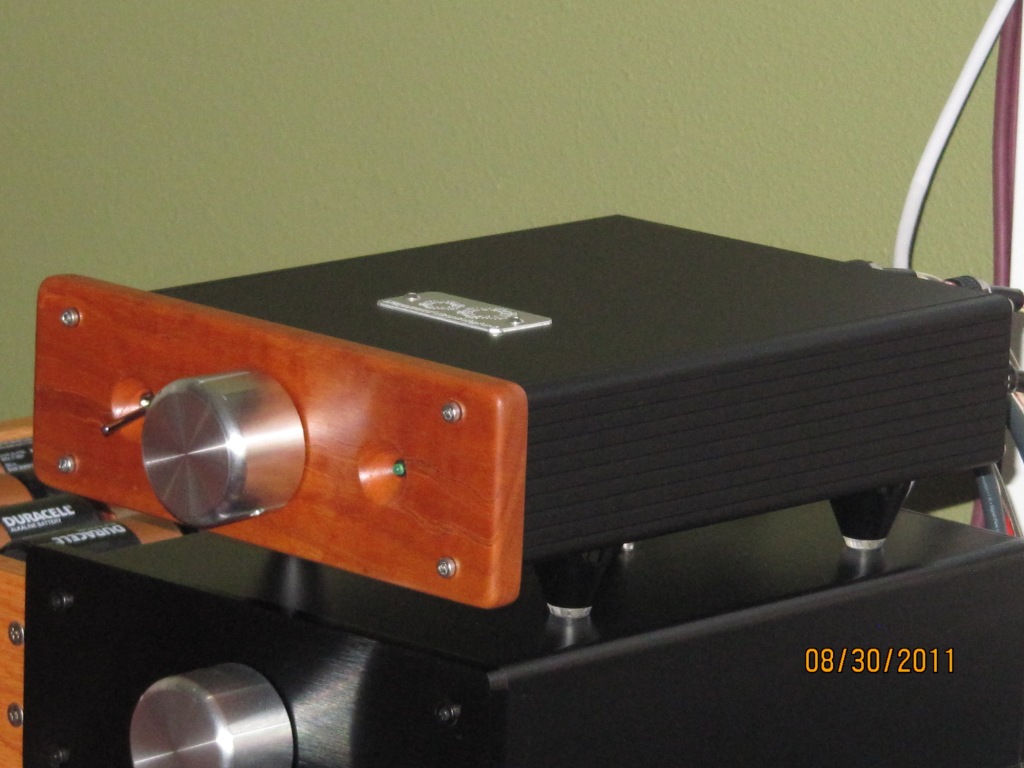

Meanwhile, I have a question about batteries. If I was to use a 12v 10ah sealed lead acid (like Dodd's use) would there be any risk of over current to my Warpspeed??? Would some kind of current-limiting be necessary???
Another question... possibly off-topic 🙂

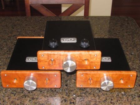

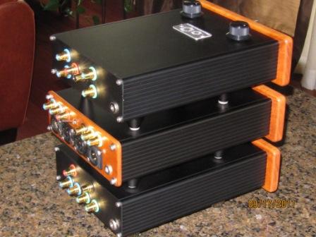

What is the reason that some of the enclosures pictured in have such tall feet???
Thanks,
Thanks,
Hi Ray, the W'squid has current limiting...but long before it kicks in, with a high current fault the optos would be long gone to semiconductor heaven...they'd blow like a fuse and open the circuit.
The feet...it was just the look and feel (and some damping) I was going for. In my own little imagination, seen from the side the chassis looks like a silver-headed black panther poised to lunge...🙂
No, you can use whichever is most convenient...as long as the circuit is wired correctly and safely, all will be okay. Since the circuit runs in low current it does not require a humongous SLA battery. The design is quite robust, had been tested...but as always with electronics -accidents, random part failures, etc. are always part of the equation.

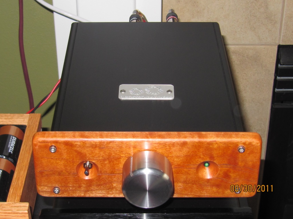

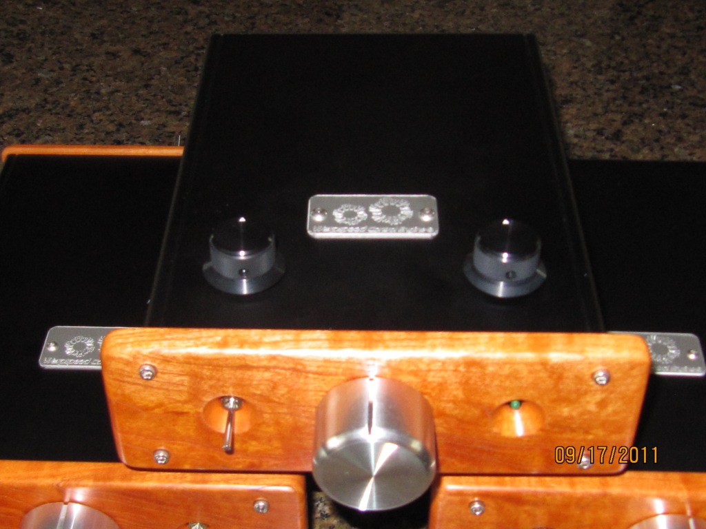

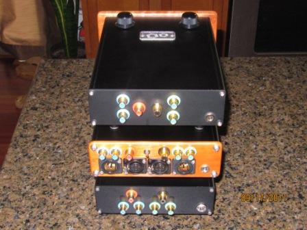

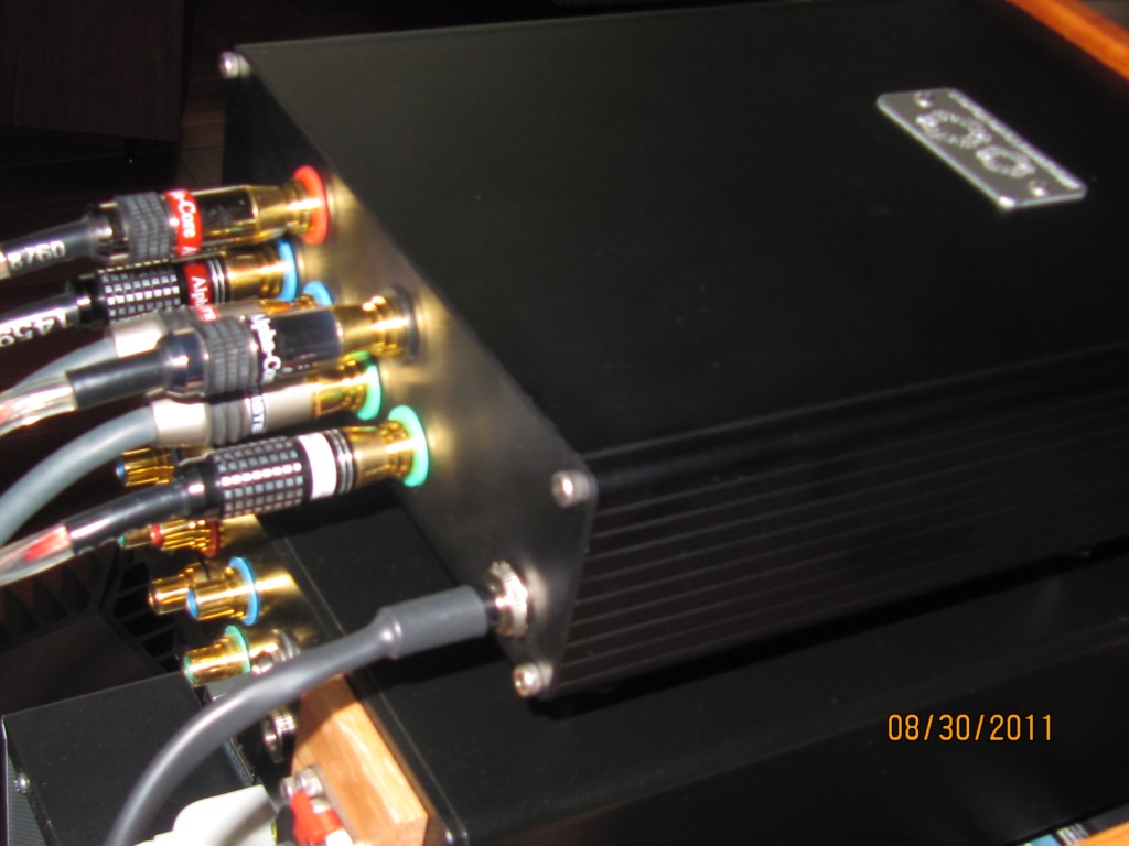

The Warpspeed CE family is now 3...the engine options are V4, V8, and V12(under evaluation):
V4 -single input Unbalanced only with dual pairs of paralleled outputs
V8 -switchable Unbalanced (in/out) or Balanced (in/out); dual pairs of paralleled Unbalanced outputs
V12 -Unbalanced with dual pairs of outputs with separate control for high and mid/low and master volume control. Passive bi-amping taking advantage of the loudspeaker designer's optimized crossover/driver combo. Two different amps (design/gain) for high and mid/low is now possible.
The inside of the V12 is pictured...

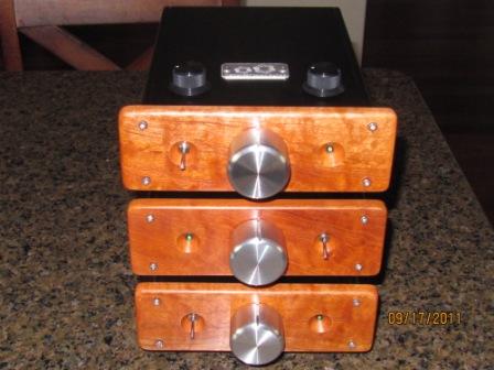

The spawn...
V4 - 1-Input/2-Output(paralleled) stereo Unbalanced only
V4x2 - 2-Input/2-Output(paralleled) stereo Unbalanced only
V4x3 - 3-Input/2-Output(paralleled) stereo Unbalanced only; future product
V8 - switchable Unbalanced (1-In/2-Out paralleled) or Balanced (1-In/1-Out) stereo; No Unbal/Bal conversion
V8.1 - 1-In/1-Out Balanced only stereo with single level control
V8.2 - 1-In/1-Out Balanced only stereo with dual L/R level control
V12 - 1-In/2-Out Unbalanced only with separate controls for high, mid/low bi-amping, and a master volume control; fully tested
V16 - 1-In/3-Out Unbalanced only with separate controls for high, mid, low tri-amping, and a master volume control; future product
Updates and pic of the V4x2 here... Warpspeed Optocoupler
