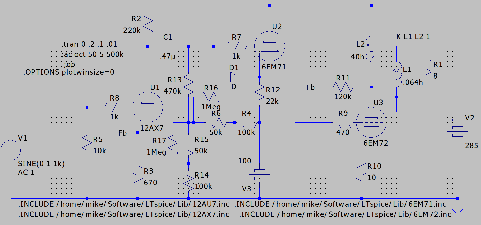

I am home on leave so had some time to putter away in LTspice (dangerous). Looking at possible 6EM7 amps I decided to take a look at fixed bias. I normally think in terms of cathode bias for simplicity and lack of maintenance but I thought I should look at fixed in this case since as a low powered amp the likelihood of being driven into blocking is higher. Fixed bias allows me to direct couple a CF to the grid of the power tube eliminating that cap and also the cathode bypass cap. As a bonus I guess you get the ability to drive the grid slightly positive but that is really not a big concern for me.
Well the simulations were really encouraging and as a bonus it seems there is a non-trivial increase in max power output. If you are starting with relatively high power the extra isn't a huge deal but when you are starting at just a couple of watts it is kind of nice.
This is what I was looking at.
attachment.php
The FB loop is primarily to make for consistent gain since I intend to use it later as a phase for an input transformer split PP amp. I could use the 6EM7 small signal triode for gain and another higher current triode for the CF but that complicates the layout and wiring to keep gain stage away from PS and output. I have reduced C1 to .033uf as it seemed unnecessarily large.
I am curious as to whether the biasing scheme is reasonable. It would be fed by either a separate transformer tap or possibly its own transformer. R6 and R15 are the bias pot and the two 1 Meg resistors R16 and 17 are from the wiper to each end to prevent runaway if the pot's wiper goes open.
1. Just be sure that the quiescent conditions of the output tube do not cause it to go into
thermal run-away. There is no auto current protection that self bias has.
2. Be very sure that V3 bias supply is at full voltage . . . before the output tube U3 warms up, and U3's B+ comes on.
The smoke is so very hard to stuff back into the amplifier's parts.
3. Suppose that a small amount of grid current (class A2) gives 1 dB more output power.
Then, amplifier #1, a 1 Watt amplifier becomes a 1.25 Watt amplifier.
And, amplifier #2, a 100 Watt amplifier becomes a 125 Watt amplifier.
Suppose amplifier #1 drives a 102dB/Watt speaker
And suppose amplifier #2 drives an 82dB/Watt speaker
The two systems will have exactly the same maximum volume.
Conclusion: a 1 dB change in output power will also sound exactly the same, whether it is a low power amplifier, or a high power amplifier.
If the increase due to going from Class A1 to Class A2 is 3dB, those two amplifier and speaker combinations will have the same results in the sound level of both; if you compare the 3dB difference in A1 and A2 sound levels.
All good points thanks. Yeah, the extra power is just a little bonus. The main attraction to me is the promise of better overload recovery. Any suggestions on simple ways to be sure that the grid supply comes up first? Would we get some benefit from the large capacitance that the B+ will need to charge? I suppose an easy way is to use tube regulator for B+ and SS diodes for grid supply. Of course the tubes won't conduct until the heaters warm up while a SS PS for the grids should be almost immediate. Can one fuse the cathodes without messing up the sound in case of grid supply failure?
I've always liked this idea of Wavebourn's. Not sure how easily it could be adapted to your situation.
Link 2 is to a reposting and the post immediately below says more about its functioning.
He's posted this idea a few times if you want to search for more details.
Another idea.
There's also a bias circuit idea for hard full neg bias at turn on and then bringing it up to set value after time to let the tubes warm. Rod Coleman has a board for this .
HTH

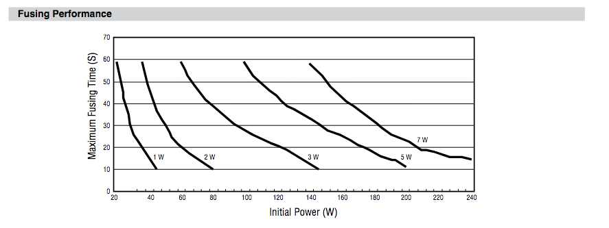

I think on run of the mill film resistors the behavior is variable and therefore not guaranteed reliable. The places I've seen engineers using them as fuses were with sand devices capable of dumping lots of current in a short time.
Fusible resistors listed at Digikey are 1 watt at the lowest and looking at Bourns' chart they would be too slow.
Looking at smaller power ratings with "defined interruption behavior" they are still not guaranteed to fail completely open. Vishay only guarantees rise of resistance to at least 10x value.
One Vishay datasheet for .3 and .5 watt resistors shows earliest failure time data starting at 3 Watt dissipation.
What about a fuse under the resistor? Or a relay in the cathode that would interrupt mains power if activated ?
Some of my amp designs use silicon for the negative supply and a tube rectifier for main B+. This allows grid bias to be either too negative, or at the proper value before the output tubes are warmed up.
In the Tubelab TSE amp the negative supply is SS. The B+ rectifier is usually a 5AR4. The output tubes are DHT's. Here the negative supply is at full voltage in milliseconds, and the DHT's warm up next. The tube rectifier is slower than the DHT's. The grid drive on the output tubes is a mosfet source follower in a circuit similar to your cathode follower. The bias is excessively negative until the main B+ comes up since it is part of the bias voltage divider. This works well even when a 5U4 or other DH rectifier is used. Some RC time constant juggling may be needed if both supplies are SS and fast warm-up output tubes are used (DHT's).
Issues can arise when silicon is used for both power supplies and a cathode follower is directly coupled to the output tube, since bias stability is dependent on who wins the warm-up race, the output tube or the cathode follower. Some tube dependent bias drift can be expected. Using a IDH cathode follower with a DH output tube is not always a good idea unless the circuit is designed such that the bias is always pulled to the negative rail until the driver warms up.
Fusing the cathode works fine in loss of bias situations. It is often less than successful in gassy tube runaway situations. A 1/4 amp or so "pico fuse" may save the tube or OPT in a bias loss situation.
I find that these Dale 1 ohm 2 watt resistors in the cathode lead blow like a fuse in extreme cases of "too much power." In this case I was finding the limit of some old 6L6GA tubes in AB2 on 500 volts into a 3300 ohm OPT. In both cases one of the cathode resistors blew due to a tube arc somewhere beyond 110 watts output. In both cases the tubes survived and still work today at a more sane power level.
They have prevented disasters in sweep tube amps where the tube can pass amps of current and my old HP bench power supply goes to 650 volts and has 1000 uF of output capacitance. An unfused screw up resulted in one of the OPT's becoming a magnet. It was a $16 test OPT, and it was successfully degaussed, but it still doesn't sound right and produces more THD than it's brothers.
I use a relay interlock for safety in my amps.
The -110V (or -200V on the larger amps) supply powers a relay that turns on the main B+ supply.
If the bias supply goes missing/fails, the main power is cut, saving the tubes. It also ensures the bias voltage is present on the grids before main power is there.
Reactions: Vincent77
Thanks George. I will check out pico fuses. Also good thought about the driver v.s. output tube race. In this case the follower and the output tube are in the same bottle so the heater characteristics are the same so probably will be a photo finish. 🙂
Lots of those little buggers to choose from. I didn't even know they existed.
PICO(R) Fuses - Axial Radial Thru Hole PICO(R) Fuses - Littelfuse
Thank you also Kodabmx. That sounds like a very clever and simple solution. So as I understand it the normally open relay is powered by the bias supply and when energized connects the B+. Do you switch the Unfiltered side of the B+ or the filtered side?? If I use a separate tranny for the bias supply I could switch the primary side of the main tranny which has the advantage of switching a smaller AC signal but it would also mean a gradual ramp down if the bias supply fails which could lead to a significant over current time. Switching the heater supply is another option but again has a turn off delay.

Great discussion guys. Charlie, I am pretty well set on the EM7s as I have several and have heard that they sound very nice. That 6N6G sounds pretty interesting though. My eventual plan is to use some Cinemag input trannies that have a split secondary to do phase inversion at the input with each side feeding one of these which of course then drive a PP OPT.
The small signal triode in the EM7 is know for being a bit variable in the parameters I decided to use it as the follower where that doesn't much matter and then use some plate to cathode feedback to a separate VAS so that the gain will be steady and equal for each phase. A little lower impedance driving the OPT isn't a bad thing either. Of course in this setup I am actually setting the bias for the output tubes by setting the grid voltage on the CF. That way I can easily experiment with operating points possibly even trying Class A and AB in the eventual PP form. I could use a series of 9V batteries to power the bias voltage divider but that would probably cost as much as building a normal grid supply given the stuff in my junk boxes.
In the mean time I have a couple EDCOR 5K SE OPTs so I can get the circuits working and hopefully debugged.
And then there is a preamp... 😀
One point about the so called cathode "fuse" on the OP stage; in my experience most resistors go high not OC meaning the OP valve is biased very hot. All resistors I've measured that have gone high measure roughly 1m sending Vgk to about +30v. That said, such a resistor also limits Ik.
Liked your 1m R's across what I assume to be a pot in the -V bias. A good simple way for a non bias voltage situation is to use a relay powered by the bias V to connect HT/B+ to ground. No bias V, no HT. Also simple to use an RC time delay to energise the relay coil,hence bias protection & delayed bias in one.
Andy.
