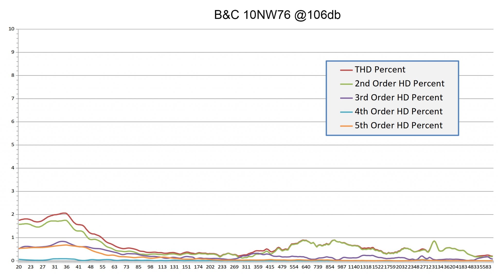

it is actually encouraging to see in the curves here that the industry seems to maintain a pretty good standard across different drivers and all of them could be expected to perform well within the intended freq range. I mean when you see in the old ISO standard that for obtrusive tonal noise it is recommended to be 17dB or better under the broadband noise, then 30 to 40dB down from a pure tone is pretty good for something that is meant to move air down to say 100-200Hz range.

Speculating on the performance of a speaker tested at over 20dB less SPL than it will be used is just speculation, similar to that of testing the handling of an automobile at 10 MPH and speculating what it might do at 125 MPH ;^).
You want 130dB@1m continuous from one 10" driver??? Good luck!The SPL target for my next 'small' PA top is a continuous 130dB/1m (without blowing up, not low distortion at this level).
The B&C 10NW76 can deliver continuous peaks of 126dB at one meter (+20dB over the roughly 10 watt distortion test level above) without exceeding it's 800 watt "continuous" rating.
It's distortion would be considerably more than at a level 20dB less, and depending on the crest factor of the program, the peak level would begin to fade due to voice coil heating impedance rise ("thermal compression") after continuous use.
Thermal compression is an important consideration for high power use, the difference between drivers rated in the 800 watt range may vary more than 3dB, unfortunately low power testing won't reveal that difference, got to get to "war" levels for that ;^).
That said, from my experience with B&C drivers, I'd bet on the 10NW76 to be near the top in the "war of the 10" monster midbasses" regarding heat management.

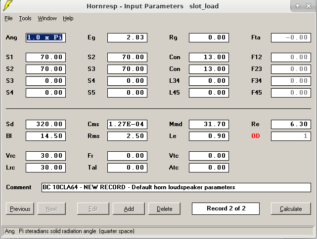

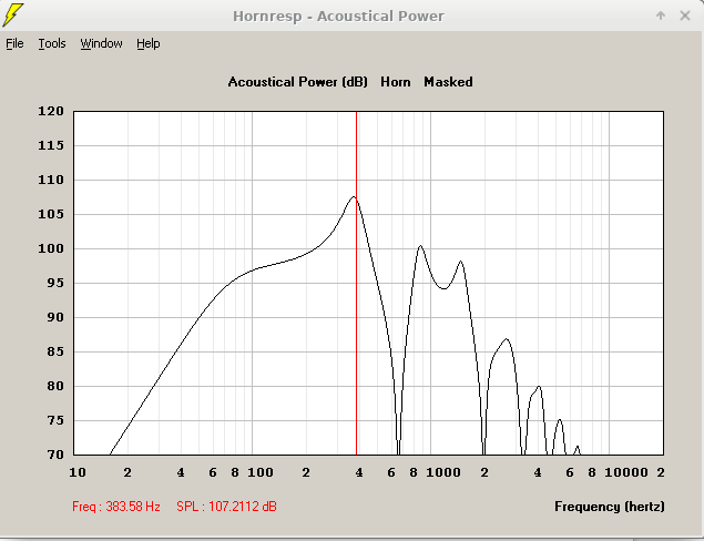

More like a 6th order bandpass box with a very small front chamber. Attached is a very basic Hornresp sim (without rear chamber venting so 4th order) showing the general idea*. In the actual application I would use volume filling plugs so it would be a bit more complex. I generally ignore Nelson Pass articles I'm not the intended audience 😉
*This speaker is triamp and using FIR filtering so its intended to 'fix' the group delay spikes caused by this method.

Sorry, IMHO this does not look useful at all. Or do you want to use only the peak around 400Hz?More like a 6th order bandpass box with a very small front chamber. Attached is a very basic Hornresp sim.
Maybe I still don't understand it all...
this is the idea but it has evolved a bit in that there are now cavities in front of the side woofers that are only open on the front face. The peak is great news as it reduces power dissipation when equalized out. The 10" is only going to cover a limited frequency range 100Hz - 300/400Hz (this is only a rough idea I haven't done that much simulation work yet).Sorry, IMHO this does not look useful at all. Or do you want to use only the peak around 400Hz?

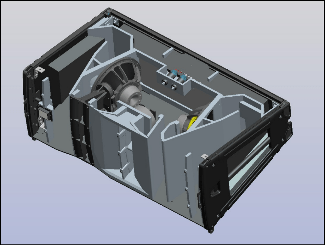

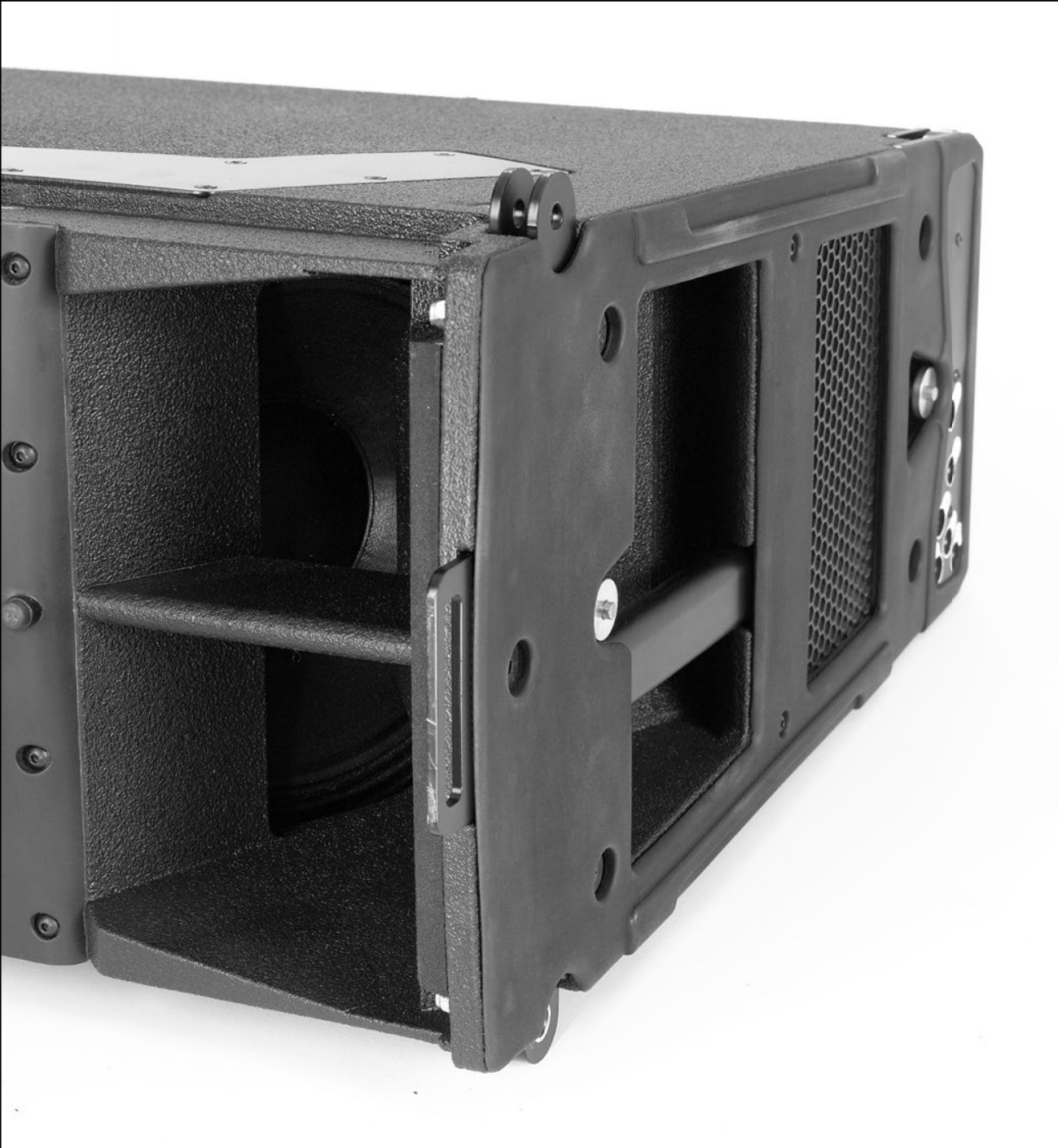

Martin Audio has used slot-loading throat adapters on short horns for a very long time. Their latest boxes port the rear chamber. Here's a close up of the 10-inch LF section of the MLA Compact, which is a hypex horn with a low value for flare-rate, T:
Forgive the large size of the image, but I thought it best to make sure you can see the cone clearly.

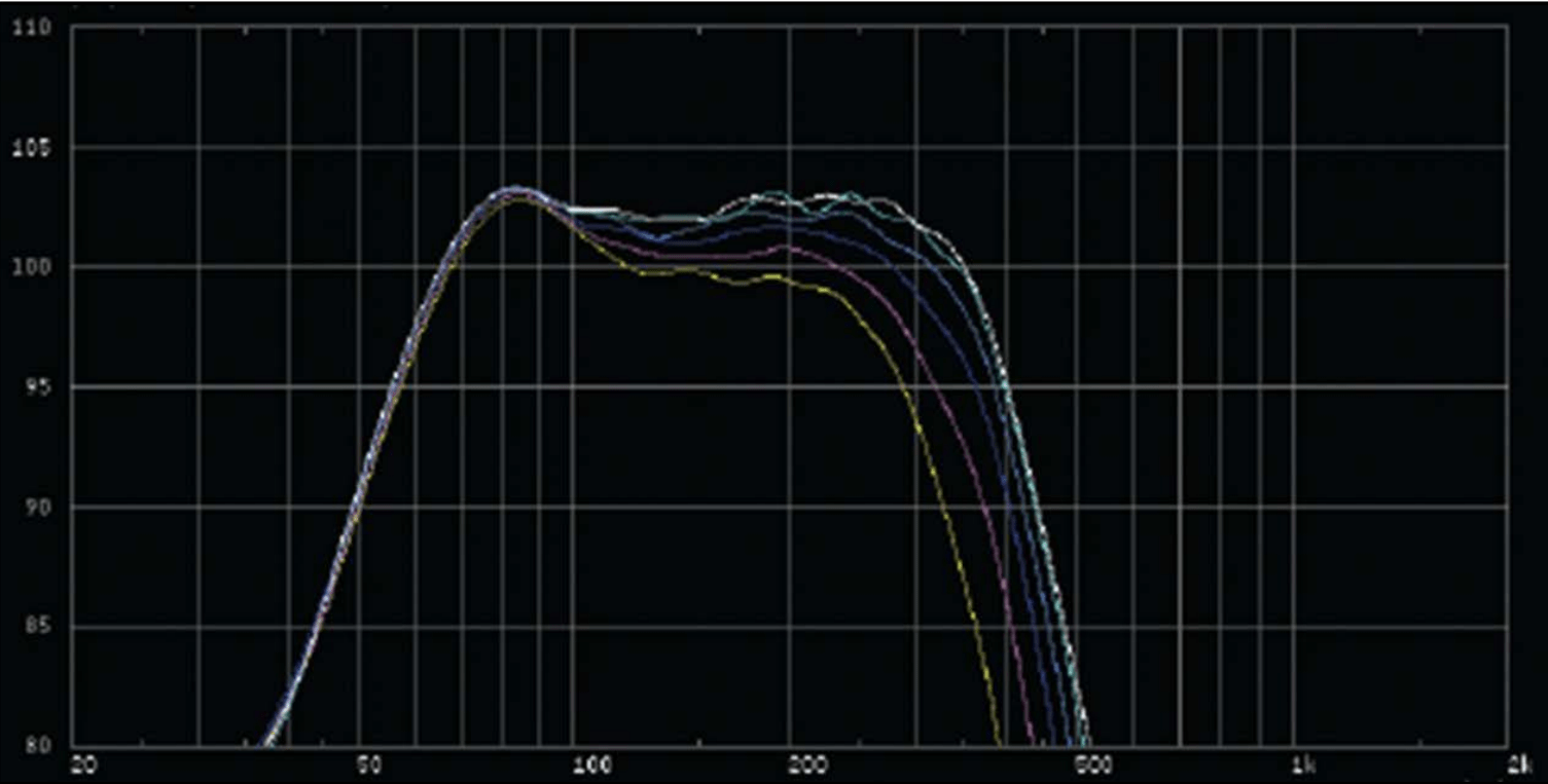

Forgive the blurriness, but this is the published 2.83 V sensitivity on-axis (white trace), and at a few 10-degree horizontal offsets.

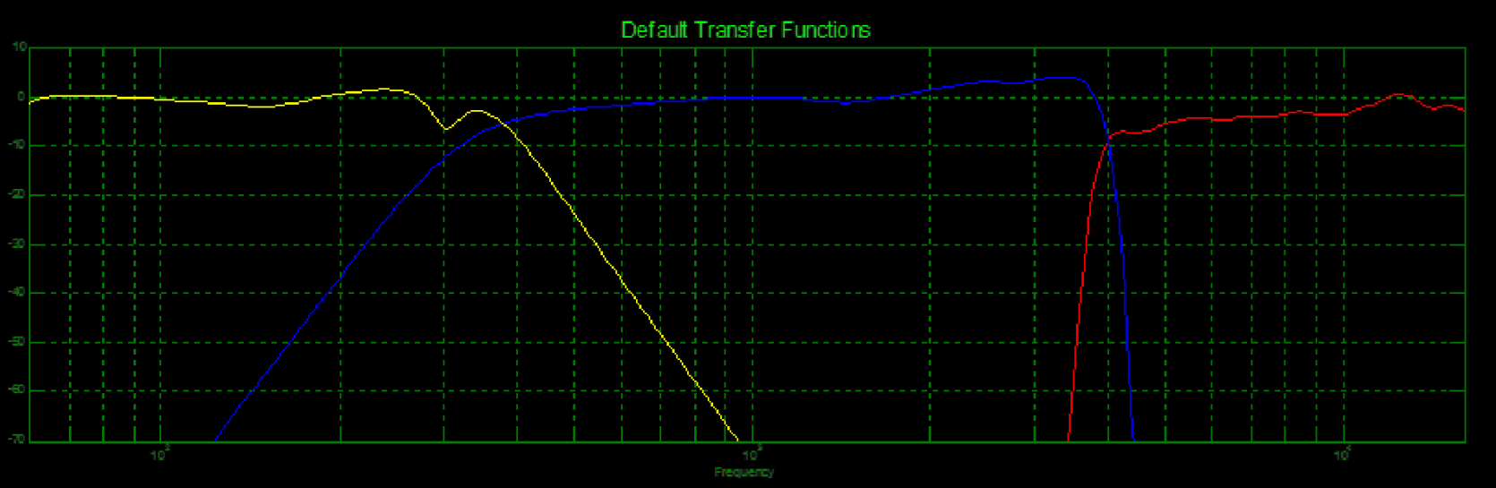

You can perhaps see what's going on a little better in the bigger brother MLA box, which uses dual 12" in a shared rear chamber, rather than two 10" with their own separate chambers. The 10" version doesn't have the bend, but both of them are crossed in the 300-400 Hz region to the mid-range elements using 4th order slopes as shown on the transfer function plot above. I'm pretty sure both of these boxes also use B&C drivers for the LF section.
I believe the use of the slot evens out the pressure across the diaphragm, while also increasing the compression ratio. The horn itself seems to be explicitly 'cut short' to trade loading at the lower cutoff for more output in the vocal region and optimised using BEM to reduce the resulting ripple in the acoustic impedance.
