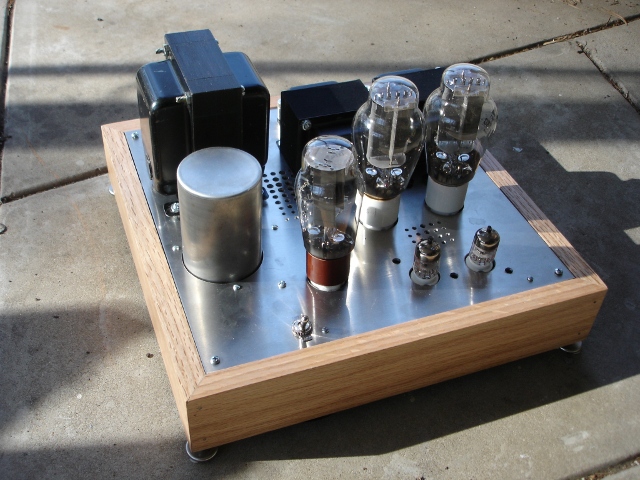

I love my tubelab SE (not simple). Built it a couple of years ago. I've built 5 amps since I built the tubelab se, and none beat it. I try, but can't. It cost me less than that bottlehead kit, too, but I had to do slightly more work. I had to order all my own components and build my own chassis.

And you make it look really good with the custom chassis!!!
Thanks a lot! I bought a drill press for that project, and yeah.. it worked out well. Gotten a lot of use out of the drill press since then, too.
I did the panel layout/drill template in autocad. I might still have the drawing file around somewhere.
That would be great if you could send it to me. I actually have a degree in machining and used to work as a machinist. Now I am in the medical field and like to dabble in this type of stuff for fun. A friend still has access to the plant I worked at, so I think I would be able to have them drill the holes for me. BTW, what type of tubes are you using?
the rectifier is a 5u4g, and the power tubes are 300bs.. those are mesh plates in teh picture, but I can't afford any more, so I rarely use them 🙂. usually just cheap chinese 300b's.. (the kind that are 100-150 for a pair). Input tubes are raytheon, and I forget the type.. whatever the instructions say to use.
I just printed out my cad template and drilled it by hand. If you're going to have a machine do it, you may have to modify my drawing, but u'd know more about that than me.

The big cap is an ebay motor run 80 or 100uf.
