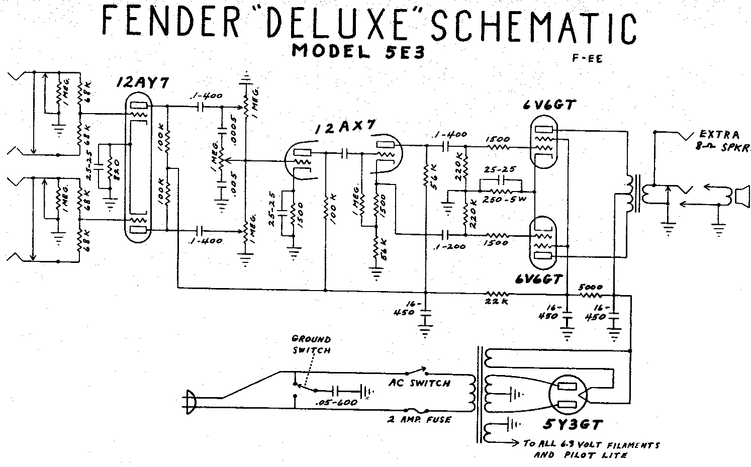

How about a Fender clone?? A well proven design.......can you do it?
