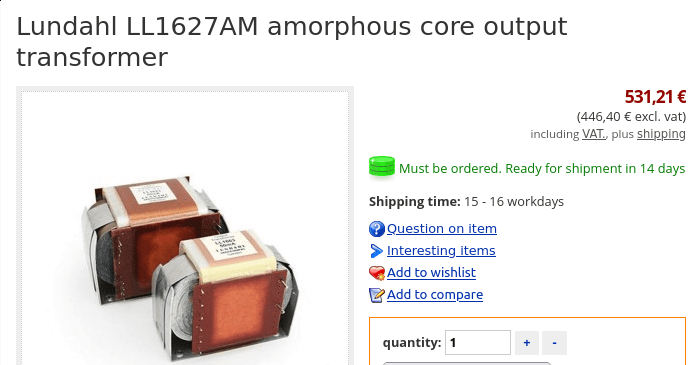

remember good iron like standard lundhal sound good vs top amorphous EU OPT ,that I haveAlso, amorphous C-cores for these transformers can be purchased on Alibaba for $6 apiece. They charge $100 shipping, so buying a batch of 10-20 makes sense, but a pair doesn't.
With a total weight of just 2,5kg i doubt this is the transformer people are looking for. High copper losses, not 20Hz full power and also it can't handle 300mA, just 185mA bias current.
I bet this transformer will sound thin. You need at least a core with 2,5kg
That would be to expensive, just shipment USA -Europe cost to much. A reasonable priced costum transformer for this project could cost under 350euro (ex shipment)Don't forget Dave Slagle at Intact Audio. Custom wound to your needs. About as good as it gets.

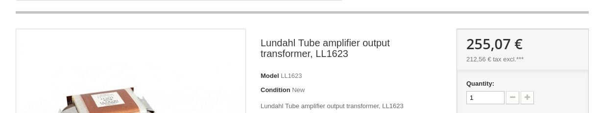

Why you think Lundahl is better then China?better use standard lundhal for 400€ pair
Within EU, the price is net, with VAT of origin of trade country (or destination country if it's better).Is European-made stuff VAT-free?
The import (mainly/primarily form abroad -not EU-) is costly (minimal custom), the VAT is valid for price+shipping.
This price is comparable to EU made products, so the price isn't cheap.
I'm not a fan of Lundahl, but this products made by manufacturer, which products components with accepted quality.Why you think Lundahl is better then China?
Is noname chinese "manufacturer" do the same?
You probably meant 400 Euro a piece.better use standard lundhal for 400€ pair
