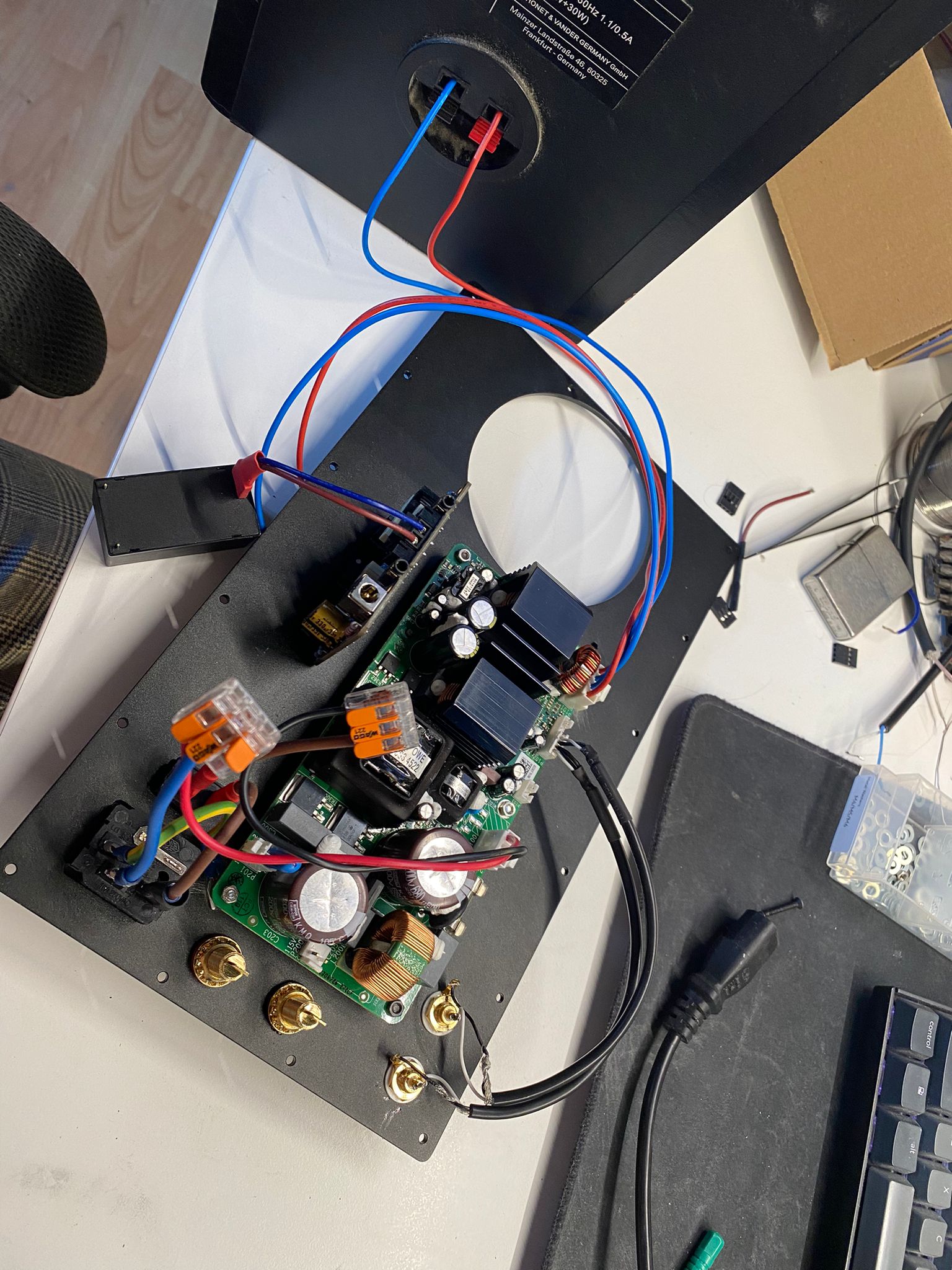

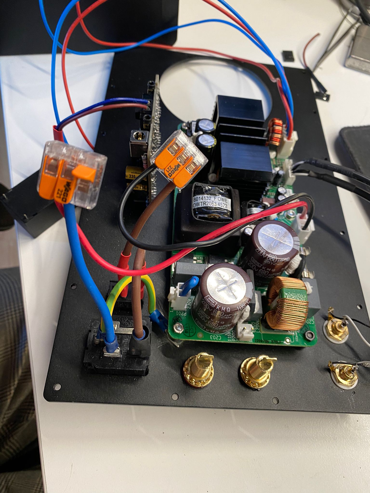

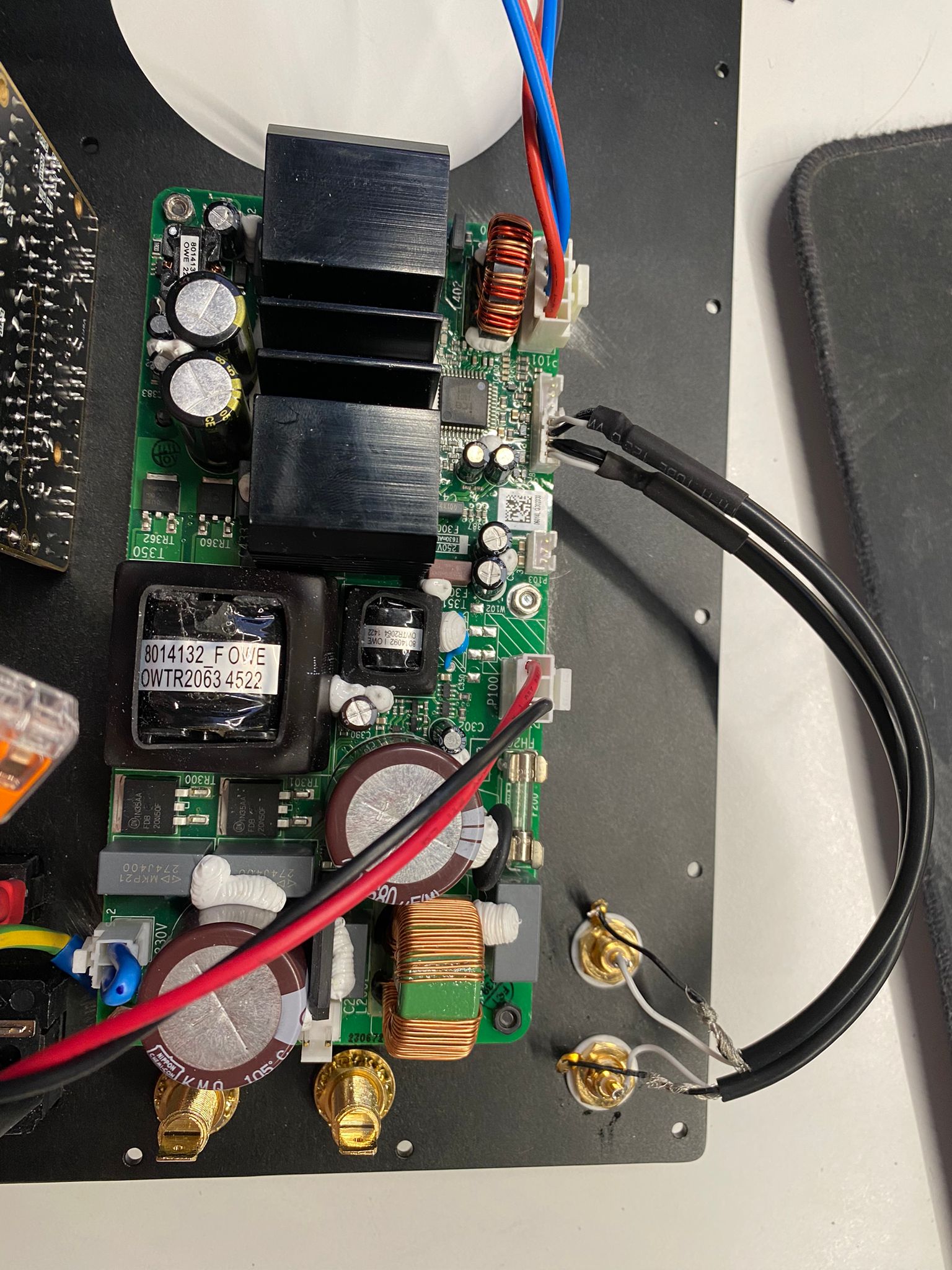

Wanted to sanity check my IcePower 125ASX2 build before i RMA it
I am in the process of making active speakers with which i wanted to use the ICEPOWER 125ASX2. I cannot seem to get it to work though. Googeled for the past 2 days and on the verge of sending it back but i quickly wanted to make a question here first. Could anyone have a look at my connections? Build an amp with an HypeX Ncore module before so thought it would be a breeze but i guess not 😉.
I am basically getting no sound at all, i don't see anything burned on the board. The only sight of life is when i turn it off there is a small oompf coming from the speaker
The little board in upper left can be ignored, that's a volume control board but the issue is without it connected
Also ignore the ugly open wiring, just quickly wanted to test it before i did everything nice and clean
