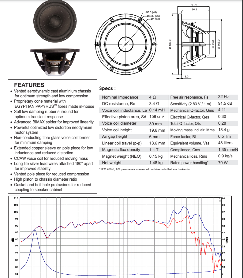

I lean toward using a pair of Scan-Speak Revelator because of their known quality. I did work before the Audax carbon fiber and Scan-Speak Revelators different sizes, those are great quality drivers but I never with the Aerogel or never heard them either. I only read about them "they are good drivers".

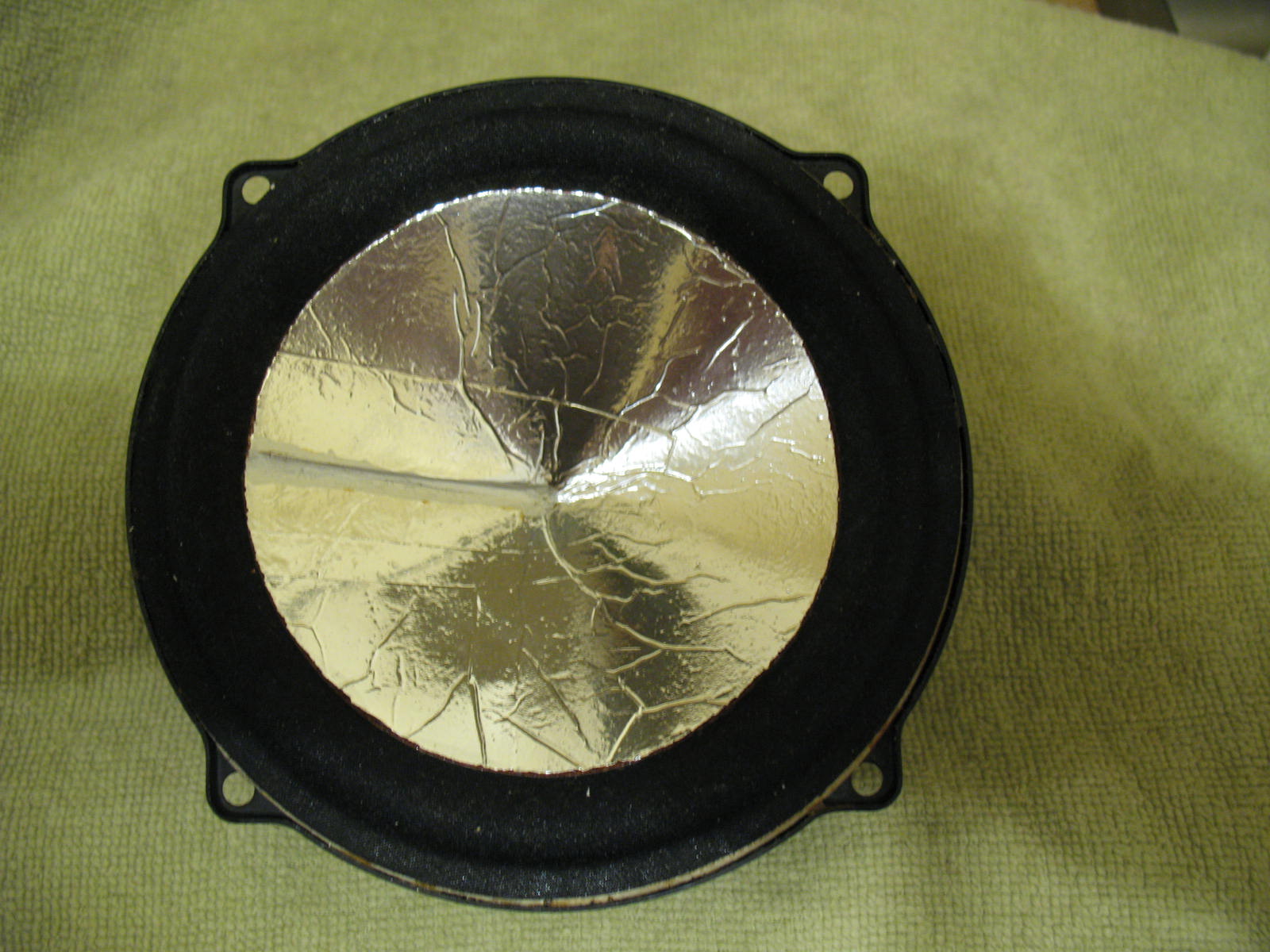

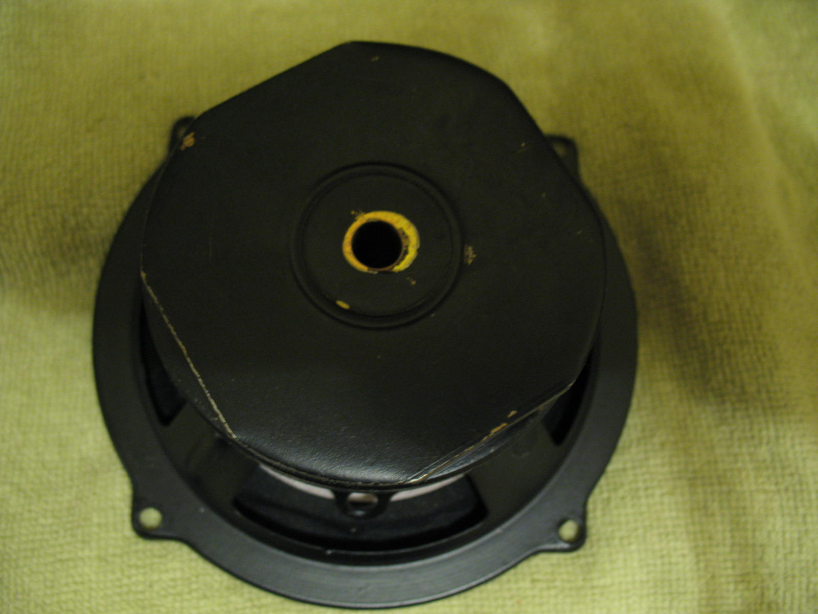

I forget to attach the parameters of the driver I want to pair it with the Audax. The one in the red bracket I own.
If it would be perfect if it would be 6.5" by size and 4 Ohms for the 2pc 10" woofers.
Even like that (with that sensitivity) I think it would be great, unfortunately, an 8 Ohms driver.
That is why the best solution I think is the Scan-Speak and use these for something else or sell it.

I'm not really a fan of it from an objective point of view. It has a resonance at 1.2kHz that unfortunately causes issues in the harmonic distortion.
