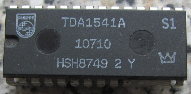

Here is one - but is also suspicious to me because it has no stripe.
Otherwise letters, S1 and crown seem genuine enough.
I noticed some were really with no stripe, but were also S1 like this?

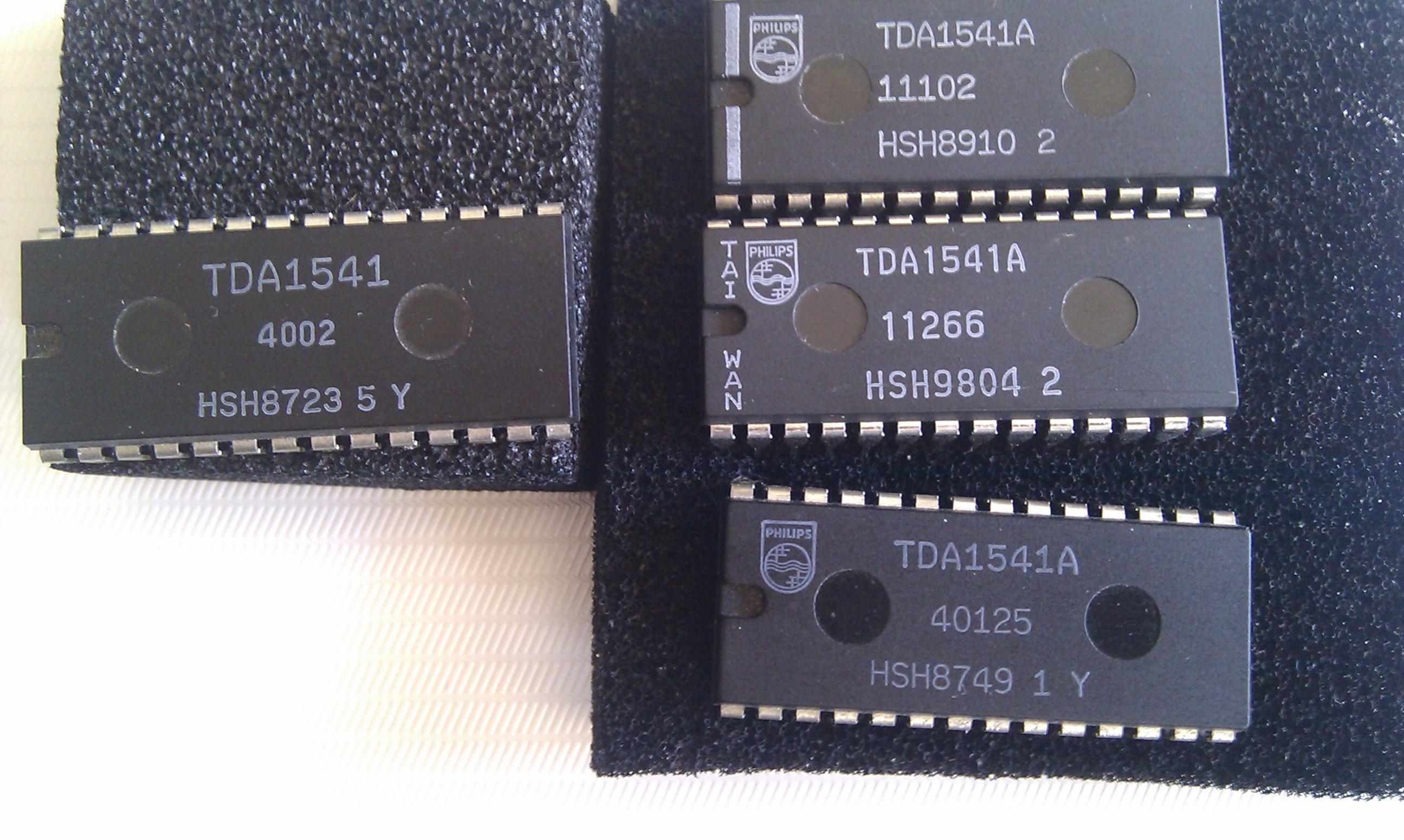

What is the number 2 one can see sometimes instead the Y or just before it on some chips ? There is also sometimes "1"
second choice ?
I have also a TDA1541 non A from 1987 marked after the month : "5 Y" ?!
all my chips are HSH from 1987 to 1998 ! and no HJH in my collection despite they were sourced on genuine dac players pcbs in France !
On the Taiwan I have : you notice with a carefull inspection than printing is whiter and a little thickier (not the same font than the others) : I have a doubt on its genuine origin... Anyone have Taiwans to compare ?

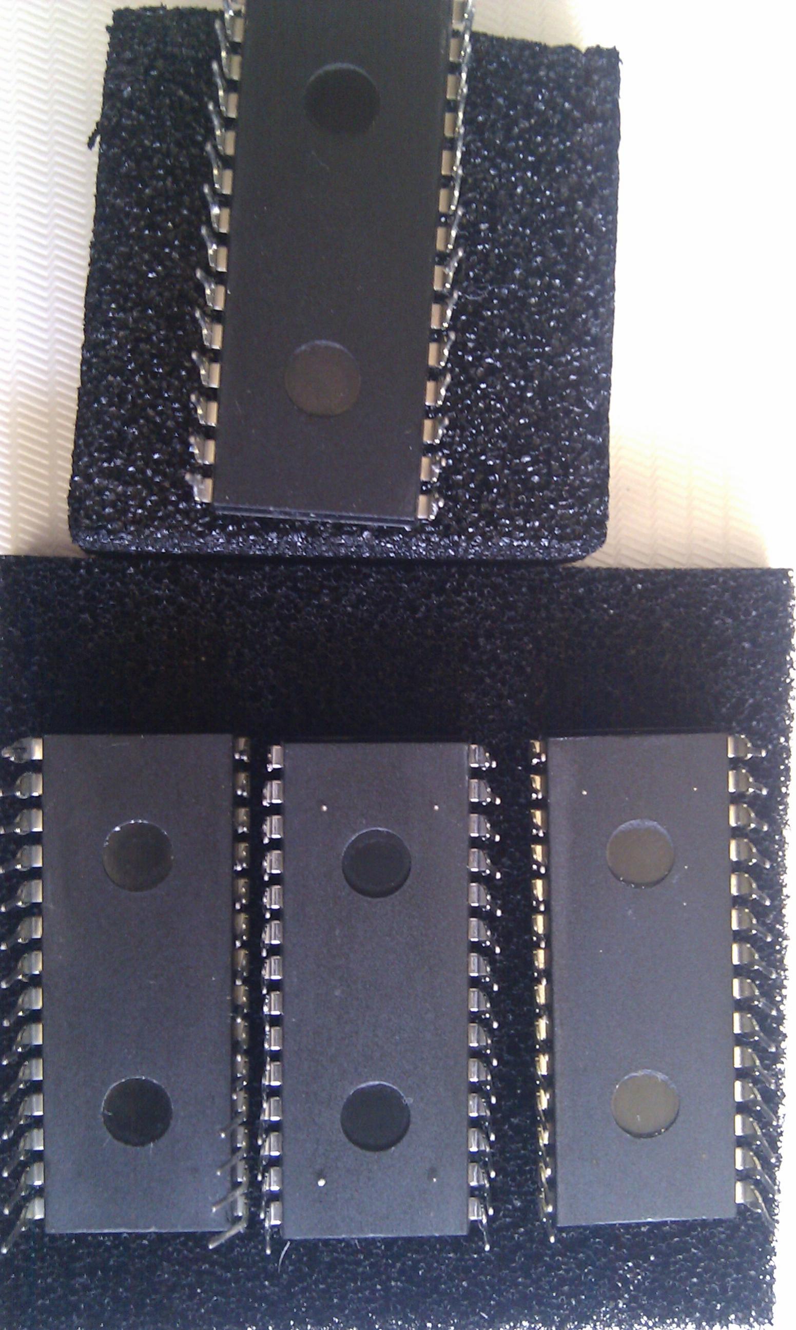

same chips reversed, you can see on the two on the top : more or less 4 metalic dots near the corner and the circles! It gives no clear tip imo : photograph of the one at the top, the bottom one and the left one were desoldered by me on cd players (Marantz/Philips)
Just the middle one where the metallic dots are more visible were sourced (the Taiwan 98) : but as it's a HSH too : 2 explanations : it's a fake or they changed their tool and marking font... which is also possible as there are ten years between this chips and the others !

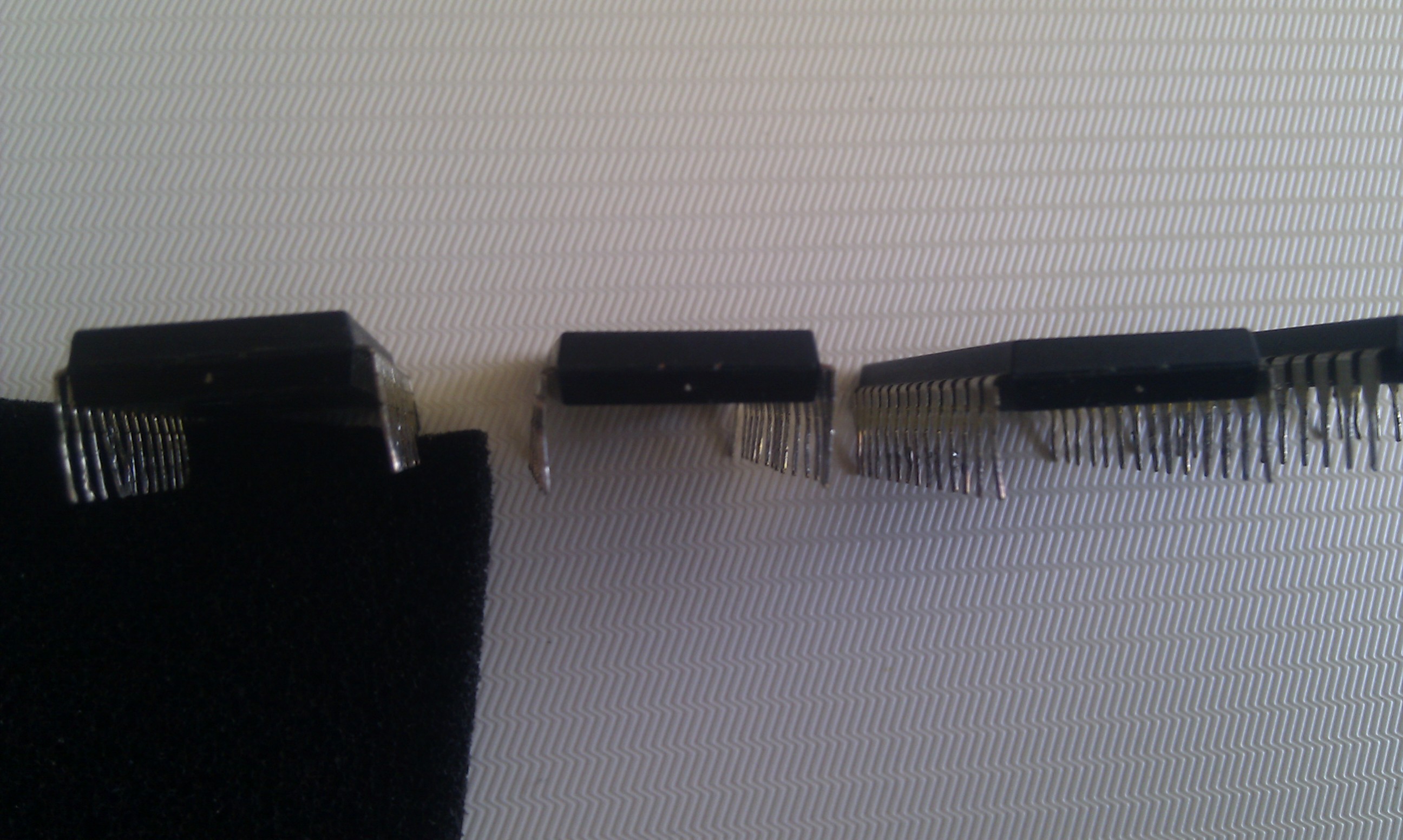

Now, if you look the sides of the chips : you can see more or less : 3 metalic dots which form a reversed triangle, the dot of the bottom is always more visible, while sometimes the two dots above are not visible !

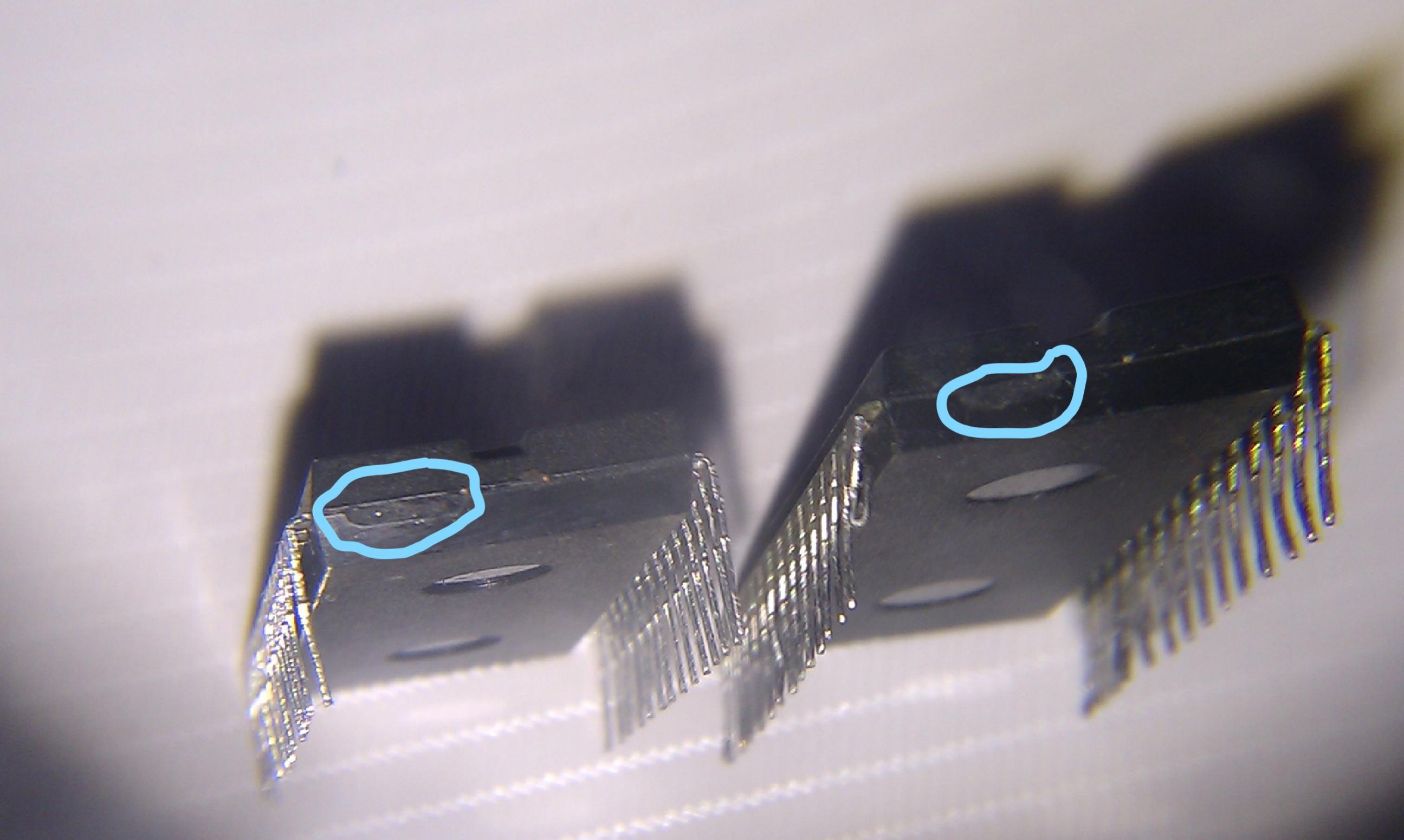

If you look at the other side, you can look at a marking which was maybe the injection plastic port : they have all the same width on all my tda chips but the Taiwan 98 at the left which is larger (around 1/4 widther) : so defintly not the same machine Tools for production or from elswhere !
Any ideas or testimonials ? Hope also it can help other members to source good ones ! But my idea is many bad tda chips you can see on the EBay markett are perhaps second sorted choice after quality control ! It could be cool if some guys of Philips whom read us have any idea ! (not vendors)
