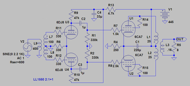

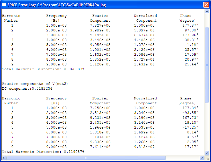

Allens output stage looked interesting so I simmed it side by side with Eriks conventional with a single 235ohm to ground.
Must say I am puzzled as Eriks has almost half the THD of Allens whether simmed with Allens or Eriks driver!
Both of course with the 3rd overtone dominating.
Did the sims with ca 4W/8ohm and the same OPT impedances.
As this is a static, theoretical sim, based on mathematical models of the tubes taken from their Ua/Ia-diagrams, it does not tell us anything about how they sound. Also, from what I have read, distortion sims aren´t always reliable.
The figures are from the ouput stages alone with balanced input.
