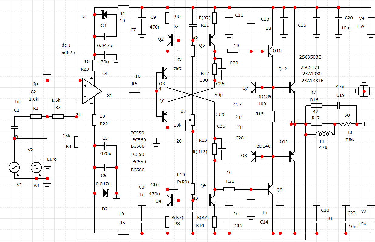

Id probably recommend the circuit in post #18, but perhaps with MJE15032/3 transistors instead of the BD139/140.

DIY: single ended class A running at <1A.
Otherwise you'll not get the best out of your headphones.
Circuits with op-amps and complex NFB loops...won't sound as good.
# 5 Class A on two transistors with a 20 ohm resistor load. The second could be BJT Darlington or Shiklai (or Mosfet).
Use a power transformer whose two secondaries each deliver 18VAC (RMS). That'll get you plus and minus 23V supply rails for the amp, but call it plus and minus 20V to account for low-AC-mains conditions and to account for trafo output sag when load current is high. 20V rails will give you at least 14 watts RMS into an 8 ohm load.
Now just build a bog standard "Blameless" class-AB power amp using thru hole, discrete transistors, following Douglas Self's textbook exactly. Done.
