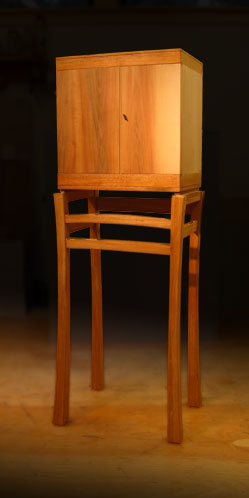

I use paper backed veneers, which generally come in 4x8 ft sheets, and the iron-on / yellow glue method. These sheets generally have at least 4 sets of book-matched flitches across the width of a sheet. Depending on the figuring on any individual sheet, and the size/shape of the enclosure, I might only get coverage of all sides of a single pair from one sheet. For example, the FrugalHorns curved side panels makes for poor yield, particularly since I insist on centering the book matched grain pattern on at least the front baffle of all speakers.
I also attempt to mirror image the pattern and alignment on the sides/top and bottom of a pair, and like to wrap the grain contiguously around the perimeter. Of course, every rule has its exceptions - particularly when the total perimeter is greater than 96" - which is where the engineered " quarter cut" varieties can justify their higher cost. They have almost uniform width/colour of grain, often with no discernible figuring at all, and I've been successful more than once on wrapping much more than 96" perimeter with almost perfect matching.
Sometimes I'll stain a cherry or lightly coloured walnut or mahogany to match colour of other furniture, and for top coat, I'll use an air assisted spray catalyzed nitro cellulose lacquer finish. Never been a fan of the waterborne "lacquers" / urethanes - even on a colourful veneer such as ribbon grain Sapele, they look cold to my eyes. On a birds-eye maple, or burled walnut / Macassar ebony, the urethanes can take in the look of a plastic laminate.
As I'm employed in the commercial millwork trade, I source all my materials through local wholesalers, who may have a few regional branches, but none do international shipping . Due to the size of packaged veneer sheets, if you're unlucky with the carrier, the cubed wieght freight costs can be more than the goods.
Asemetrical layout of your veneers can also be nice and look more natural.

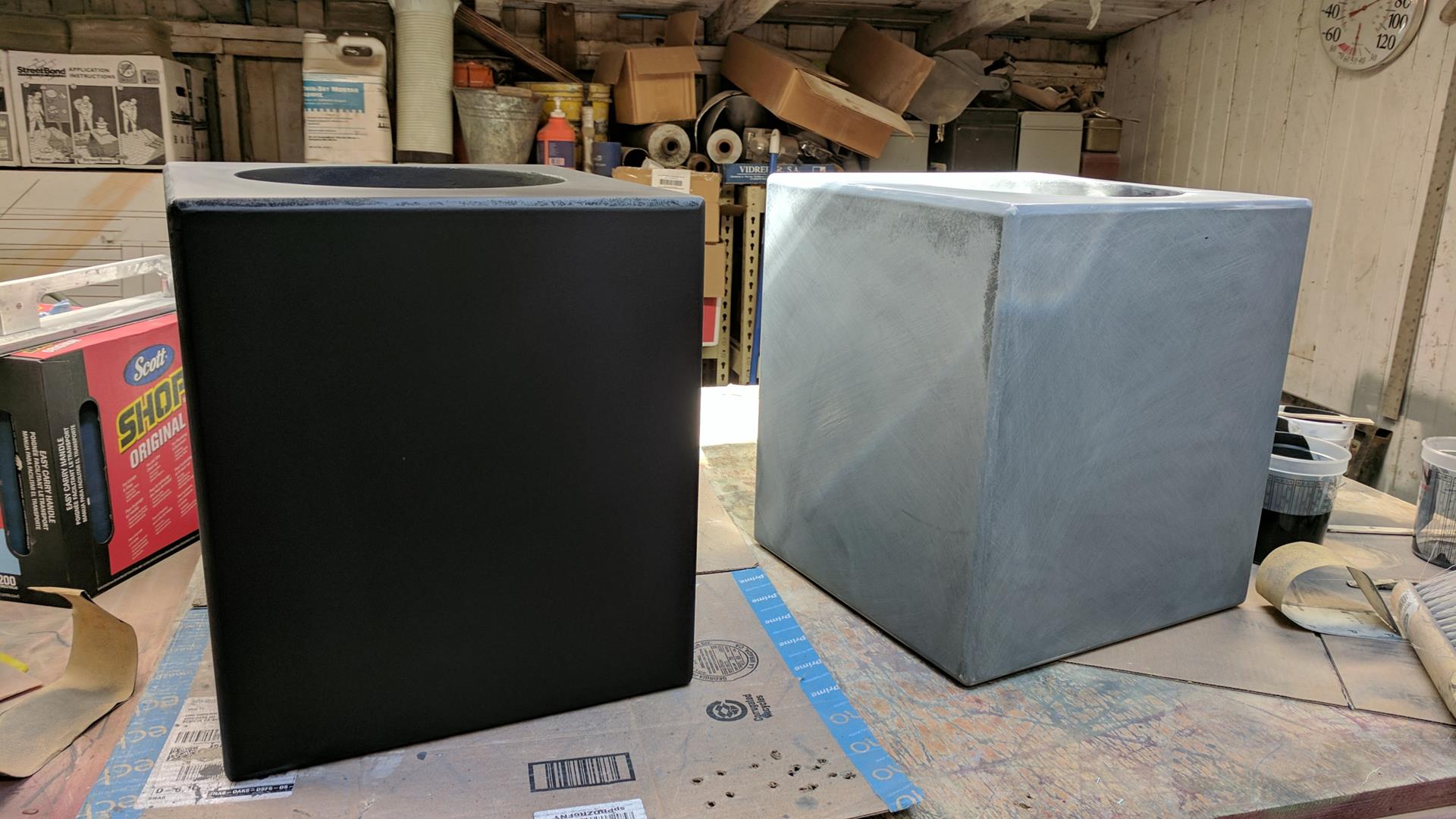

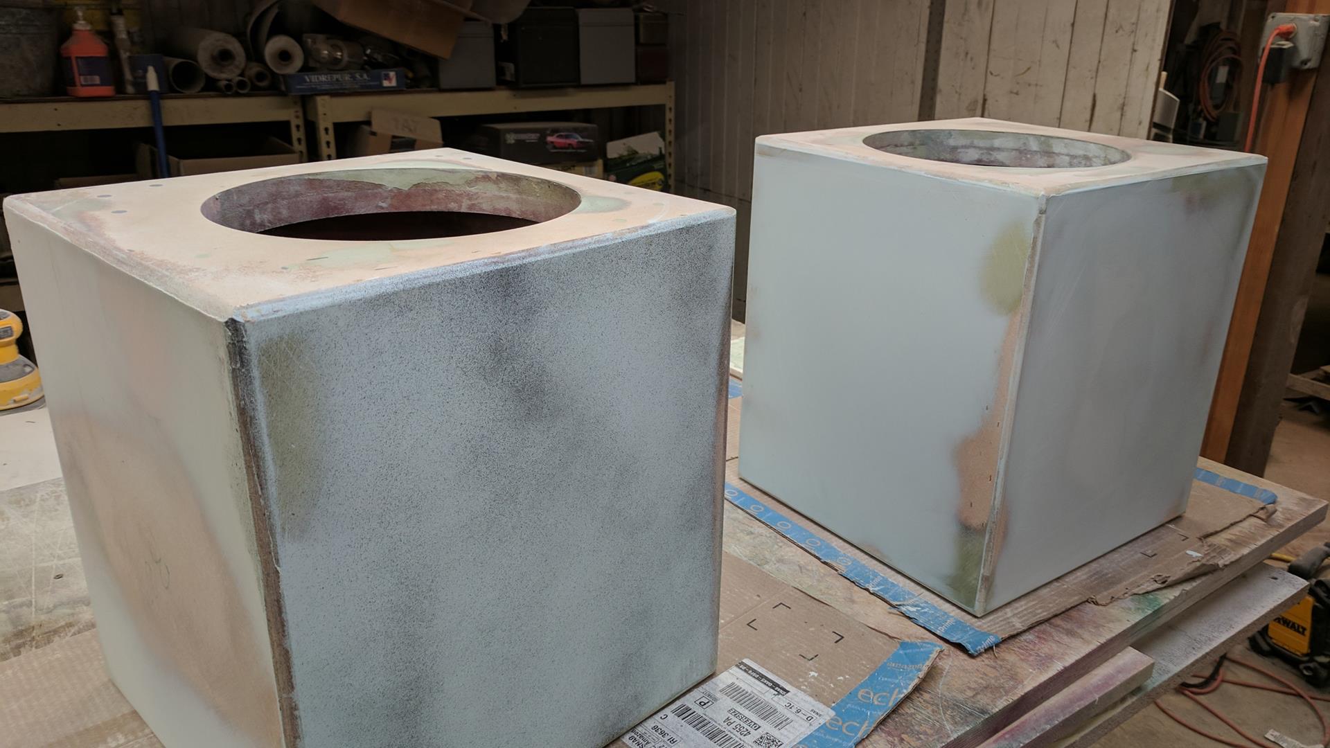

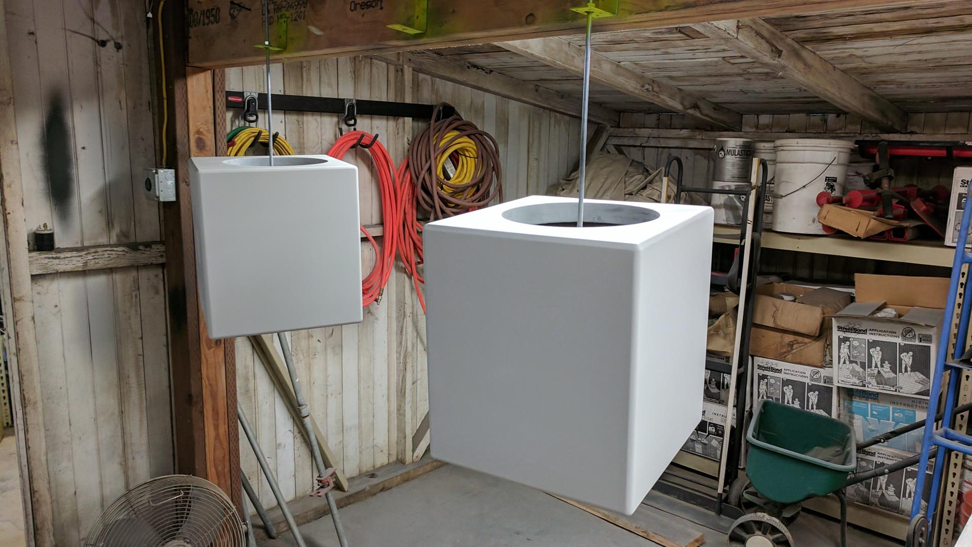

Anyway, I used G2 Feather Fill, USC Icing then followed up with a couple of coats of HB (high build polyester primer) using a large 2.5 tip out of a HVLP cheapy gun.
Next I will block sand again, then HB prime again, then urethane prime and sand, then the color coat/clear coat.
I will have a few months to check to see where I have problems at the joints.
On these pieces I did use some face screws and staples that I will not use on the next (actual) build. I wasn't originally going to try a high gloss finish on these pieces but like I said I am using these as test/practice pieces.

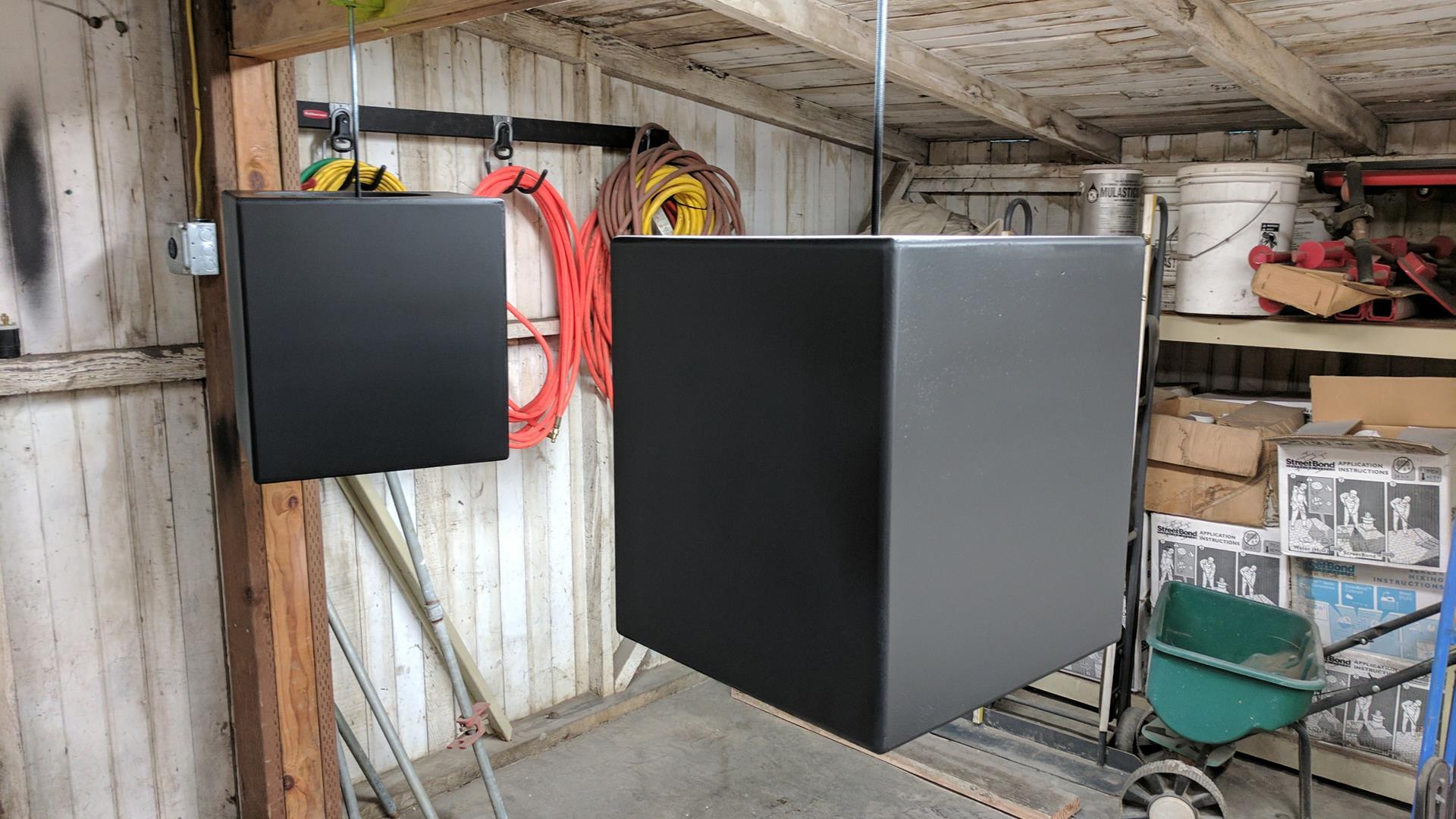

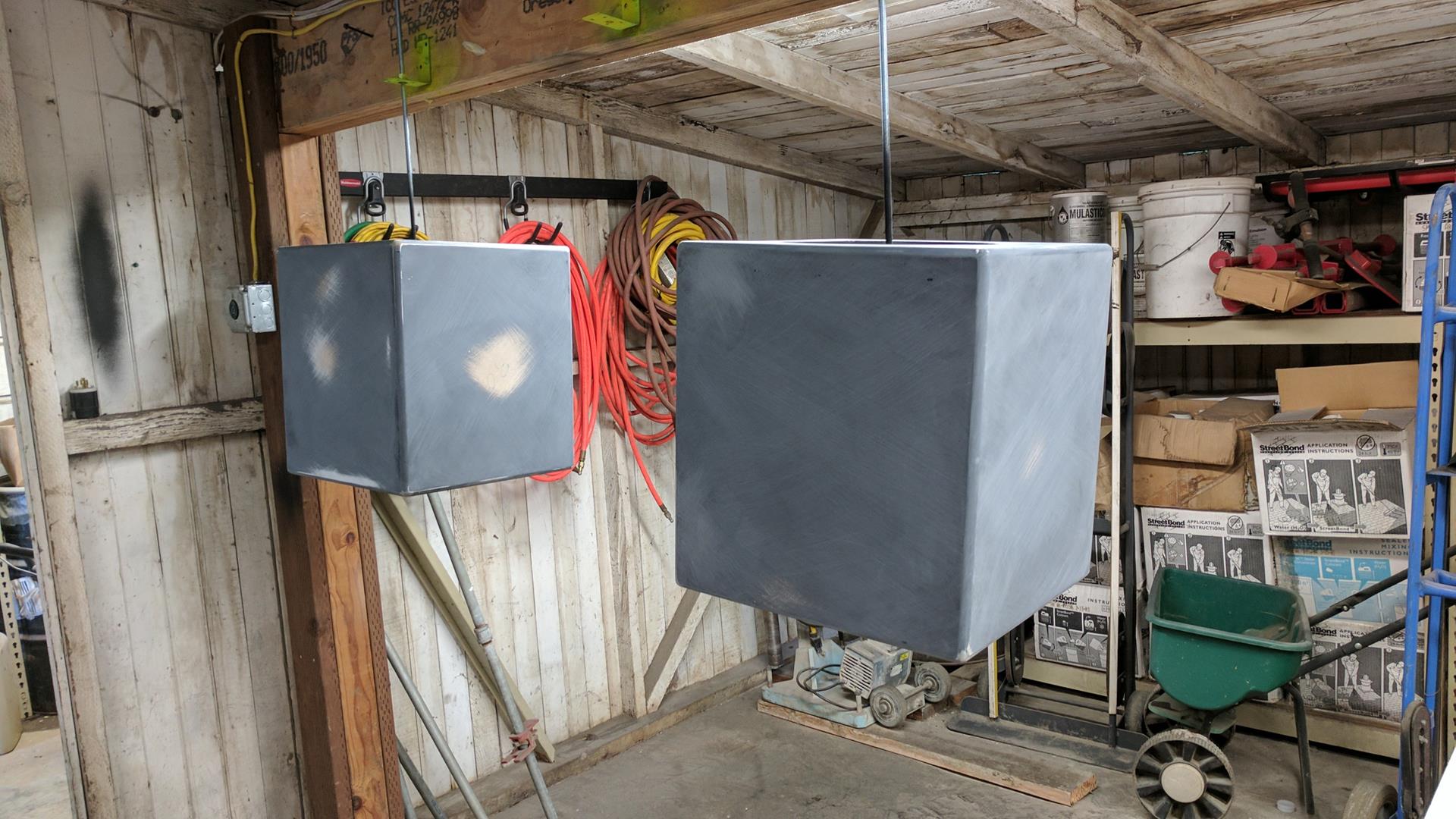

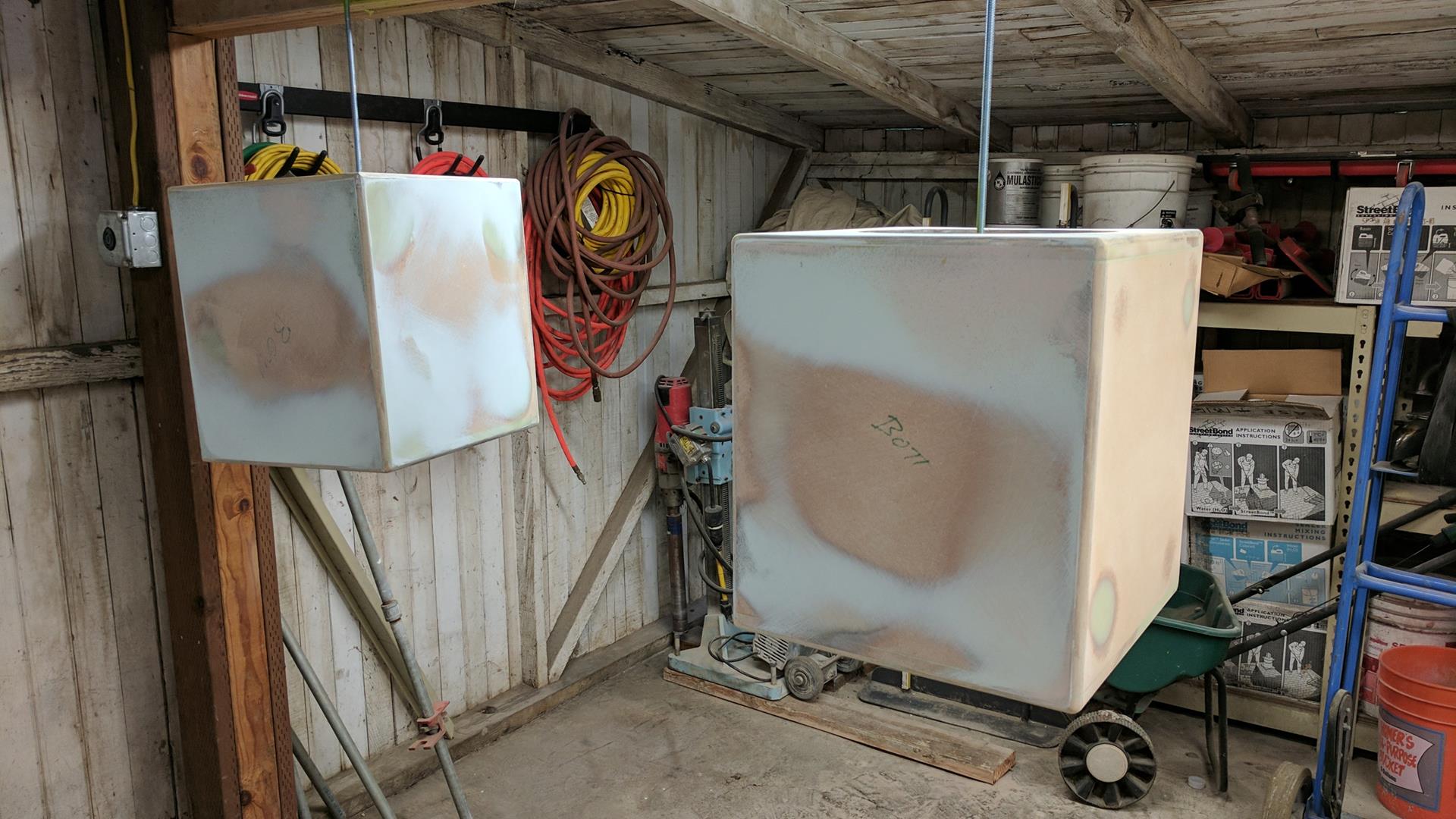

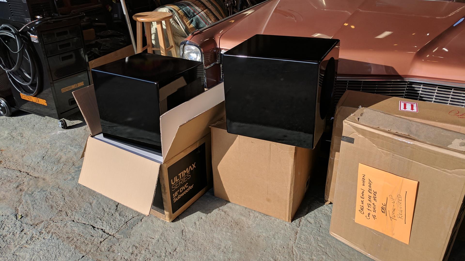

I sprayed some more HB (High Build) primer, G2 Feather Fill then I sanded the HB polyester primer with 180 dry then 220 dry and sprayed the boxes with some Omni MP803 (black) primer. The MP803 sprayed out a lot nicer out of my FinishLine primer gun with a 1.8 tip compared to the HB primer.
I then sanded them down starting with 320 dry, some of the areas I needed to go back down to 220 dry, then the 320 dry followed by 400 wet and finally 600 wet. I think that next time, I will use all wet sanding prior to the BC/CC, it seemed to give me better results.
I then used some Eastwood paint prep in an aerosol can with paper shop towels and thought that I had them clean inside and out. Turns out, it wasn’t clean inside enough.

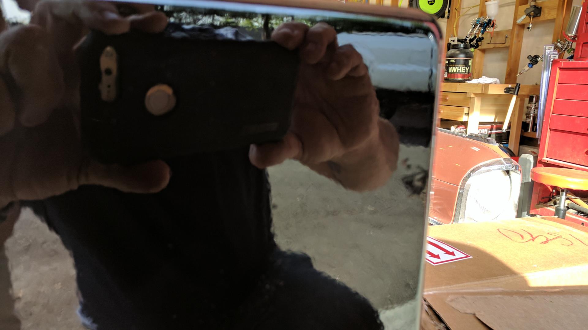

I used a Starting Line gun to spray the Omni MBPX 3.5 VOC Acrylic Urethane Basecoat in black. I got a bunch of dirt on the top of each box, one bug and one run. I was also having a hard time getting the spray pattern just right, but kept going anyways.
I then switched to my FinishLine gun with a 1.3 tip to spray the clear. That gun shot so much better. I could see a nice fan of the clear and sprayed three coats of Omni MC262 Urethane Clear.
I was surprised how well they came out, considering I have never done this and don’t really know what I am doing, but happy so far.
