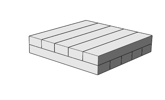

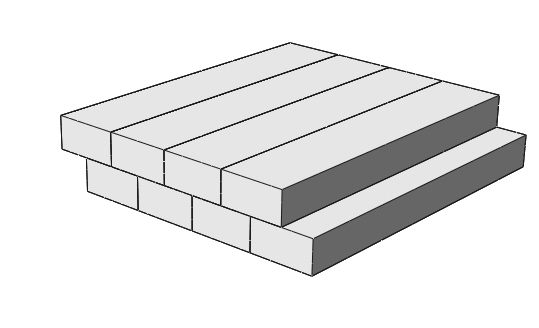

What if you laminated a bunch of boards together with pipe clamps and then planed them?
🙂ensen.
Well then, I guess you would have some sort of laminate, but again not solid boards like the original posts suggests. I would imagine that this approach could work, but as a woodworker and not a speaker designer I can tell you it is wasteful of a precious resource. If a substrate material like mdf is not desired, I think the next logical choice is some sort of plywood. Baltic Birch plywood would be a good choice because it is very handsome looking and absent of the voids characteristic of normal plywoods. I think we are overlooking a few other considerations that make solid hardwood a less than optimal choice. Hardwood is not cheap and certainly not abundant in the widths needed. It is also sometimes frustrating to mill without the proper tools (jointer, planer, biscuiter etc.). Time is a factor because of the time required for aclimation of the wood to it's new environment before milling. I just wanted to share some of the practical drawbacks of using solid hardwood because so many of the emotional drawbacks have surfaced already.
The alignment purplepeople suggests in post #89 is essentially plywood. Each layer's grain goes 90 degrees from the previous layer. Not a bad idea, but if you assume that you're using 3/4" wood, it's gonna get really thick really quick. For what it's worth, that's how I build the heads on my basses--plane down the neck laminates, then build them back up with hardwood veneer layers that I laminate in situ. Very dead. Very strong. Bear in mind that if you keep that up for enough layers, you're back to a 'dead' speaker, except that it cost you a lot more than MDF would have cost. Not to mention the hassle factor.
Eric,
Interesting idea. Oak flooring is available in longer lengths. Might save time and reduce the number of butt joints. As a fringe benefit, the fact that it's mass produced will make it cheaper than most other hardwoods for folks who don't have access to surface planers, etc. Me? I buy raw sawmill planks and DIY my own boards to whatever my needs are at the time, but most people can't do that. Just another expensive hobby, and it takes up a whole lot more room than electronics.
Grey
Grey,
How would you tune the cabinet to resonate at the dip if the material is not homogenous enough to be predictable? With MDF, the uniform density would make it easy to tune by varying the thickness in places and even machining it into specific shapes, but with a more resonant material like a hardwood... how?
