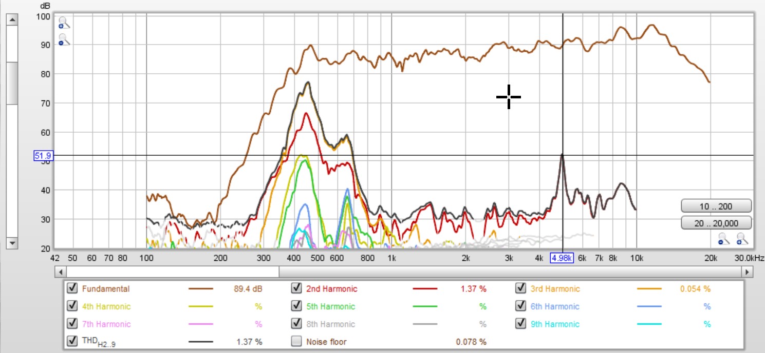

It would be a good idea to plan on using several of those 10" woofers. The sensitivity is VERY low and with an OB you will lose a lot of low end sensitivity on top of that. Have you estimated the dipole gain/loss curve for your proposed baffle size? You might be surprised how high the low frequency losses will be. Don't set yourself up for failure by not checking this first.
Since the Re of the woofer is relatively high, you could parallel up to three of them for increased (+9dB) sensitivity at the cost of a low impedance load. You could use four per side, connect them series+parallel, and retain the easy-to-drive 8R load while still increasing the sensitivity by 6dB. The woofer is relatively inexpensive, so four per side is still relatively affordable.
Also, even though Fs is low and Qts relatively high, the driver doesn't have all that much total displacement (Xmax*Sd) since it is only a 10" driver. OB has much higher requirements in this area. Using several drivers will increase the total displacement as well.
Also, I would not recommend using the PT6816 tweeter below 800-1kHz because the distortion performance there is poor and it will sound bad. There have been some distortion measurements posted in this forum, one is shown below:
Also, the top end of the response rolls off a bit early for a tweeter.
A simple design that tries to marry this woofer and a tweeter as an MTM will have some real flaws. Are you sure that is what you want to try?
