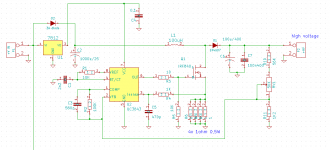

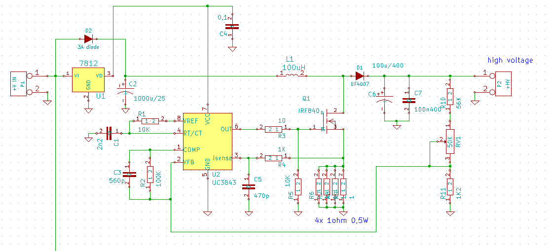

maybe you can try this dc-dc converter schematic
i have tried to boost from 14 to 200v DC.
sorry i cannot say about its performance because i don't have time to continue improving the circuit
you can see the picture on my blog here (in bahasa indonesia)

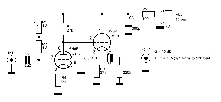

Yes it is, but the available signal level is just some 1.5 Vrms max.
I studied these circuits once and according to my notes the attached circuit worked well.
This kind of circuit needs to be adjusted individually to proper operating point.
There is 1M trimmer resistor at the gate of the 1st tube.
Adjust the cathode voltage of the 2nd tube to 6 V with this trimmer.
That's all the tuning it requires.
The load should be a 50 k volume potentiometer, not smaller.
The signal source should be have low output impedance, but this is not a problem, because today most equipment has.

You can use many typical triodes such as ECC82, ECC88, ECC81 etc. with 12 V supply voltage, but with the limited signal level and low input impedance (some k-ohms) due to grid current required to drive the tube .
This requires that the tube must be biased with positive grid voltage to proper operating point.
During my tests I achieved 1 Vrms output level with 0.3 % THD at best.
Ofcourse the vacuum tubes are not designed for such low +Ub, but they work.
