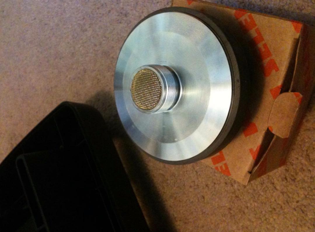

Gotcha, and the D220 doesn't have the deeper throat? And regarding the throat entry for tweeter into the wood horn... make it as shallow as possible and make the transition as smooth as possible; correct?"Deep throat" drivers like the JBL 2420, TAD 2001, Altec (forgot the old #) have a (nearly) narrow conical horn built into their throat, it will "beam" above 4-5 kHz without the vanes to direct the HF outward.

Anywhere to purchase a threaded plate that'll mount the tweeter to the horn I build?

The D220 only has the threaded throat. Is there an adapter anywhere that has the same threads that'll screw to the horn?

Are you looking for something like this?
Selenium ADF25-25 Horn Adapter
Plastic, but I have bought metals ones somewhere. Maybe P.E.

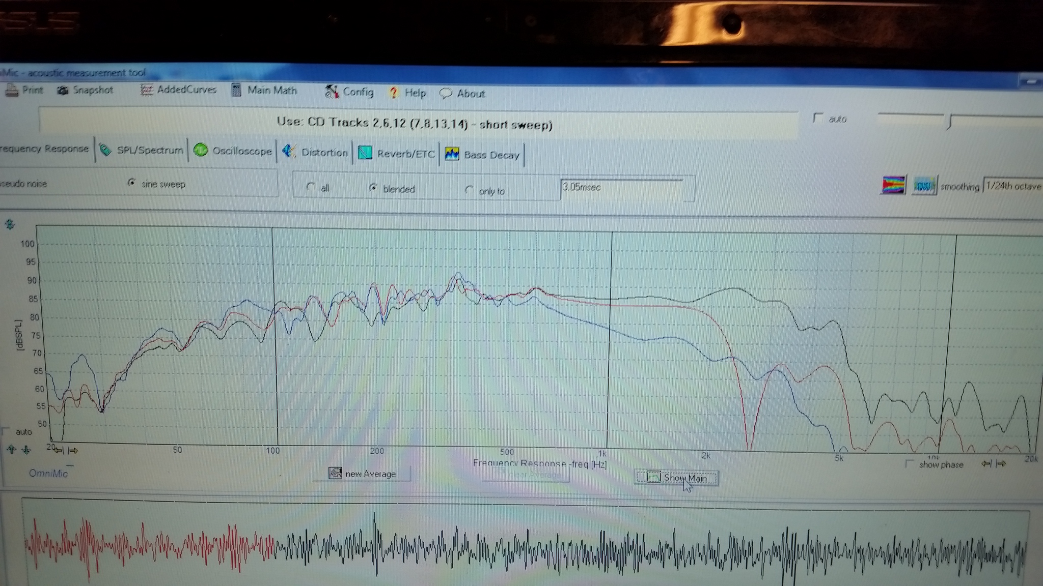

I'm not using the 10", I'm using the 12".
Based on that, it looks very usable out to at least 2k, but I can't know how far until I measure these myself, and get on and off axis measurements.
OK, a 12" is typically ~70 deg/-6/2 kHz Vs ~90 deg/-6/1.44 kHz, so pretty narrow unless you have a long, narrow room. Anyway, looking forward to what the Beta actually measures off axis this high up.
GM
Here are some measurements I took tonight of the 12a-2. Black is on axis, red is 45 deg, and blue is 90 deg. I'm aiming for 1.8k, 3rd order electrical at this point, but that depends on the tweeter. Sorry for the pic, I just snapped a shot of the screen with my phone.
