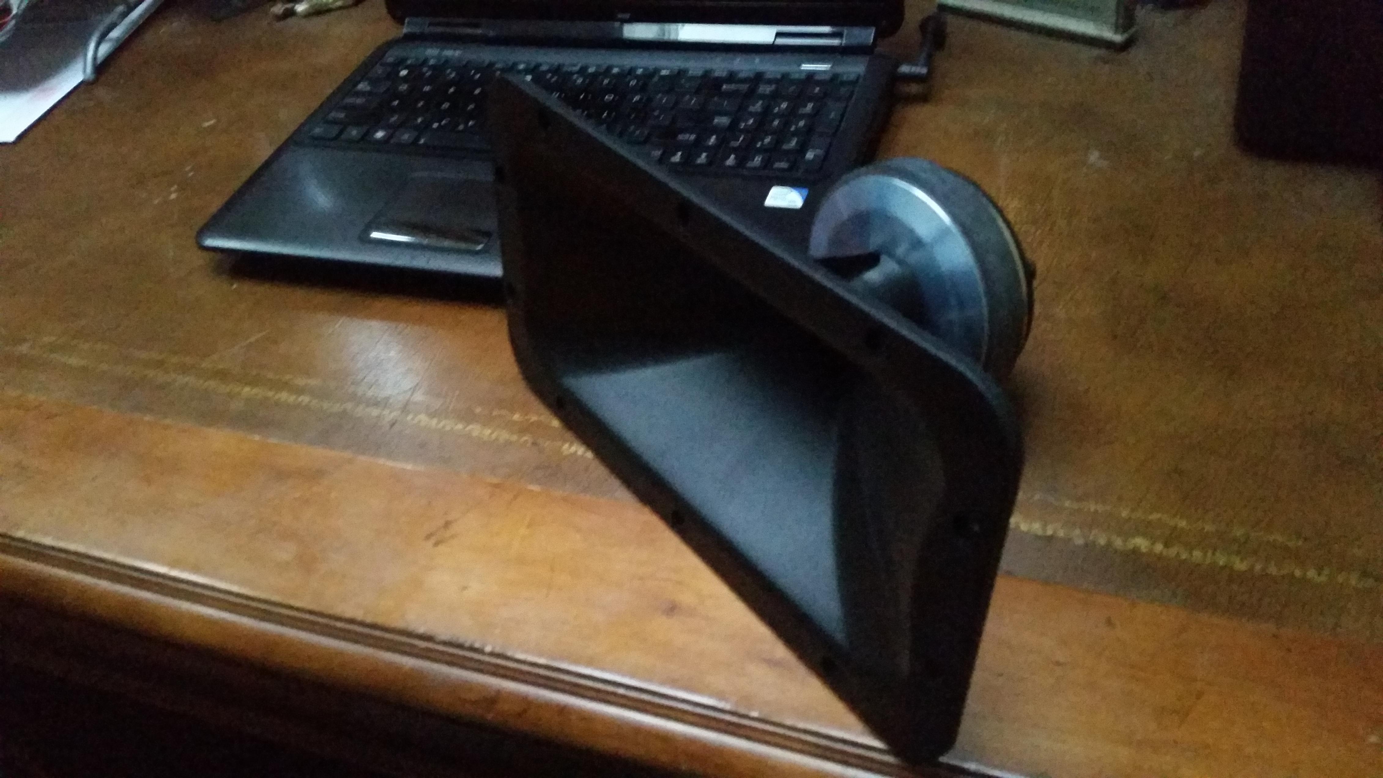

Thanks everybody for the responses. I have this horn lens, plus a larger Eminence lens that's basically the same shape.
I'll measure this and see how it is. As far as the room, these are going to be in my garage / shop, which is 25 x 27. It's actually not as lively as you would think because the walls are lined with hardwood racks, tools, etc. But it does have a concrete floor.

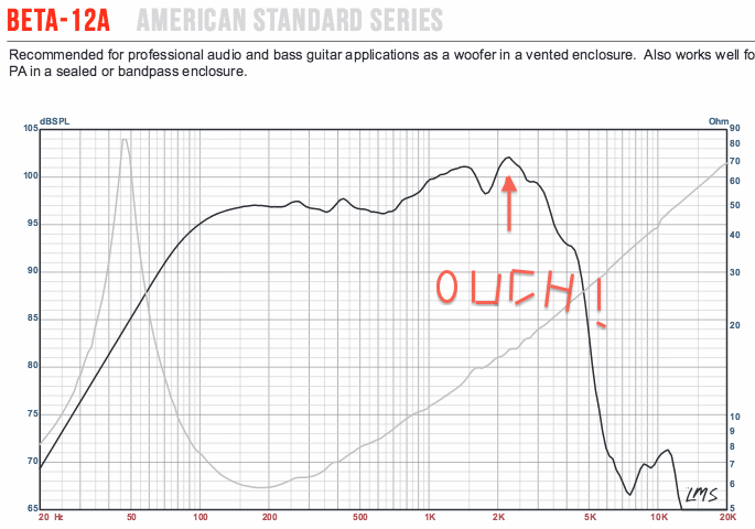

I was told this Beta 12 mid would play out to about 2.5k by a respected individual in the industry. I do understand beaming, and this seems high to me with regards to beaming, but I was going to try it anyhow because I definitely trust this individual's advice. I actually was going to target closer to 2khz from that mid to my tweeter as a starting xover point, but I haven't taken measurements of either the mid or the tweeter yet either, and those will obviously dictate the xover point.

3)I was told this Beta 12 mid would play out to about 2.5k by a respected individual in the industry. I do understand beaming, and this seems high to me with regards to beaming, but I was going to try it anyhow because I definitely trust this individual's advice. I actually was going to target closer to 2khz from that mid to my tweeter as a starting xover point, but I haven't taken measurements of either the mid or the tweeter yet either, and those will obviously dictate the xover point.

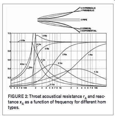

2) This article will get your feet wet regarding horn profiles and their "loading", ie what happens at the lower end of their response curve:
https://www.grc.com/acoustics/an-introduction-to-horn-theory.pdf
I lifted the diagram of horn types below from it.
3) "Play out" is not the same as "sound good" a play can end in a tragedy or a comedy. Given a 1.75" diaphragm 1" exit driver and a Beta 12 I'd probably be looking at around 1500 Hz crossover. An example below is an Eminence Kappa 10 with (my own plywood and putty) 90 x40 conical horn with secondary break, crossed at 1500 Hz it required the 10" to be "shuttered" to get it's dispersion to match the horn's 90 degree pattern at the crossover point.

3. This I understand. The guy that said these will work out to 2.5k actually meant they'd work (not just "play out"). I'm definitely not debating this or saying anyone is right or wrong though, all I have is his word. I did do a build in the past using an Eminence Beta 10 with a compression tweeter threaded to the back of that and that was crossed at about 2.3k and they actually sounded amazing. They obviously struggled to dig very low in the bass region, but the mids and highs were incredible.

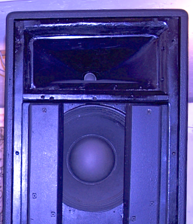

I'll measure the Beta 12 I have and see where it wants to be. This is that build I did, it was a kit from Meniscus Audio...
