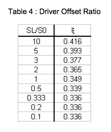

Oh, I see. So the mounting of the driver would need to occur in such a way that the drivers is perpendicular to the line.
At the frequencies involved perpendicular has no meaning. The driver taps into the line, ideally at the optimum offset. This is refered to as the Zd.
dave
dave
The optimum offset is determined by playing with the software. In the basic TLs that the tables & the SS calculate that optimum offset has been figured out for you. It is a table that gives the offset as a farction of the line length from th etop of the box that is based on the taper.
You need to have read & use the table article to take full advantage of the SS. On 1st glance it looks like the term Dz (in the SS) is used for the offset, but the number doesn’t quite jive with the table, perhaps further optimization since the tables article.

I'm not seeing this software. Planet10, what is that table from?
It is from the paper that the spreadsheet is derived from… on the same page you would have downloaded the software from… Has the word table in it.

I got mine from here: Transmission Line Theory
It is titled, "Alignment Tables Spreadsheet by Keith Webb (Excel 3/03/09)". However, I don't see any Offset section. There are 3 tabs at the bottom - one is "Print Here", and the other is "Empty Page"
But there is a Dz cell. You cannot really use the spreadsheet without reading the pdf from which the software is derived, the link before the SS called "Classic Transmission Line Alignment Tables”. Most of the meat in Matrin’d work is in the pdfs… you need to download them and read them.
dave
dave
Already have them, have been reading them... I'll go back and give it a second look.
