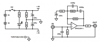

So, I've bought a set of PCBs from chipamp.com and have planned to build some sort of amplifier setup. But I thought I'd start with something a little smaller. A RIAA compensated preamp for my darling SL-1210II. I'd like to make it tiny and simple. The phono preamp at paia.com caught my eye. Simple construction (but is it any good?) with only a few components in the signal path. I was thinking about making a sort of hybrid between this and the CMoy headphone amp. Basically just using the CMoy PSU.
I'd change the value of the caps as suggested in this thread:
http://www.diyaudio.com/forums/anal...thout-confusing-riaa-stuff-2.html#post2089453
and power the amp with two 9v batteries.
Will 2x 9v be sufficient, or will the amp suck them dry in no time?
One question I have is about grounding. There's both the ground wire from the turntable, the two signal grounds, the chassis of the preamp and the zero volt line between the batteries. Which of these should be connected to each other?
I'm also not quite certain about the value of the 220uF cap in the amp filter network. As far as I understand, it needs to hit a good compromise between a tolerable bass definition and a decent rumble filter? Would 100uF be a better choice?
Please let my know if I've missed anything vital 😀

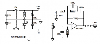

Your batteries will not last long. It is better to connect GND to the center of the batteries and remove the 4.7k resistors, also use a two-pole switch. The 220u capacitor is sufficient, in fact anything above 22u would do.
So this would be a better design:

You might want to DC couple the input (eliminate the 220uF electrolytic) and place a blocking cap (10uF) on the output -- this will save space and improve the performance at the low end. You can make the amplifier a little less noisy by reducing the resistor values by a factor of 6, increasing the capacitor values by 6. -- and if you use 5.8 you'll get the exact values in Jung's "Op Amp Handbook"
But the amp is DC coupled (both input and output)?
Too late. I've already bought most of the caps 🙂
