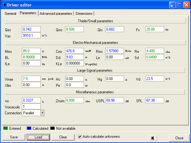

I have been trying to enter it into WinSD however I cant get it to work I am missing some info.
I am mainly missing:
Hc, Hg and Pe
CMS
Dd
RMS
Everything else is filled in fine.
Got any ideas?
This is the problem:

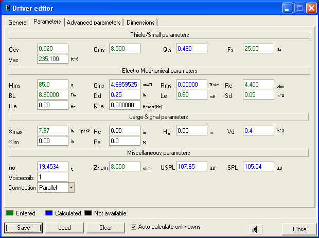

I then re-entered all data in the suggested order but was missing those details.
After trying it all It auto calculated all those details, except RMS.
Anyone see problems?
Thanks,
Zac
P.S. I tried 150 RMS which is what I think may be right and it displayed the same problem notice...

Your Vas is wrong (way to big) and does influence other parameters as well, so does Sd 0,05 in^2 seems a bit small (SPL and No are totally off). Perhaps you should check the units used in the sheet and change them accordingly in WinISD.
Rms is a mechanical parameter, it isn't and has nothing to do with the (rms-)powerhandling. However Pe is the electrical Powerhandling (in Wrms).
Hc, Hg aren't necessary, they're used to calculate Xmax, Xlim can also stay blank.
With kind regards Johan
