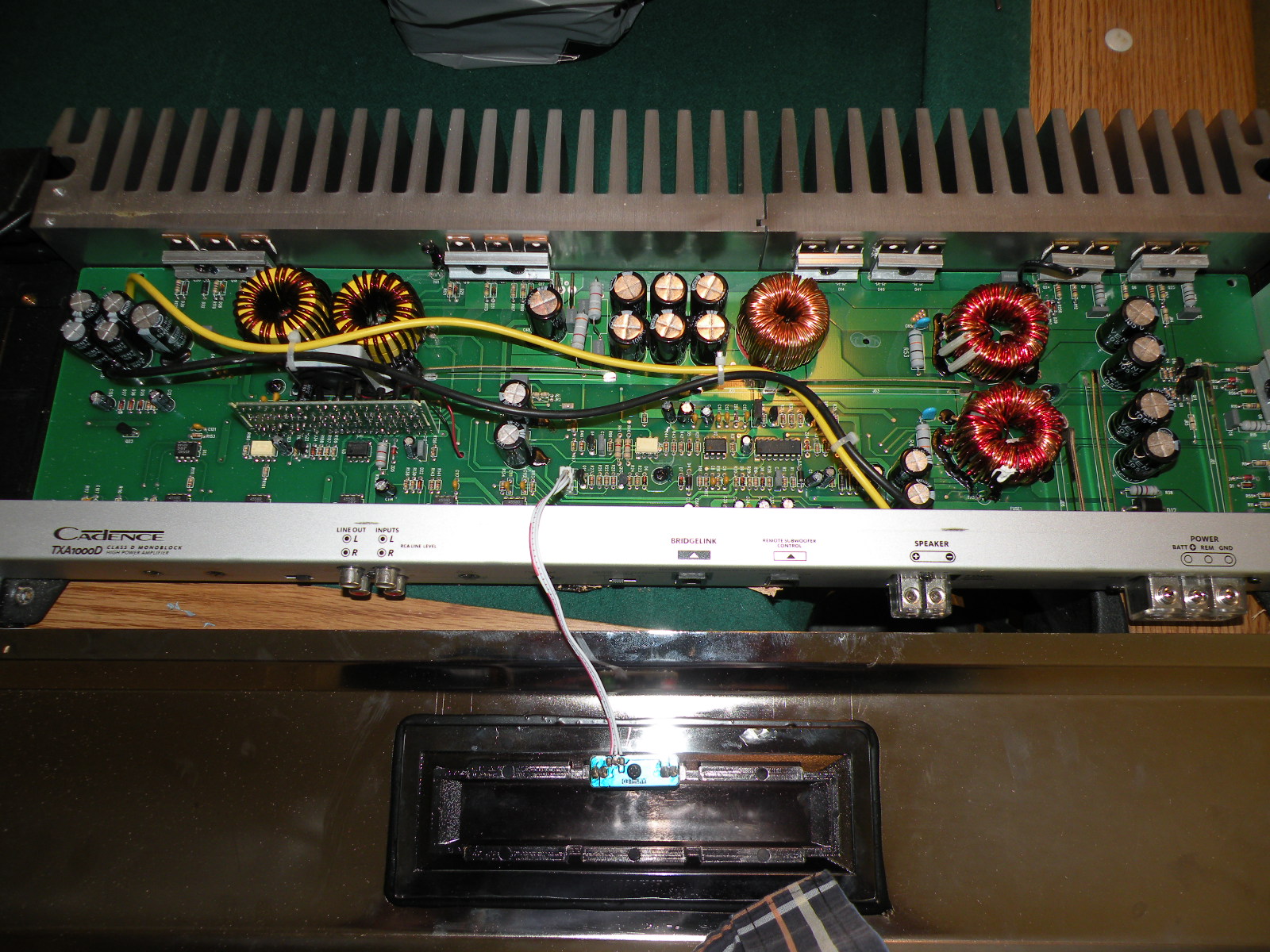

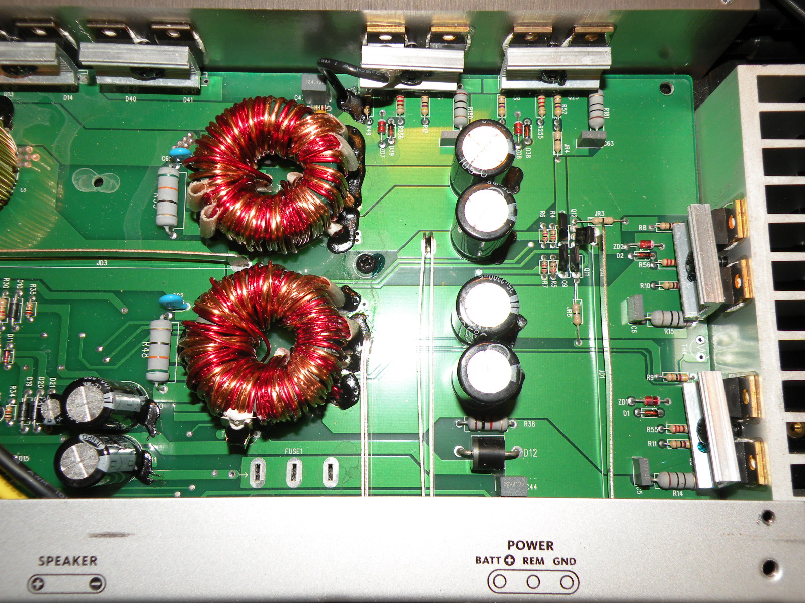

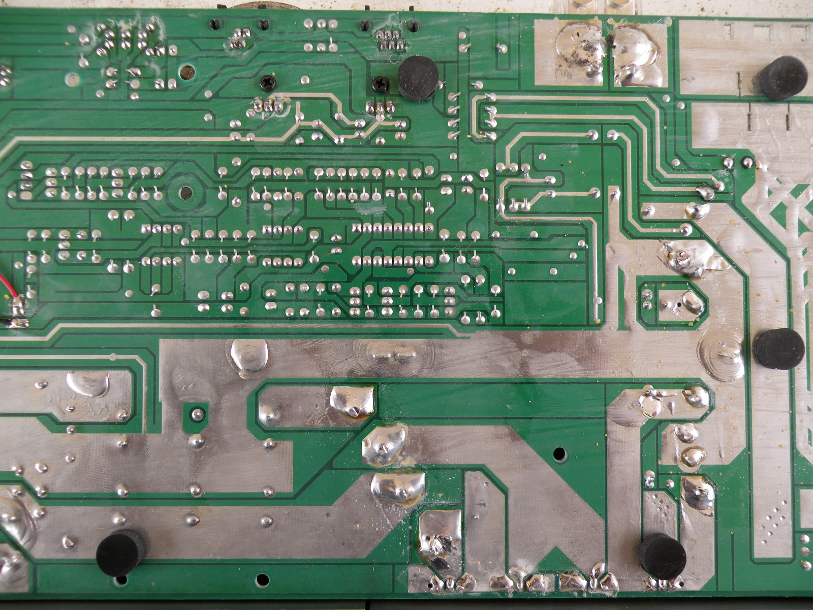

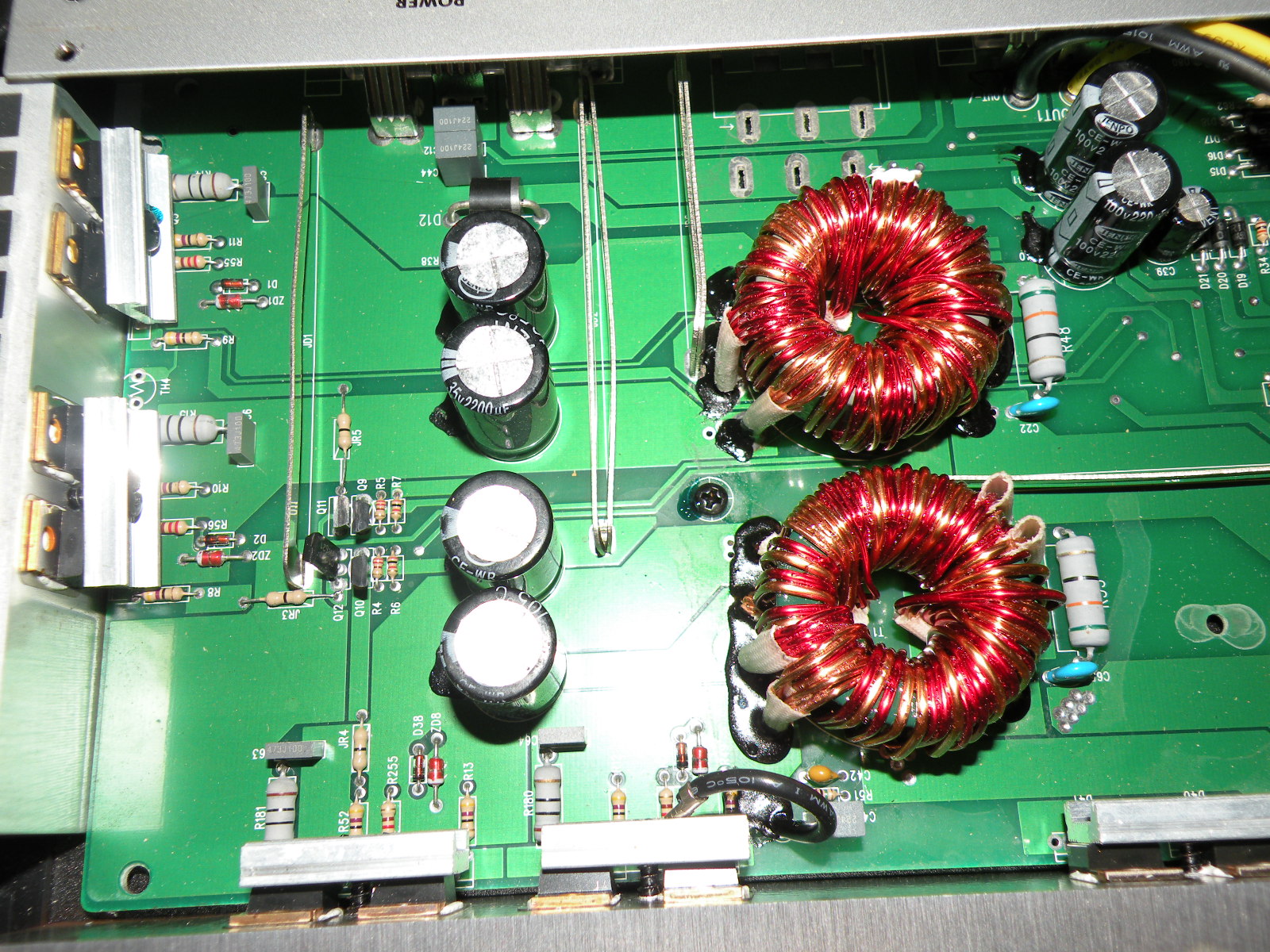

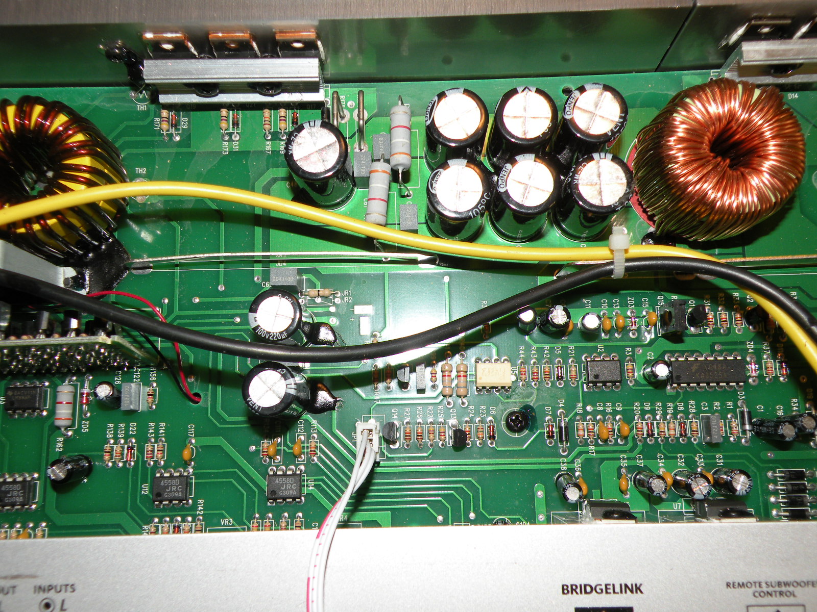

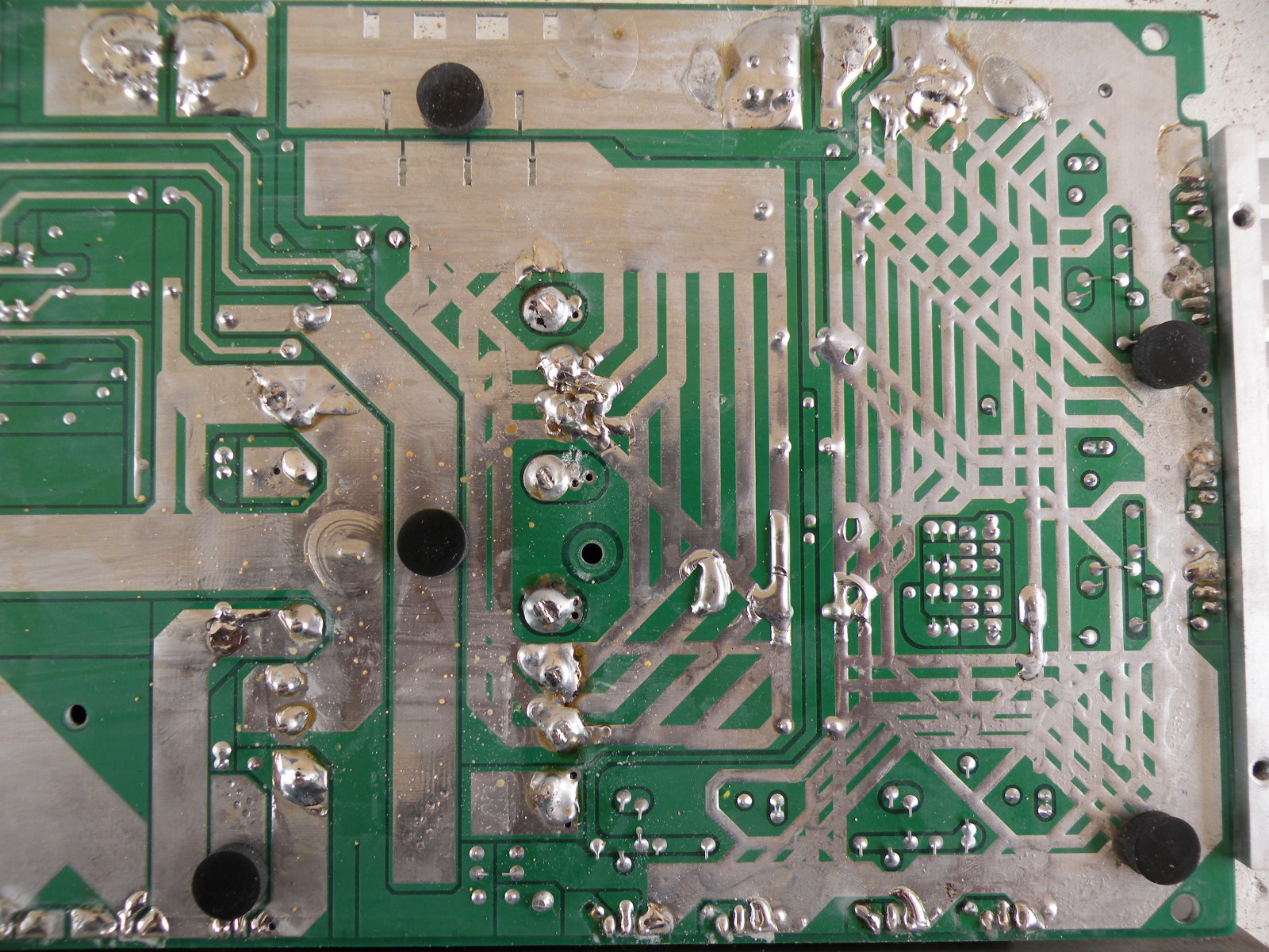

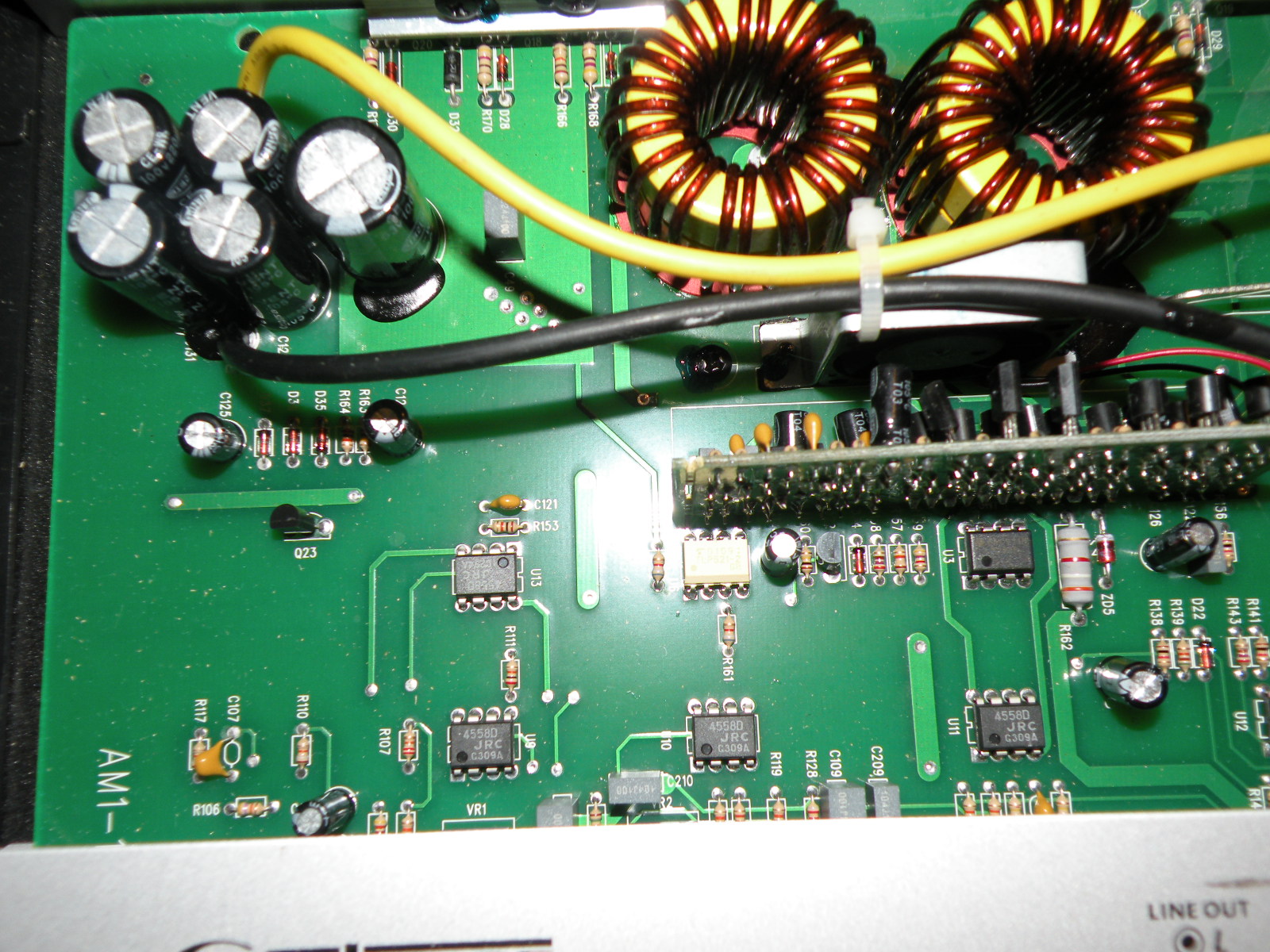

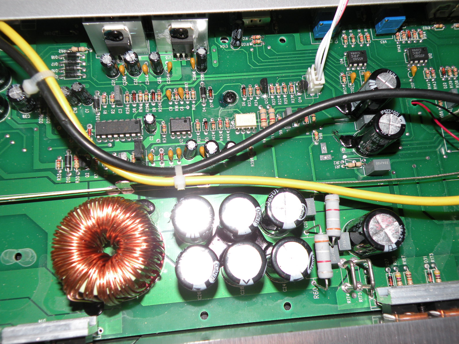

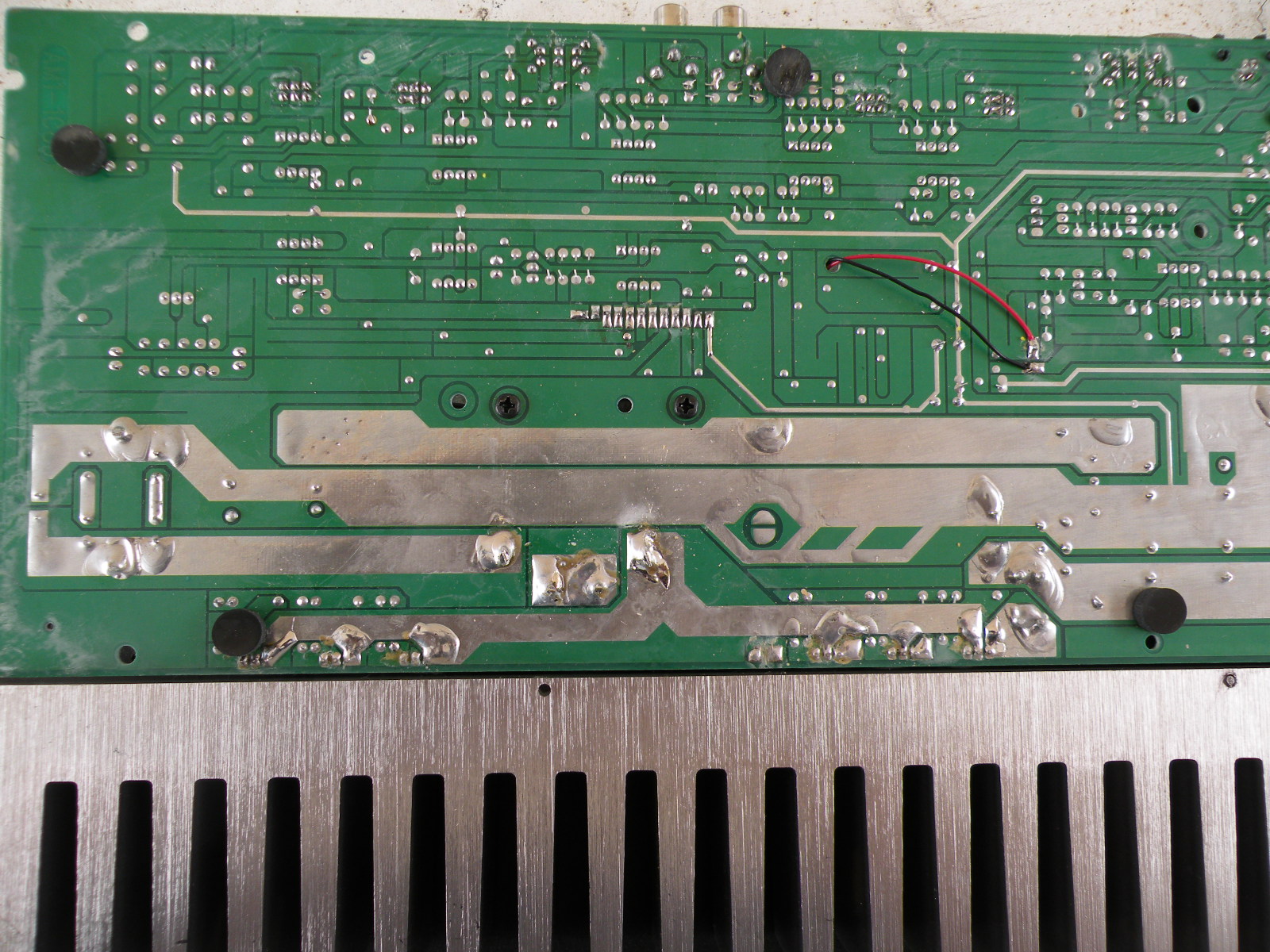

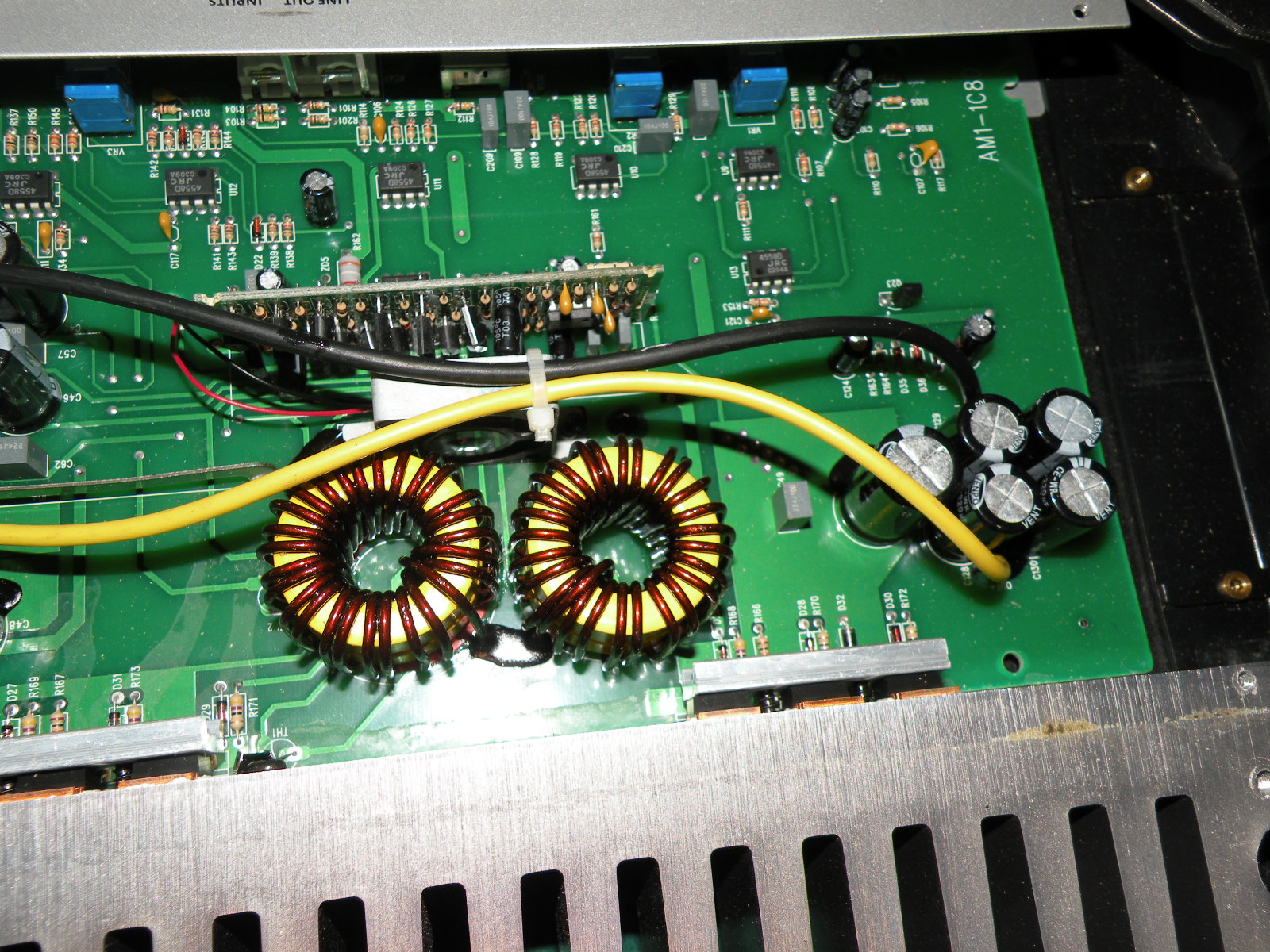

well here goes:
i have a cadence txa-1000d 1000w @ 1ohm amp (i believe 700w @ 4R).
the problem is that the amp will just not turn on at all. sometimes the green light comes on indicating that the amp is on. sometimes it does not turn on. in any case, there is no power output to the subs. i have not measured anything because my multimeter can only measure up to 10 A so it would fry it basically.
i have posted some pictures of the amp internals, and from what I can see there is nothing burnt, browned, melted, discolored, no broken transistor legs, nothing seems out of the ordinary basically, but then again im no expert. so maybe these pictures can give you a hint as to what is going on.
what things should I look for and how do i go about testing this amp? i know it is hard without a schematic, but i will try and look for one.
thank you.

ok, anonymous you win. maybe i am getting in a little over my head i still dont want to quit on this.
Well, that's not what I was after. I was just trying to be the voice of reason, as I've been where you are and wasted a lot of money and destroyed a lot of good components.
You should start a new thread in the car audio forum for your amp. There is a very nice and knowledgeable fellow there named Perry Babbin. If he can't help you fix the amp, no one can.
