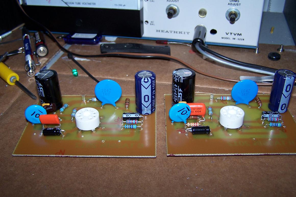

Both boards have been stuffed, and tested. They work to my satisfaction.
I have learned from this effort. I replaced some caps as was suggested.
Next project is to build a stereo version of the RH-84 power amp to run
the pre-amp into. I have a PC board for that project also.
Thanks to all who helped.

Very Cool.. 😀 At some point in the future have a look at replacing those ceramic caps with polystyrenes - they should be significantly less microphonic as well as generating less distortion.
Excellent work Bruce. If you have a residual hum at loud volumes you can shield it with a metal box. Poly caps in the RIAA will make it sound really great too of course.

look good. Some grommets where the wires pass in to the chassis will protect them . This is great for a first try at a phono section . Regards

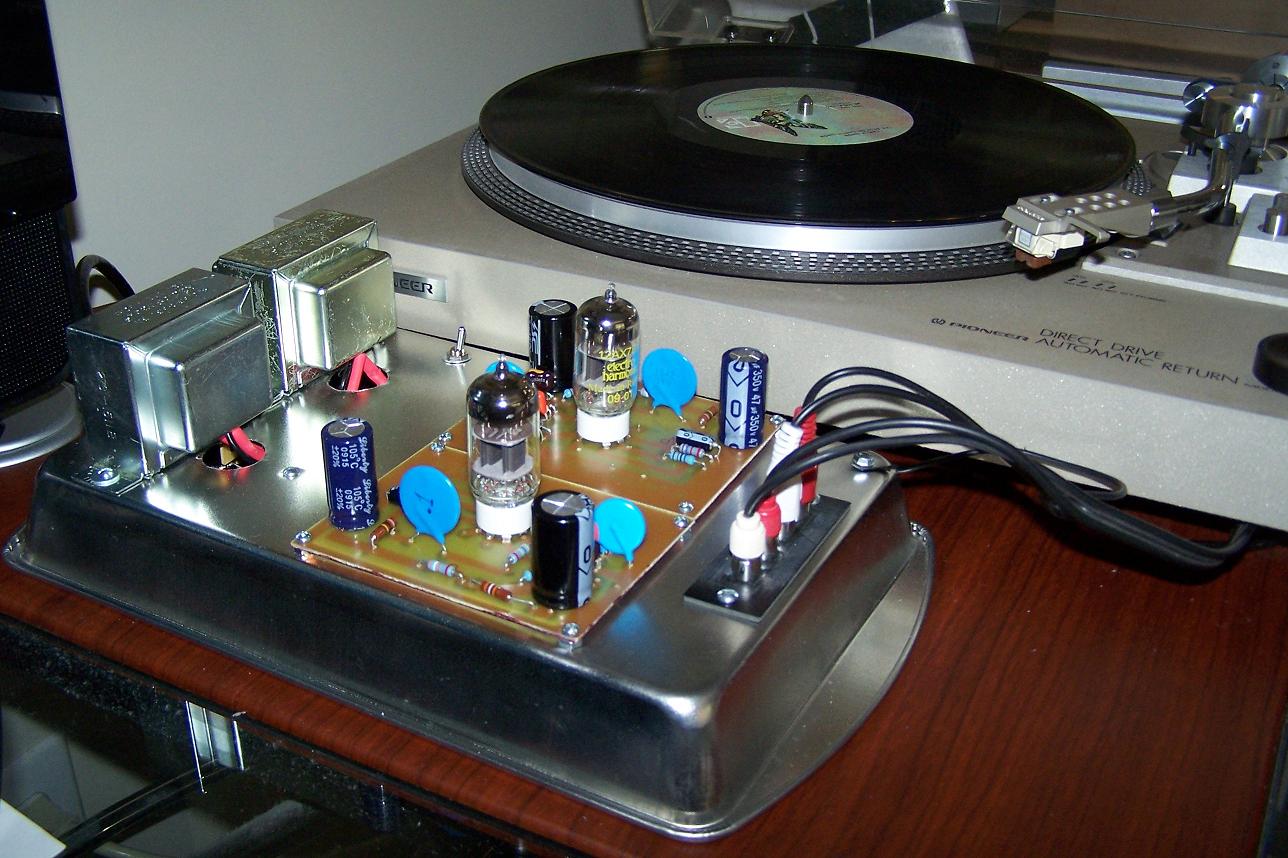

A photo of the finished amp.
Nicely done ! (if it's not too late to say so).
I am seriously thinking of making one, I have the original manual RCA and all contributions are most useful
My congratulations also never too late!
If you are going to build the RCA based circuit please have a look at Eli's posts here about a much improved and revised version of the RCA circuit - it will perform a lot better in the real world than the original tube handbook version does.
I built one. It was a good experience. See post #21 and #22. If I were to do it over I would build Eli's modified version. If you want to do a PC board version, I will let you use my PC board design. Just let me know if you want it.

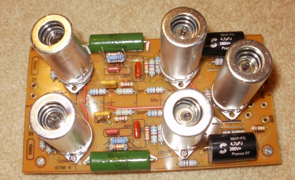

I´m happy to find this thread. Normally i did not use pcb for my little self made electronics, but in this case it would be great. Maybe i´ll use the shown layout of the thread starter, without modification 🙂. It has to work on a stereo ECL 11 Tube Amp.
But what about the power supply?
Contact member Jeff Yourison for the schematic of low cost, high performance, PSU.
