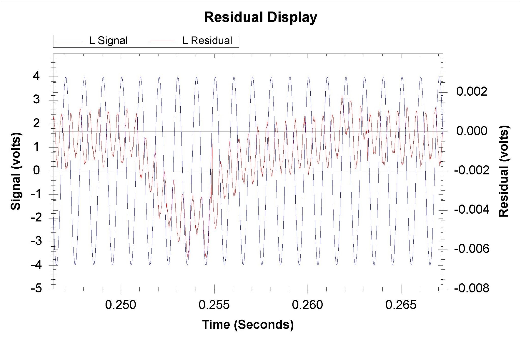

I am just now starting to get my feet under me when it comes to understanding some facets of even the most basic measurements, how to do them properly / consistently, and most importantly how to understand and apply what I see in all the pretty, pretty, pretty charts and graphs.
I ran into something this morning that I haven't seen before, and it fascinated me. I was measuring my first "real" amplifier that I got back from a friend recently. It carries a lot of nostalgic value to me. So, I was going to put to use all my new and wonderful DIY knowledge, clean it up and possibly give it a refurbish. I am reluctant to even recap a commercial amp, so I wanted see how it was currently performing. Overall it seems fine. 0.00 VDC offset, stable for 24 hours, and basic performance measures seem in-line with expectations.
But...
Here are a few plots of the distortion residual. The reason they're not really tight across just a few waves is that when I was watching it "zoomed out", it was clearly varying in a pattern over time, while the signal remained stable. The software sets the scale for the residual vs. signal automatically. So, the residual isn't varying dramatically (relatively speaking) over time, but it does "swing up and down" in a pattern.
In all the vastness of experience (HA!) I have measuring 6 or 7 other things around the house for fun, I haven't seen this before. All the other amps are FW clones, a BA-3 variant, and my Sony VFet. For all those amplifiers, the voltage of the distortion stayed 'flat' for lack of a better description vs. the average across a few ms wandering up and down. I wish I could describe it in more accurate terms. I can take a video also if it helps. This amp may have a servo. I am wondering if this type of behavior is associated with a servo correcting for offset... (The amp is an Aragon 2004 from circa 1995).
Why do I care and ask? I'm curious, and I haven't seen this before. We tend to look at "static" images of the residual and/or the FFT. Since I typically go with the idea that what we distinguish in amplifiers is mostly due to the distortion (all other things remaining equal)... I was wondering if I was off my rocker. If we accept or consider that a few mV of distortion with a certain pattern against a much larger signal affects our perception of the sonics of an amplifier... I am wondering if the distortion profile "wandering" up and down is normal for some amplifiers and its potential effect.
Listening tests with my ears likely won't reveal too much, but I've become fascinated with "what the distortion looks like" in a manner of speaking. Possibly a rabbit hole not worth diving into, but ...
Thanks in advance for any insight and ideas for how to understand what's happening and why...

Thank you for the quick response. It's still hooked up to the analyzer, and I'm happy to measure some things, but please forgive my ignorance on the topic.
Are you asking for what the noise floor looks like? There's not a clear residual for that. Here is the FFT. The analyzer and a scope will clearly pick up the 60Hz mains and harmonics. Is that what you're asking? Mainly I want to try and answer your question as clearly as I can.
Apologies, I can't title each graph for the residual. Thank you for asking. Those were taken at 1W @ 8R => Signal 4Vp. Not close to clipping. I haven't measured the clipping voltage dead on yet, but it measures (relatively) flat in THD out to its 100W 8R rating.

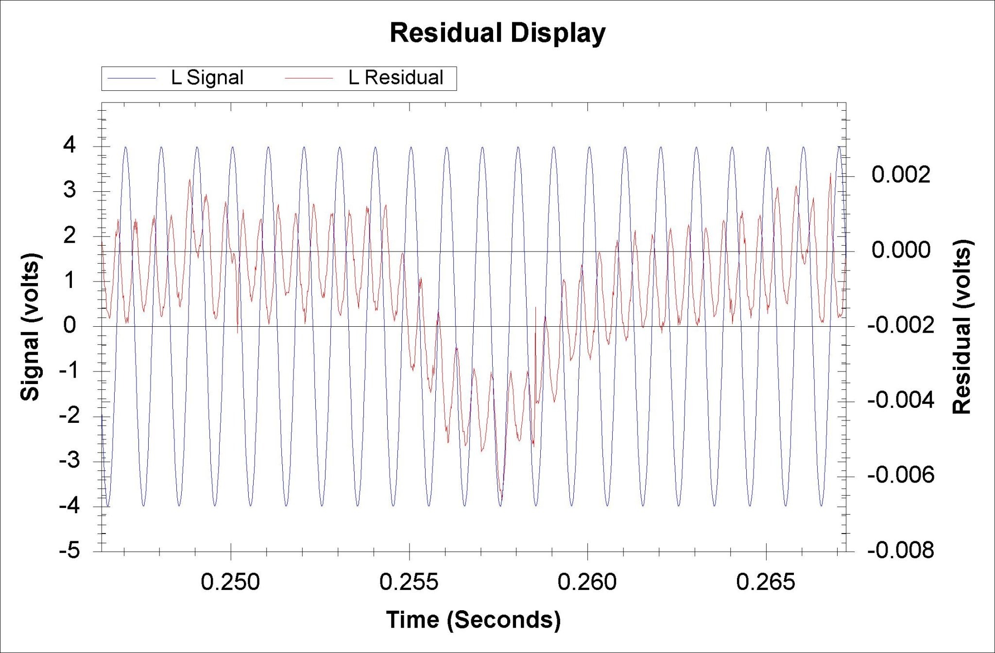

WAIT! I think you were trying to give me a clue.
Doing some back of the matchbook math... and taking a closer look at the plots....
Roughly... 8:1 ratio of the periodicity of the signal to the larger wave of the residual... 1000/8 => 125.
Is it a possibility / likelihood that since the actual harmonic distortion of the 1kHz signal is comparatively low, and the instrument sensitive enough, that I am seeing the effect of the mains harmonics in the residual plot?!
If so, thank you for the hint and making me think for myself. If not... I'll keep noodling.

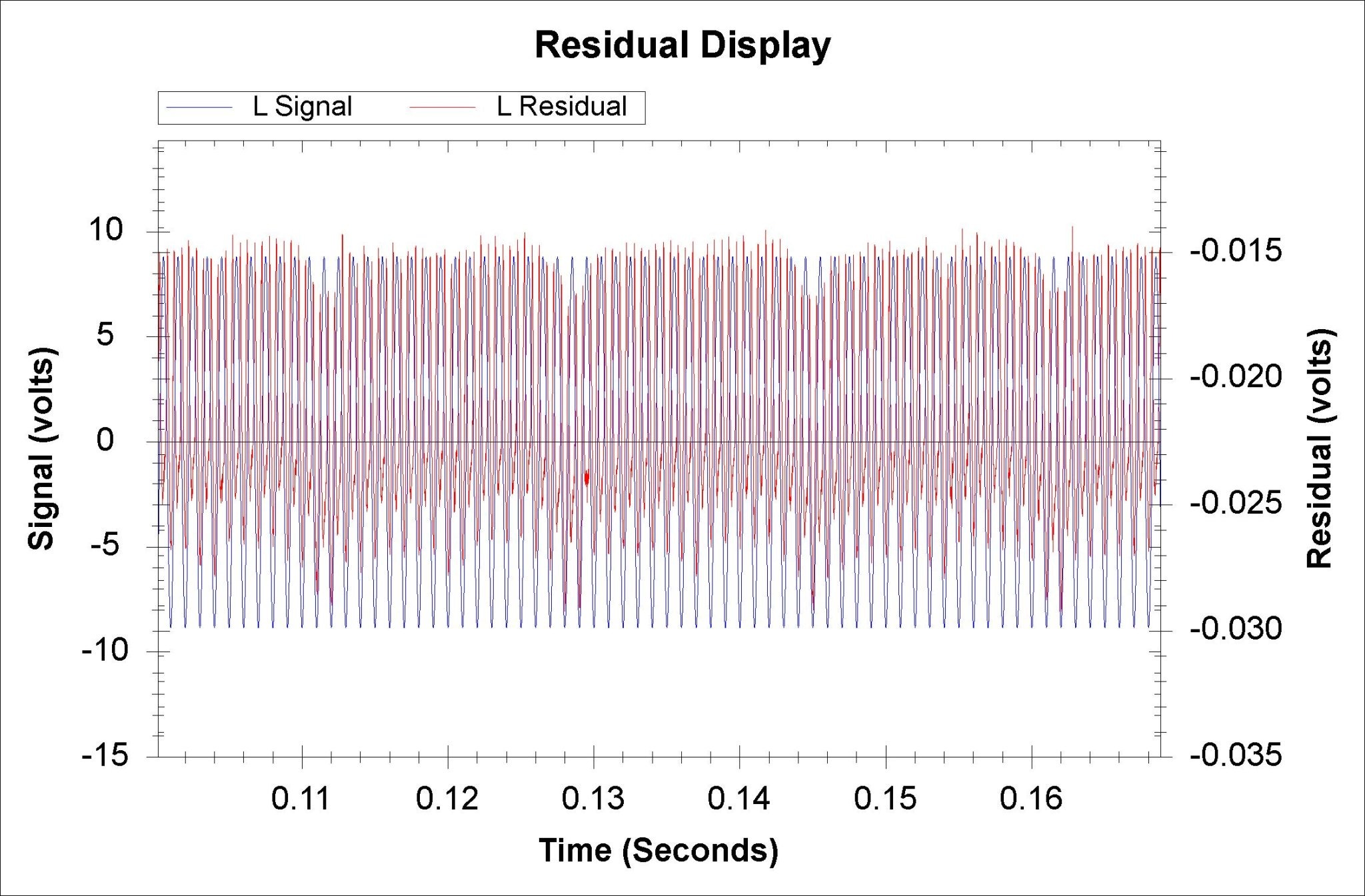

Ran one more check... I think it is what you were trying to clue me into...
I upped the signal and zoomed out a bit more. I happened to do it while I was checking the performance at 4R.
A (roughly) 16:1 count seems easier than trying to determine the exact periodicity of the waveform...
So... it would seem that the distortion (and who knows, possibly the signal too, but the scale won't let me see it) signal rides along on the 60Hz mains frequency and harmonics.
NEAT! (If I got it right)...

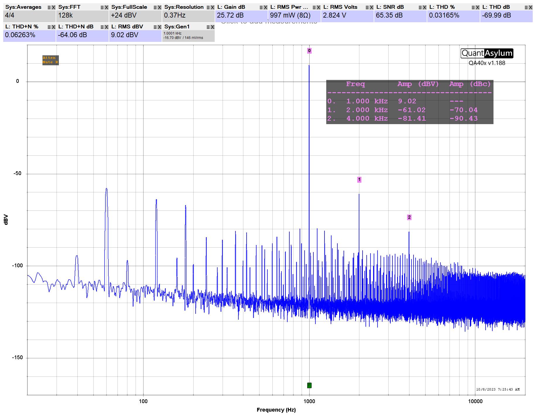

@ItsAllInMyHead I hadn't a clue it was severely distorted mains hum, you are the one who figured that out. It just looked like something added to the distortion residue to me, hence the question what it looks like without signal.
You interpreted it as time-dependent distortion. The only thing I could think of that would cause that was supply variations, and those should have the biggest impact close to or in clipping. Hence the second question.

By the way, I agree with what Zen Mod implied in post #6, namely that it is likely to be a silly ground connection or some other layout imperfection causing crosstalk from the power supply charging current peaks to the signal path. That would explain the waveform of the mains hum in post #1 and the huge number of intermodulation peaks in post #4.

Start with technical fun... that also explains (possibly) why the channel (left) physically closest to the PSU wiring and the donut has slightly poorer performance. See attached. I've been having fun.
