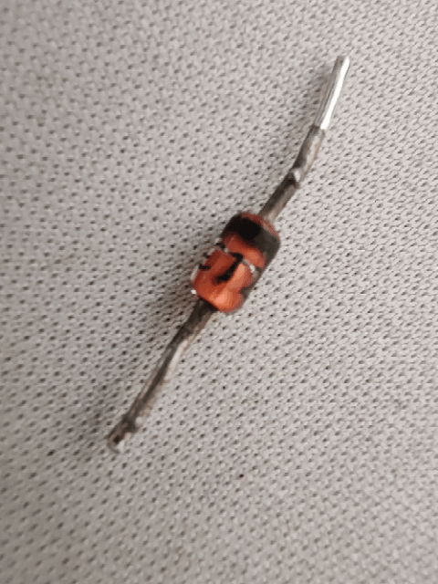

I have the same amplifier on my bench with a similar issue. I have one of the dioded faulty but cannot figure out a replacement. On the diodeds it says CJ2PH. Does anybody recognise this value?
It looks like a J to me - CJ2PH. If you look at the circuit atthe bigining of this thread you can see the position of the diode. It looks like a clamp configuration to me. I suspect a schottky diode but not sure. It is a small glass diode.
See photo
