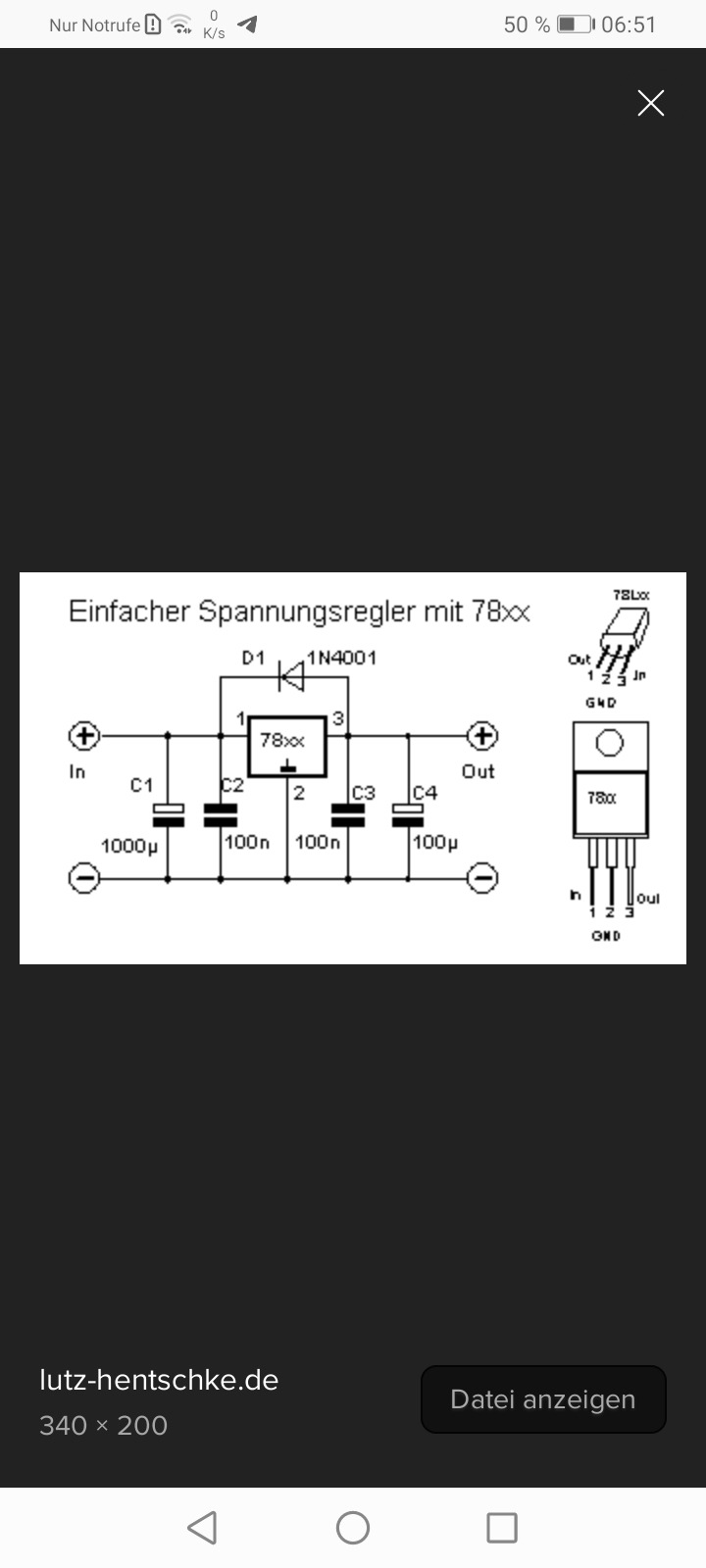

One tip.
Very often also in expensive gear the regs have no capacitance between their legs.
If 78xx regulators in the dac are used. It's written in the dstasheet that kerkos (ceramic condensers 0,33 mfd) are important for stability. Putting them in makes impulse response much better.
