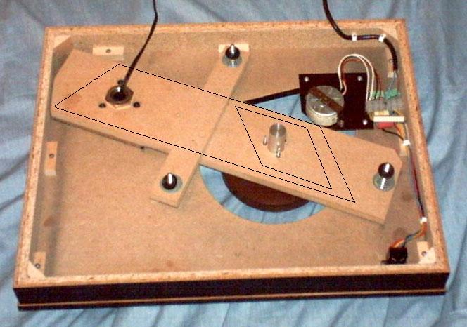

Here is an underside photo of the CJ16
http://img4.imageshack.us/my.php?loc=img4&image=underside1.JPG
I sure would like to know how to improve the suspension springs - that foam is beginning to crumble and I'm sure it provides no benefit whatsoever.

I see you've already cut the "tie", 🙂 sreten.
P.S. it would clean up nicely with some car spray paint.
