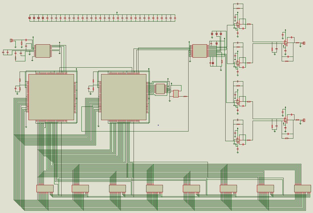

Circuit description.
The circuit as drawn consists of 2 sections which alternately access a 4-bank RAM buffer. This number of banks is not absolutely necessary, but made the design easy the first time around. It meant I could ignore read/write clashes.
A conventional SPDIF receiver provides the clock and data to a free-running serial to parallel converter implemented in a Xilinx CPLD. This fills up the banks of RAM one by one. When the last is full it starts at the beginning again. Every time the address being written hits zero, the CPLD puts out a bitclock-wide pulse.
A second CPLD runs off a 256*bitclock VCXO. It reads the zero pulse and synchronizes itself with the first CPLD. It also measures the interval between pulses and adjusts the VCXO frequency which it controls using a DAC. Reading from the first buffer only commences when the third buffer starts to be written. The second CPLD reorganises the data into a serial bitstream with bit- and L/R- clocks. The fourth buffer prevents any clash of accesses between the CPLDs, although this is a belt-and-braces measure, since the accesses are staggered and the busses tristated when not in use. A less hardware-hungry version is possible. Identical CPLDs are employed as again this cuts down on the design effort, but the receiver will fit in a smaller one. Looking at this with the hindsight of a couple of days, I can reduce the the number of RAM chips to one...
Each buffer takes just over 2 million of the high speed clocks to fill, a clock pulse therefore represents ~0.5ppm. The VCXO DAC is12-bit, the VCXO is pullable by about 200ppm, and each DAC LSB therefore represents ~0.05ppm. After an initial coarse adjustment the VCXO is adjusted one LSB every zero address, but it should settle within seconds.

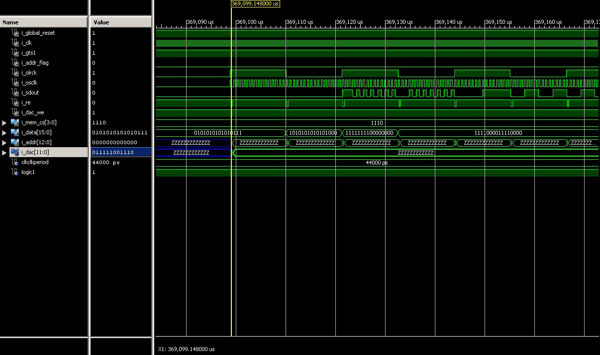

The VHDL is shown here with testbenches. These can be observed in operation using the downloadable Xilinx ISE tool. A small image of the schematic is also shown, but it is too small to show detail and a zipped .pdf can be downloaded if detail is required. The implementation shows a PCM1794 DAC and a Tent Labs VCXO, but anyone contemplating building such a thing should be aware that the diagram is an unproven sketch, and further review will be required before a working model could be produced.

Some VHDL
This is the SPDIF receiver. Damn forum has messed up my formatting.

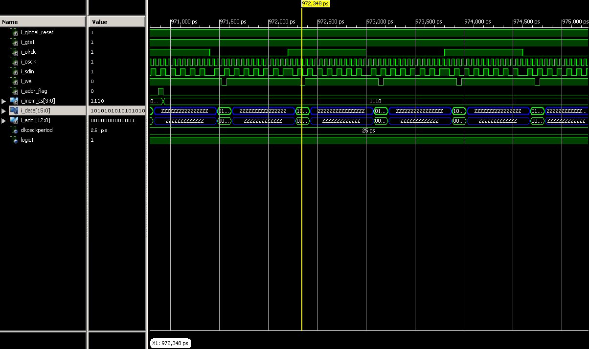

And the testbench for that:- (this has an arbitrary 25ps clock)

Here's the behavioural simulation, I've done the post-fit, but it takes ages to repeat. You can see the address flag just before the address goes to '0000000000000' and the serial input data '1010101010101010, '0101010101010101' and the write enable latching it into the memory. There's plenty of room for a read by the other CPLD (tristated, 'z's) before the next write. The data is written one L/R clock behind it's reception.

tx testbench, behavioural sim
Here you can see the staggered reads and the clock DAC value changing due to the interval between ADDR_FLAG pulses which I've manipulated in the testbench. Again the transmit data is delayed by one L/R clock from the read.
w
