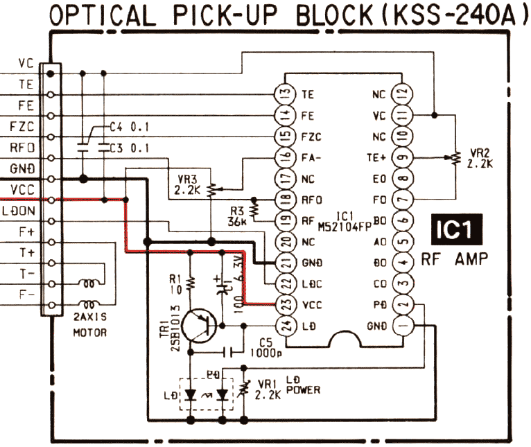

I'm working on a dead Wadia 21 and I am betting that the laser is dead but how do I tell for sure?? I have read many post's about the Teac servo boards having problems.
Symptoms, Insert cd, sled traverses towards spindle, tries to focus 3 times then sled moves to end of travel away from spindle. disc never spins.
I used my cell phone camera to look at the lens while the laser is trying to focus and weakly i can see that the laser is in fact turning on and off.
I have verified that all supplies are working and that the proper PSU voltages are present at each IC.
The spindle motor works when an external voltage is applied. I have traced through the TEAC VRDS T1 schematic (which is very very close to the TEAC board in the 21) and no spindle signal is sent to the spindle motor controller from the Sony CXD2500 IC. But it appears to brake if you spin the disc by hand and open the tray. So I am assuming the motor control circuity is ok.
I see no RF coming out of the laser transport board. I am assuming it would only be seen if the disc was playing.
So the question is how do I determine if in fact the laser is just so dead it can't see the disc??
Zc
Look for a low value resistor in the laser power circuit that you can measure the volts across and determine the current. Typically around 46 to say 55 milliamps but is pickup dependent.
I would expect to see RF signal of some sort if you spin the disc by hand while the laser is lit (during focus search). It may only be a "bounce" in the level but you should see something.
I did find a schematic of the KSS-240A block IC that shows a 10 ohm resistor. and a KSS-240A service bulletin that is interesting.

Yes, the disc won't spin until focus is found. Its easier focusing on a stationery object. I would have though though that if you looked at the RF test point during this time and did spin the disc by hand you would see some kind of output bounce. It might "prove" that at least there is some "laser light" emitted. When laser diodes fail or are fed a lower than normal current they can still emit light but they function more as a side emitting LED rather than a laser. The laser action occurs rapidly and dramatically as current increases past a critical threshold.

OH YEAH! this laser is TOAST! I disassembled the transport tonight and pulled the laser block out and right away I could see that the circuit board under the three trimmer pots was discolored. removing the circuit board shows the transistor that controls the laser and a resistor next to it is burned to a crisp! not charred but very very discolored and obviously overheated. so yeah, new laser time.
