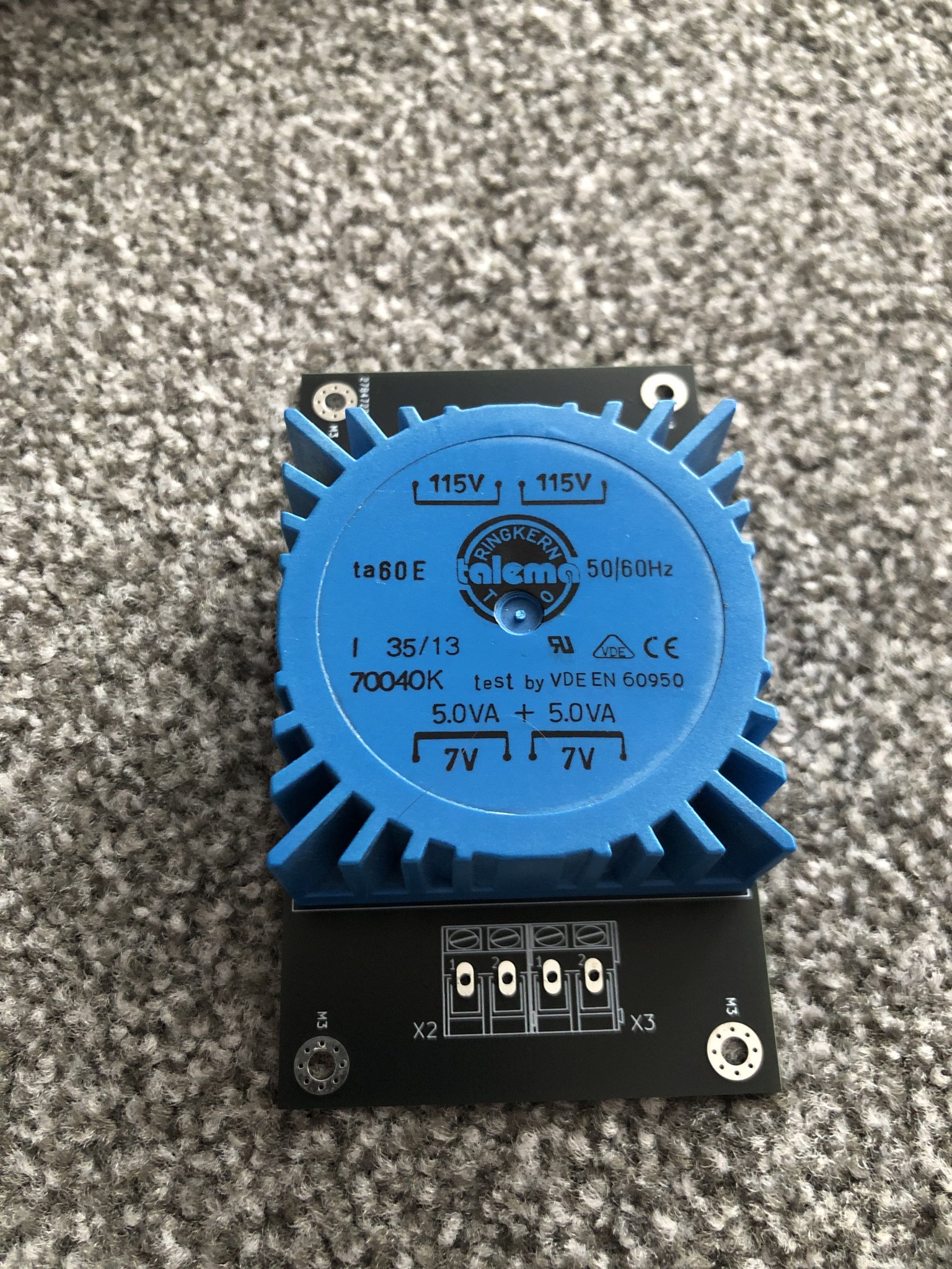

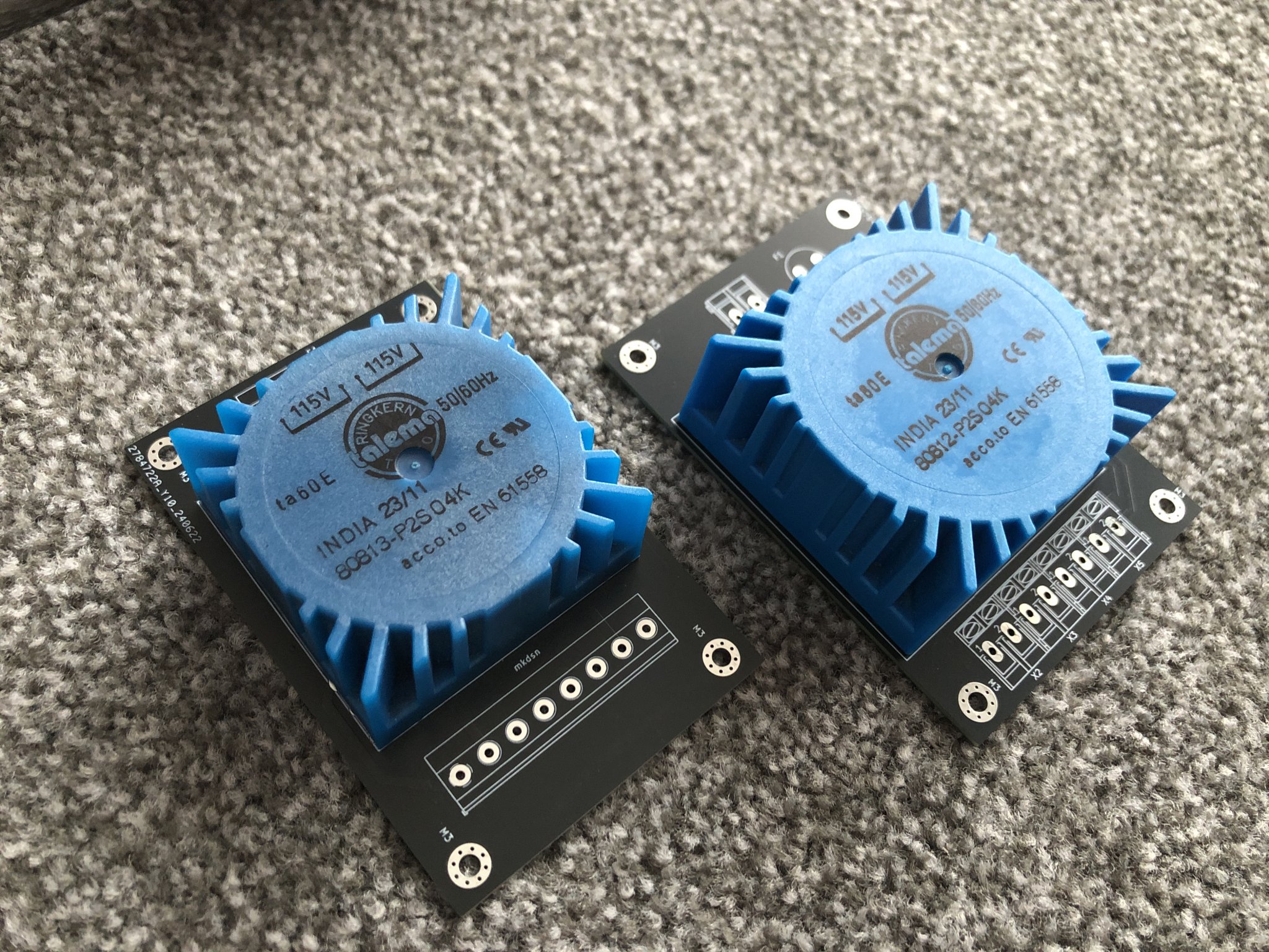

Coincidentally I have designed a PCB for the aforementioned custom transformer with regulated +/- 15V, +5V with an LDO regulator and +9...12V for a similar device with acceptable losses. A PCB with just the 4 AC voltages I have too. For a second custom 7VA type with 4 separate 4..6V windings offered by that seller I also designed a PCB. If it helps you you can have one for shipping costs. Wired for 230V mains voltage.
The 10VA AC version is 65 x 90 mm. The 7VA AC version is 57.5 x 90 mm. For the transformers themselves and their voltages please check the provided link.
DC versions are not produced yet. I implemented a stupid but popular feature by using an (obsolete) dinosaur symmetrical low noise regulator that I still stock in numbers. Idea is to change to another regulator. Or just do the 2SK170/2SJ74 trick? 😉
An AC version for the standard Talema 700xxK (10VA) with for instance 2 x 7V is also ready. It measures 57.5 x 99 mm.
All have plated through M3 mounting holes, sturdy PCB tracks, 5.08 mm pitch PCB connectors and an onboard TR5 fuse. Pick one if it helps you and pay the shipping.
