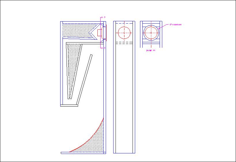

Yah, the Tang Bands have a little more spl, but seem a little ruffer at the top end than the CSS fr125's do. A bonus is the TB's are $35 cheaper than the fr125's. I have ordered the TB's today and will recieve them sometime tomarrow.
Mod boushhorn
Mine are going into a 9.25 x 6.25 x 7.25 dp 3/4" MDF 2.5 liter cabinet. Going virtually against the wall and the bass alignment looks better for this than FR-125.
I have an e-mail to Allen at T-B about vented vs. sealed. They look like they are to be vented but so close to the wall - what's the difference?
Also with the 8dB peak at 15-20kHz they apepar to be in break-up mode. Anyhow much better Qms than Fostex so I hope they won't have that bright edge Fostex are known for.
I ran my finger around the bamboo driver paper and I must say it is the most DEAD sound I have ever heard - a very good sign I think. I like the small Neo motor which allows better air flow behind the driver. Also cast frame is very nice.
Hopefully they will be forgiving enough and match well with "T" amp - my next project when time allows.

Mine will be going into Modded Bouchhorn MKII

T-B recommends:
"intended for thin or flat speaker box design"
Here is a 3.5 liter cabinet design from Aan at T-B:
c:\...\w4-1320sb vented box design.pdf
Unfortunately, I can't seem to copy the .pdf file Alan e-mailed me. Here is the best I can do:
File: w4-1320sb.bb6
w4-1320sb vented box design By Eagle Chang, TB-speaker
Ningbo China
+86-574-86553648
+86-574-86551617
Box Properties
--Description--
Name:
Type: Vented Box
Shape: Prism, square
--Box Parameters--
Vb = 3.558 liters
V(total) = 4 liters
Fb = 80 Hz
QL = 7
F3 = 97 Hz
Fill = normal
--Vents--
No. of Vents = 1
Vent shape = round
Vent ends = one flush
Dv = 38 mm
Lv = 111.9 mm
