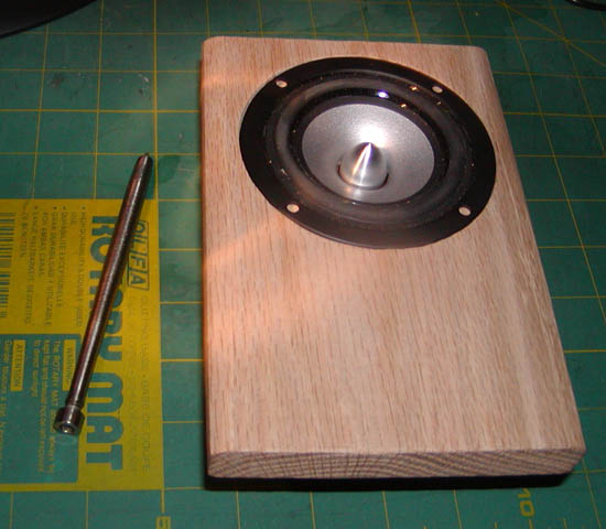

heres the baffle I worked on tonight.
looks like a simple bit of wood but its a bit of work making the flush mount and route curve on the inside (as mentioned by zaph)
it is very slightly offset (1/8 th) and the other speaker is mirror imaged.
