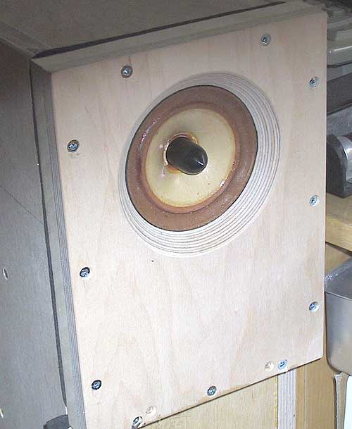

That's a neat way to blend the driver with the box, can you take the driver out if it needs replacing?

Yes, drivers look much neater when the flange and screws/bolts are concelaled!
That could be done by making the speaker as usual, then adding an extra panel on top of it. If you use screws and key slots, you can slide the extra panel over the front but be able to remove it to get at the driver if necessary. 😉
Won't there be vibration coupling if you do that?
Not f you out a bit of thin cork or similar at the back of the 'extra' panel.
And alternative is to mount the driver from the rear and have a removeable rear panel.

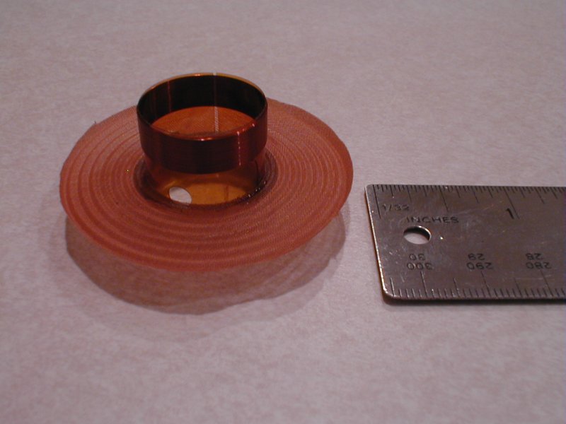

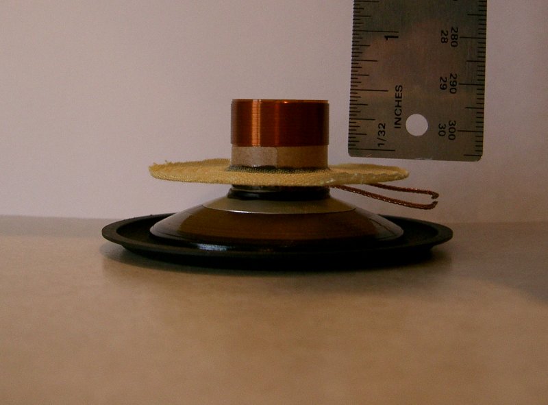

It's true. I've ripped one apart, and the voice coil is 7mm while the gap is 6mm. In this case, .5mm isn't as bad as it seems, because of the large gap height. The speaker may run out of Xmax fast, but it overloads slowly and gracefully because the tall gap has a high percentace of coil in it at any give time.
So while the Xmax is .5mm, you'll generally get 1.5mm one way before distortion starts to be audible.
richie00boy said:I see on your website that you sell the Tang Band's. What made you choose this model from the large range by Tang Band and is the 0.5mm Xmax quoted on your website correct? It seems uselessly low.
The B3S on the other hand, has a 9mm long voice coil and a relatively small 3mm gap. So it gets more Xmax for starters, but when distortion sets in, it comes on fast.
The B3S and 871 are a little closer in realistic output than their Xmax figures say, though the B3S still has effectively double the swept volume before distortion sets in.
These drivers took very different routes to voice coil and gap configurations. The 871's larger gap is what gives it a little more efficiency, though efficiency is less important than ultimate output potential with speakers of this low power handling. (unless you are using them for a midrange)

soongsc said:That's a neat way to blend the driver with the box, can you take the driver out if it needs replacing?
I haven't seen these speakers yet -- i believe the back comes off.
I do like the drivers mounted from behind.
dave
I do the same kind of mouting with mine, I can easily try other units or replace the existing ones if I put my finger through the cones.

The speaker posted by Dave is assembled from one of my kits. They feature all Baltic Birch ply construction, mitre(miter-usa) lock joints, removable back for access to the driver and the whole kit is build with fool-resistant assembly technique. Optionally, I will offer a second front baffle with mounting holes and binding posts to replace the rear baffle for bipole operation, extra rear baffles for those who want to try different alignments, ie. ported, aeperiodic...etc. And, most likely, I will offer a learning/experimenters kit with all alignment options and tweak suggestions so one can hear the effects each has on the overall sound.
As to driver mounting I use short #8 robertson screws from behind the baffle, but my most trusted technique is adhesive, specifically, silicone based. With the back removed the driver is very easy to access for tweaking, wiring...etc. and if removal is necessary (due to speaker damadge or whatever) they pull off relatively easily and the silicone cleans up with only slight effort. The baffle is 5/8" thick and the driver is mounted in a recess to bring the face even with the front of the baffle. The front and rear baffles are CNC machined.
