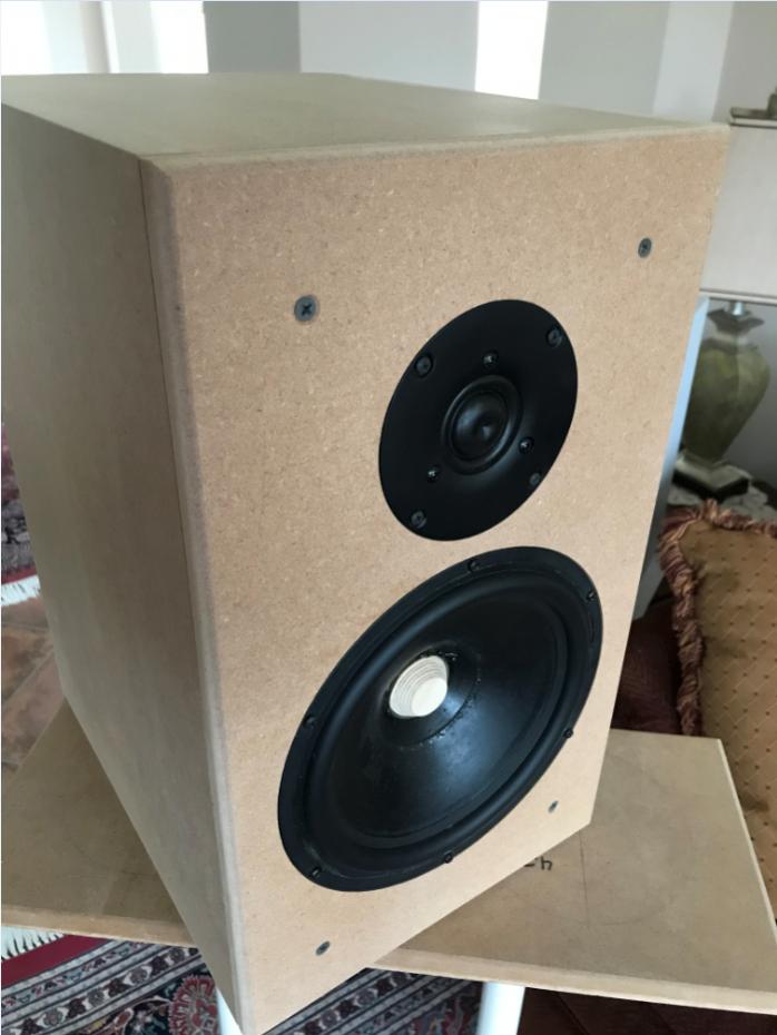

A new build with left over drivers and parts. I'm sure many folks would enjoy low cost build that sound great and play loud!
Started off as a rebuild of old boxes that was a DIY build from 20years ago, but the old boxes will full of nails/staples. Pitched that pair and started over.
The only salvaged parts are the PCV ports.

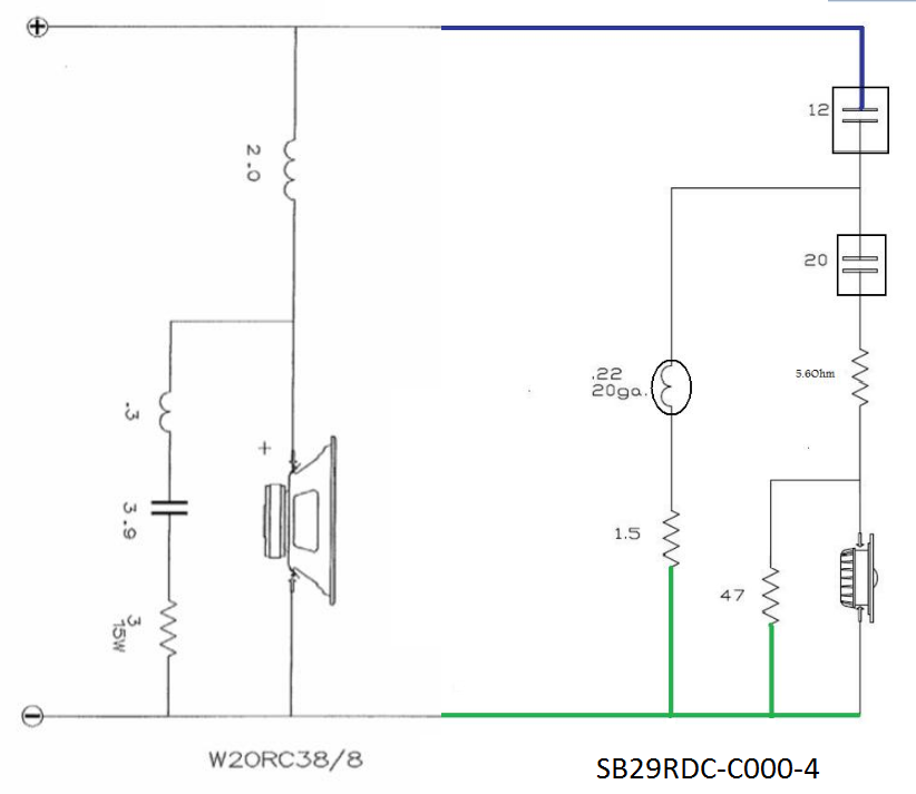

However, during the first attempt I did find a SF/Morel xo in Madisound's LEAP library.
The plan called out CAT-298 but I've been storing Morel MDT 28/30 since early 80s in hopes of project. Note that all the tweeter VCs do not have any ferrofluid left, evaporated I guess.

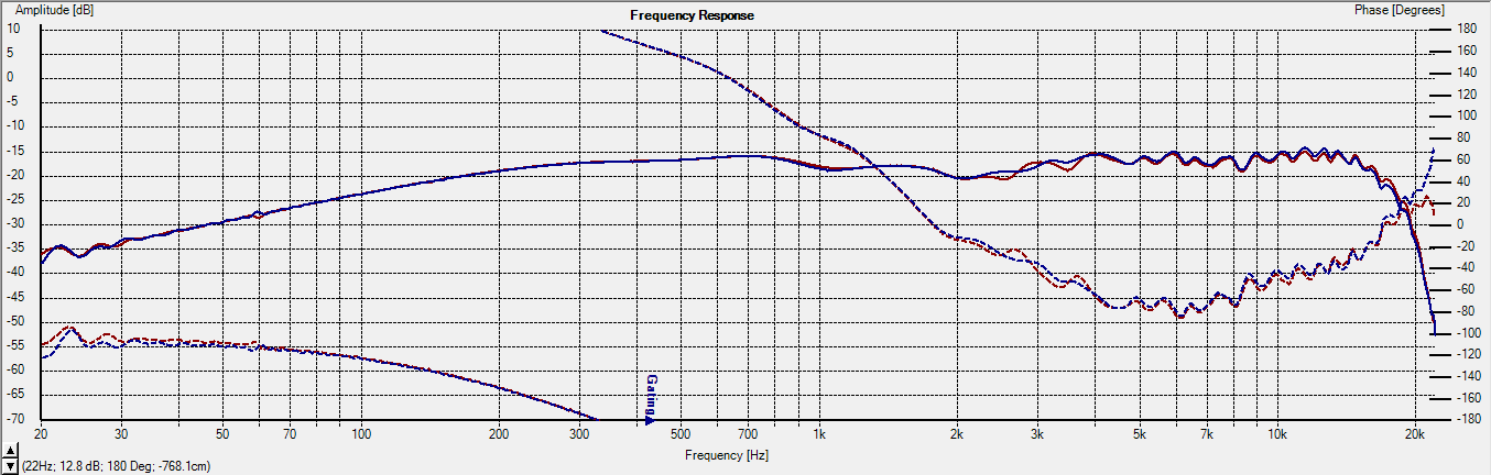

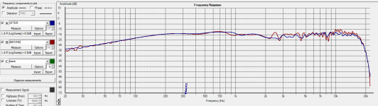

Ok then, built new boxes .75cf [net] fingers crossed I tried the old morels and was very happy with the measurements/results (3rd photo).
[the tweeter resistor was increased to 5.6ohm]
The woofers were on the shelf also, W20RC38/8, checked WinISD and used 2" PCV with router round-over bits. Fs tuning is in low 50s.
I also found that the 8" SF needs a 1lb of damping material and used the Blue Denim building insulation.
So far a no cost project, although I did order 900 units ferrofluid: guessing 4 5 drops should be enough for each tweeter.

Forgot to add the xo schematic, not sure how I even found it, it's over on Madisound's website - somewhere.

But I digress, I have been working on this since the wee hours of the morning, rebuilt one of the boxes with a few upgraded xo components and serviced the morel with the Ferrofluid.
A step in the right direction!

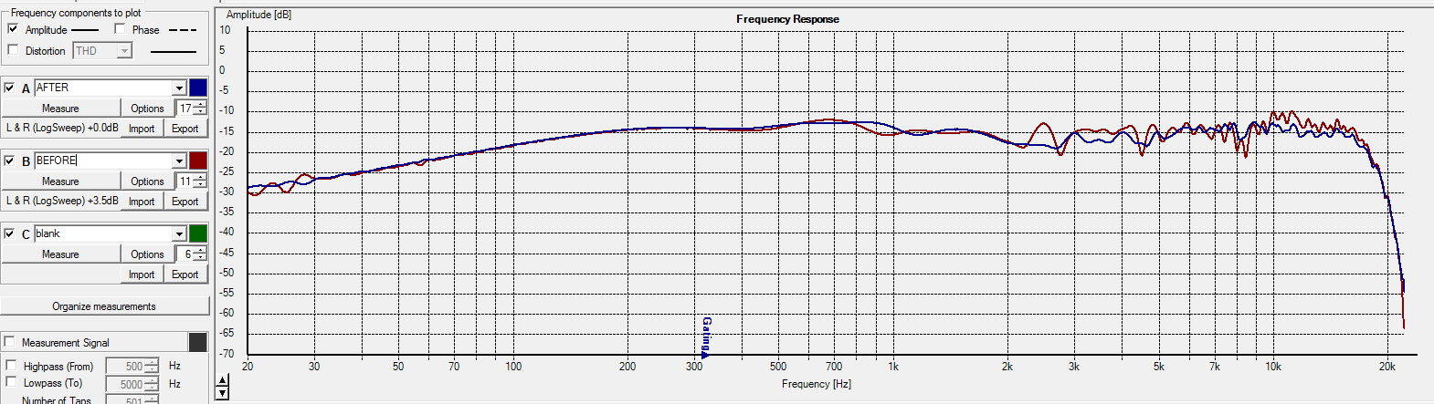

Sat down a couple of days ago and listened to three of my favorite CDs,,,bla changed my mind on the tweeter replacement. There is a impedance rise that is producing sour notes at certain frequencies. I bet the morel would work better with a simple cap xo. But chose them because they were the smallest and would be easy to swap out by enlarging the cutout.

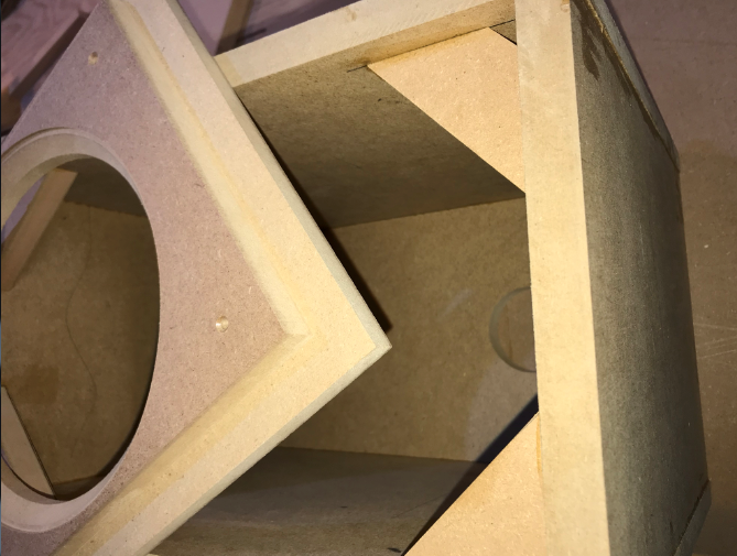

I did get hooked on the 8" SF in the 10" x 17" box, it sounds like 8" woofer in a 2.0 cubit foot box. With the heaver baffle step coil used only 1/2lb of the blue denim.
Well not ready to break them down yet, just made a new box similar to the old PE boxes with the removable fonts. They [PE] used to bevel-cut the rear of the baffle which helps seal the box, this does seam to work. Used a raised door cabinet cutter for the profile.
New xo, I'll start with this, two crossovers from other projects with similar drivers.

Well was side tracked a bit but assembled/tested the xo from the last post.
I think its fine and on the 1st attempt (lol after many, many other dud speaker projects)
Thinking the morels I have laying around are mismatched, but the xo was wrong anyway.

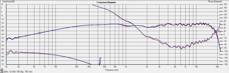

IIRC, Morel tweeters need some unsoldering to sort out any dried-up ferrofluid. Which just turns to sticky sludge after many years. Killing the output.
But I would be checking them for that if ancient.

Thanks for the morel tips and your design, never would have thought to do a complete over-haul, unsoldering and then cleaning. I'll have to make a board with cutouts and attach a few for testing, to check for a matching pair.
I remember back buying all these morels, most sounded clear as a whistle, whereas a small percentage had a secondary tone/buzz. Never did figure that out.
[Replacement VC's are available for $27]

Another marathon day yesterday, complete overhaul of the gray-primer mdf boxes: replaced the tweeters, added bracing, retrofitted the xo's and tested.
The 8" woofer is musical and has wonderful bass (with the PE P-core baffle step coil). Used a 6.8ohm resistor for the tweeter.
Both speakers here:
