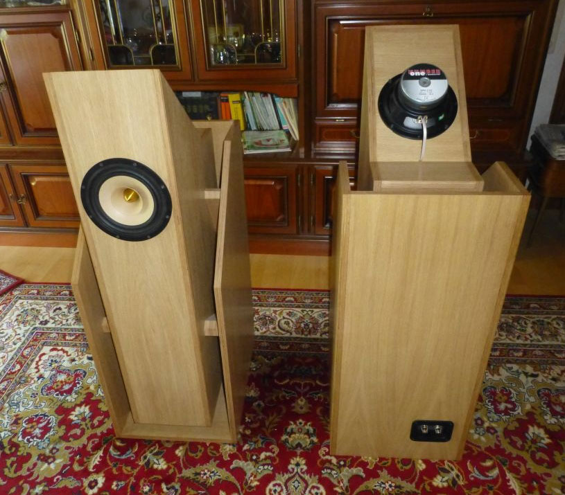

i would prefer a sub sat solution like my HORN Sat+ 2 ALPHORN, direkt and the bass you can take to your taste and room + distanz, the fostex can go active 12 dB~120 Hz, much more SPL as solo.
Or my RDH20 with a FR 8" in front with more than 2mm stroke, Seas RCZ 22, TB 1772 etc.
back invers pol changed Monacor SPH210. near the wall much better soundstage by the back driver, impedanz for Tube amps better than a single driver solution.

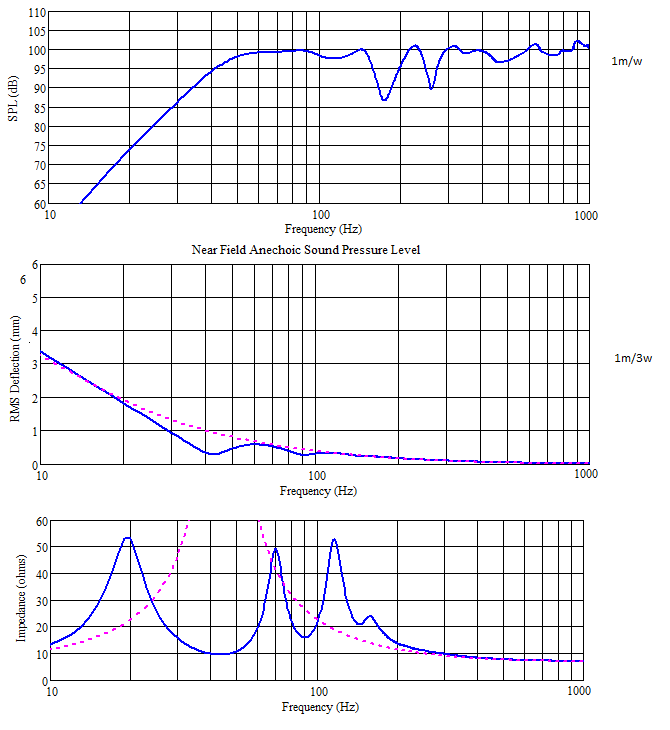

Scottmoose, thanks for posting the simulated frequency response curve - I am probably asking a dumb question, but what causes the dips in the response at ~170 and ~230 Hz?
That are either reflections within the horn or cancellations caused from the phase differences of the horn and the driver. You can even it out with placing damping material at different places within the horn or the back chamber but before doing that, you'd have to measure/listen if it's really the case. Most horn simulations look worse at first.
thanks, for the simulation, where i see the membran movement, please show us,
my tests show me by a solution with 1mm stroke you will not get enough bass by an indirect horn by such a large room.

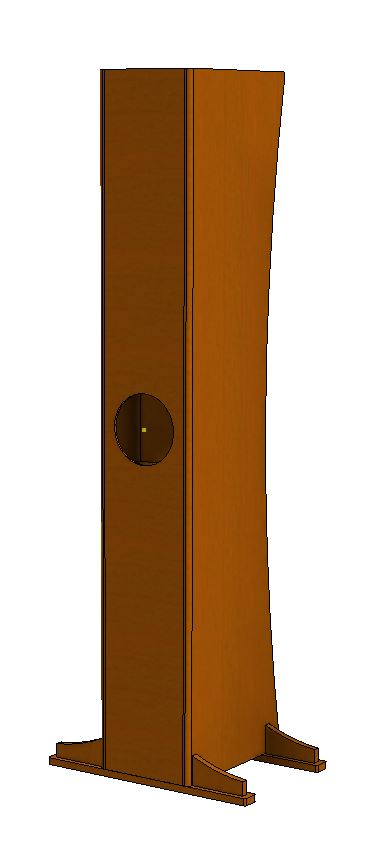

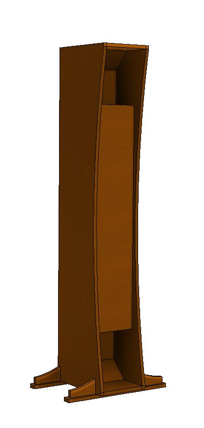

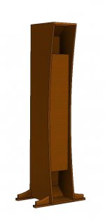

Received the drawings today! Thanks for the quick turnaround Scott! I am working up some details for the base supports (I have children so wide, solid supports are a must). If I can execute the construction well, I think these are going to be a really nice looking set of speakers.🙂
csample,
Maybe also good to plan a set of grills? Inquisitive minds might enjoy poking at cones... 🙂
Yes, they should turn out impressive. Keep us posted on the progress.
