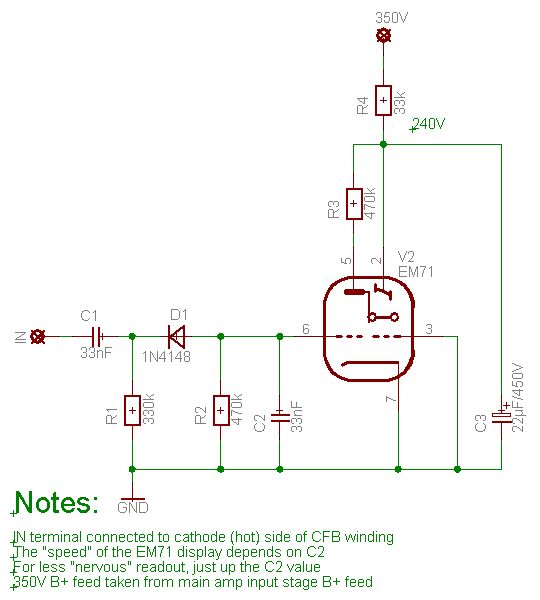

Thank you for showing my circuit without notice 😉
It should be noted that the EM71 tube used there - different to many other indicator tubes - has a somewhat special degressive characteristic that nicely matches the voltage/power function.
Tom Schlangen
