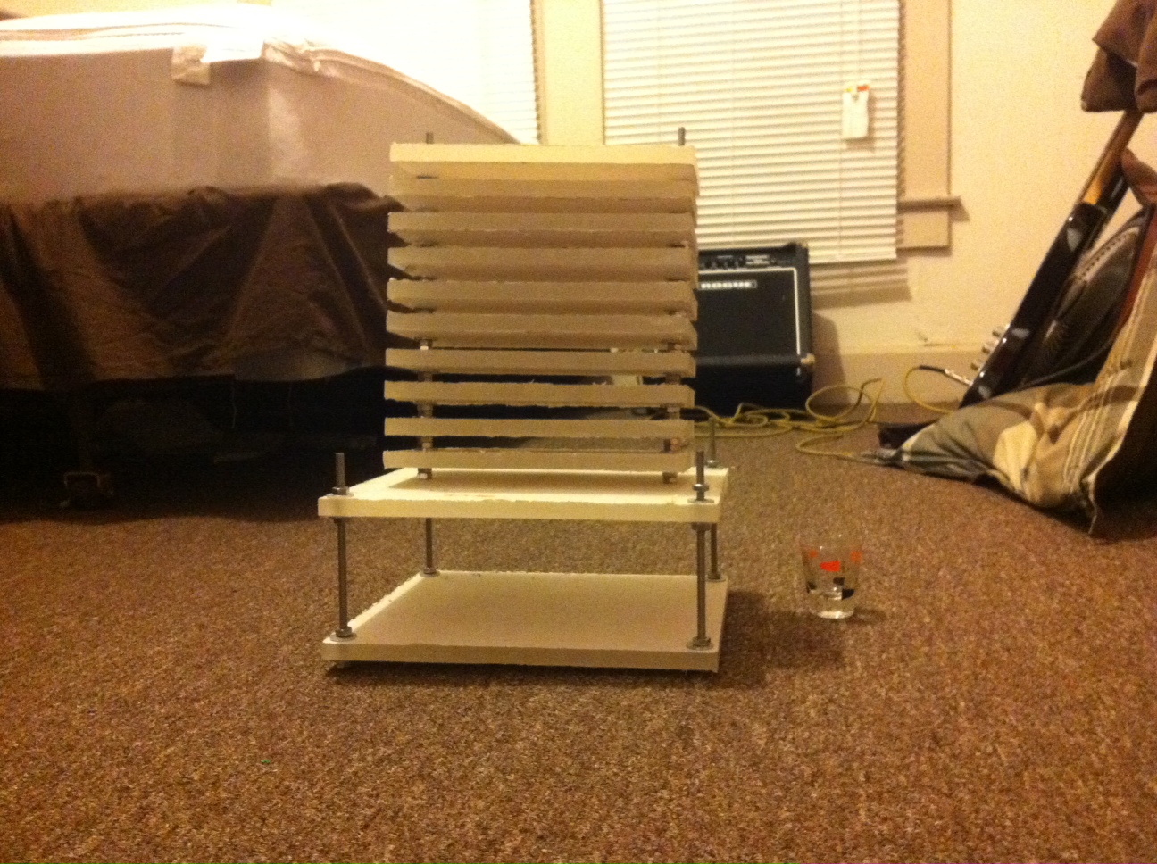

I have the tower it self built already and it can be viewed in the attachment. The design is based off this vid:
LED VU Meter - YouTube
I was wondering what are all the components I need to fit it with. I heard about the LM3916 circuit but dont understand how to apply it to a tower. I also heard that arduinos are good to use and am willing to program.
All in all I was looking for someone more experienced then myself to give me a play by play on everything I would need to buy to make this come to formation.

experience: I can do basic breadboard work. i can soder for example if i could modify some prebuilt board. I know how to program an arduino. I can solve for voltages and currents and resistance according to my B+ in circuits class :cool:.
Budget: 80$ ish
Ten columns, with one pretty bright led each to disperse throughout the frosted
12 inch by 4 inch plexiglass
LED brightness: Not sure how how the lumen unit scales in regards to brightness when purchasing without seeing them in person.
AC current

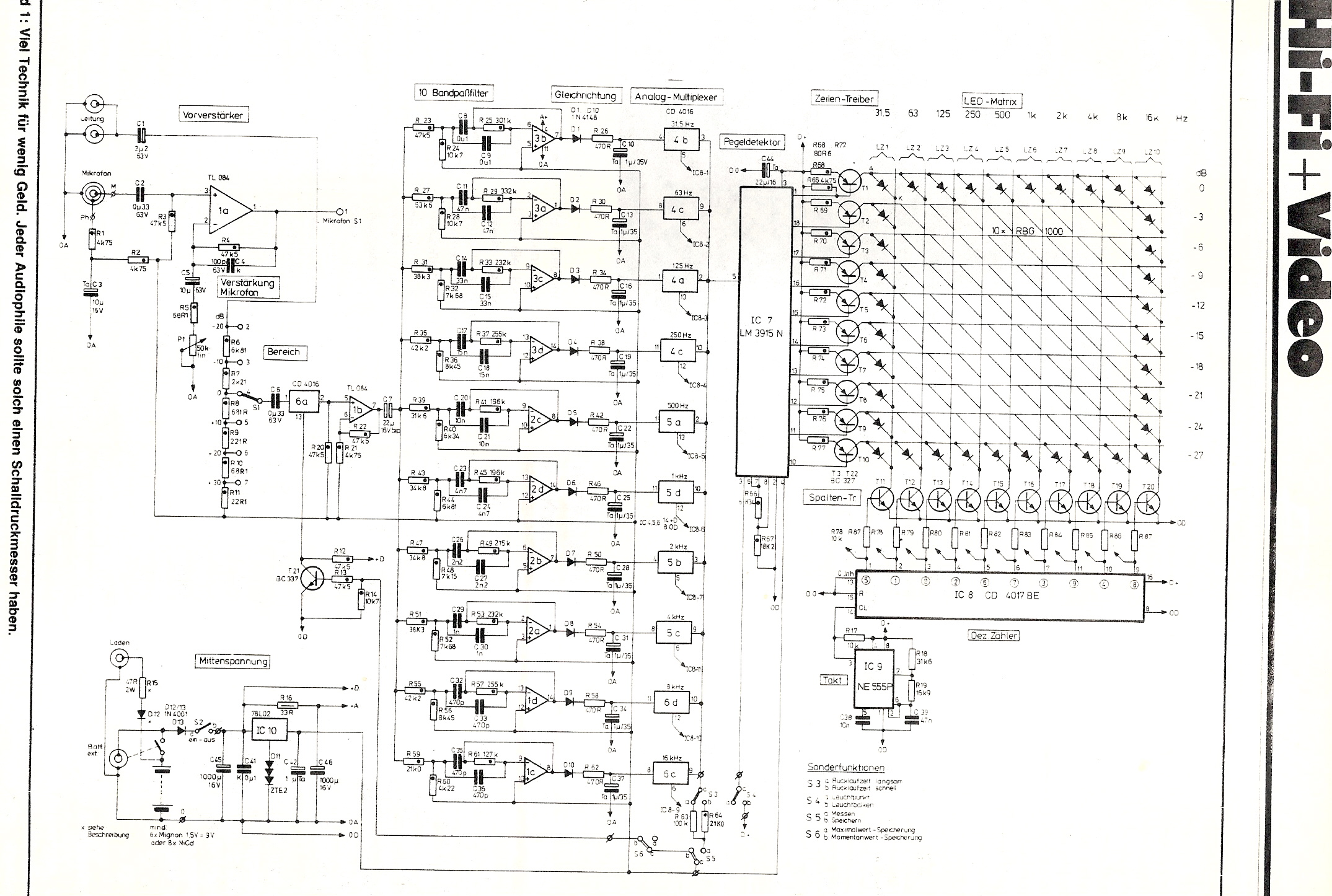

Here is a circuit from an old German mag that should do the trick. The beauty is that you can add LEDs(for brightness) as each row/column is driven be a transistor. Seeing that you have a guitar in the pix you may want to adjust the frequency bands to the output of that instruments (no need to have 31 or 16kHz displays) E
