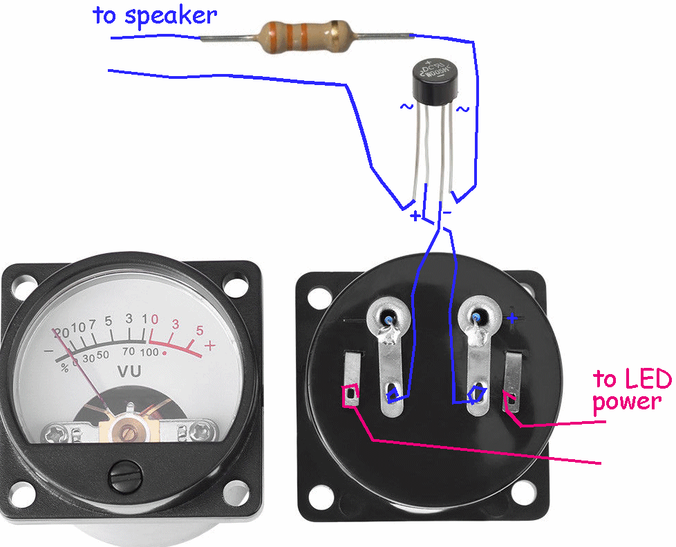

I've built an amp across an Anaview AMS 1000 module a few months ago, and now i'm planning to add a vu meter kit like this one: 2x Panel VU Meter 500UA Warm Back Light Recording&Audio Level Amp w/Driver Board 898149527904 | eBay
The intention was to connect it in parallel to the inputs but... from what i see the board has a three-pin input, L+, R+ and a common GND. Since i'm running my amp in balanced mode, i'm wondering if there's a way to drive those meters without shorting the two cold poles.
I would build a little difference amplifier on a piece of prototype board.

As you say, the "kit" probably expects an unbalanced input, but you plan balanced input. On the other hand, a 500 WATT amplifier can *easily* drive a meter, even an insensitive low-cost 1mA meter. Even with high-drop Silicon rectifier. AND the raw meter is full-floating, avoids all concern about balanced or unbalanced.
You need a series resistor. I am guessing a 1mA meter and 31.6V amplifier output, so about 33K. Power past clipping may exceed 0.030W; a 1/8W part is ample.
You need a rectifier. For little 1V line-level signals the 0.6V drop of a cheap generic Silicon diode is embarrassing. At 31V, not so much. This is a 20dB (or perhaps 25dB) scale. It won't twitch below 3V. The 1.2V drop of a $1 FWB is a teensy error at the lowest levels you can hope to read. (The cheap meter's own errors will be worse.)
IMHO, this is eye-candy at most. Anyway there is little point in "measuring" speech/music signals-- they jump all over. To know "clipping" you need a Peak Detector, a more complicated circuit. And in context of a 500 Watt amplifier, a 20+dB range does NOT cover many "reasonable" listening levels. (I recall a fine dining establishment with a 200W amp with 40dB meters, they seated us next to that amp, and the meters twitched about a dozen times the whole meal. As some guy says, most listening is "First Watt".)
